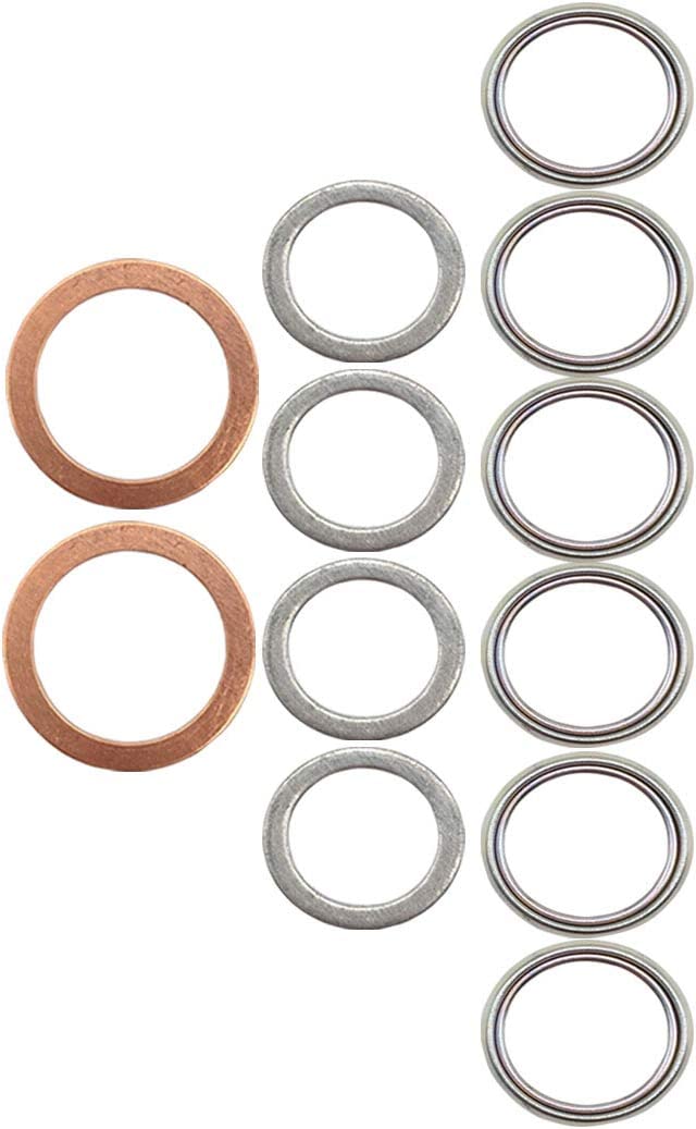

NO crush rings are involved in any Toyota TAPER male threads i have ever seen or know of ............
ONLY toyota Straight threads like service plugs have crush rings / gaskets to be clear
do you follow the TECH with what in saying here ?
if not i can try to better explain
matt
Got it. 👍
one more tech tip then its off to the LAB to pack up more orders
ALWAYS ALWAYS 100% solid
: any STEEL or cast IRON Gear Box or AXLE gets a steel crush ring gasket
- ANY alloy , aluminum , or NON magnetic one GET a ALUMINNUM crush ring or gasket
and BRASS or BRONZE one gets ONLY a same in kind BRASS crush ring or gasket
print this 411 out and tape to tool box in shop inside lid for Quickie jack flash reference ..........
