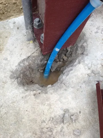

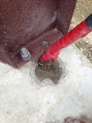

This may rank high on the list of all time stupid chit I've seen degreed CMs do.
22' tall columns on an 80' span.
Have (4) of these.
Ok, I'm at a loss... What they fook did they think they were trying to accomplish?
I'm also at a loss as to how they accomplished what they did. I'd say they jackhammered the holes, but the conduit/plumbing/whatever is under the pour? Did they form around it with sand? I'm totally lost.
Holy cow! What sort of uplift and wind load reduction is now a reality with those base plates...?
I understand it is prohibitively expensive to 'tornado-proof' a building, but, given the tragic events around your area, a 'degreed Construction Manager' betta have stout risk management cojones!!
A known area for these powerful storms would encourage me to shie away from value engineered and suspect 'code minimum' performance... document your photos and any conversations regarding your concerns with the 'higher authority' Building officials, Const. mgr. et cetera. CYA!!
They ran the water lines up directly where the J-bolts should've been (in a line directly under all the sidewall columns. Pretty sure I heard hissing when we were drilling for the epoxies, so the water line is already compromised. GC knows it, and said he'd "worry about it later") so they jack hammered out and "relocated" the water line, leaving no means to run another bolt into the pier, plus the concrete was crumbling below the column once secured.
Hit two post tension cables when they were jack hammering, both already stressed. Couldn't believe it, but doubt the flunkies they sent out had any clue to the danger of a stressed cable.
Never seen the separation on a post tension floor, like this one, either.......but we were instructed to put an 18,000lb lift on it two days after it was poured.
What pisses me off is this is a reputable outfit, if reputation is dictated by the amount of jobsite signs spread across the metro area.
I've not seen this level of comprise being acceptable on any job I've worked on, even dealing with the DIY general contractors that read a book about commercial construction two weeks before pulling a permit.

Your guess is as good as mine on reduced capacity.
For the most part, kick out it of greater concern at base plate connections, or an important one.
The three anchors securing the balance at 7/8"x26" embedded epoxies with more inherent strength than an equivalent bent anchor, but the third party engineer that signs off on our work when I'm responsible for doing so would require a 12" flange welded to the base plate with (8) more equivalent anchors before he'd pass.

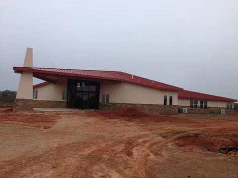

BTW, the panels in your picture that do not line up at the peak look horrible.....
just sayin'
I appreciate your opinion. You must've skipped over the four hundred word dissertation explaining "why" and my full agreement with you. It's not a peak but a hip, BTW.
I'm not making excuses, but it's a design error, but honestly, there's no visible angle from the ground that any two opposing planes are simultaneously visible at the hips, so only we'll know.
