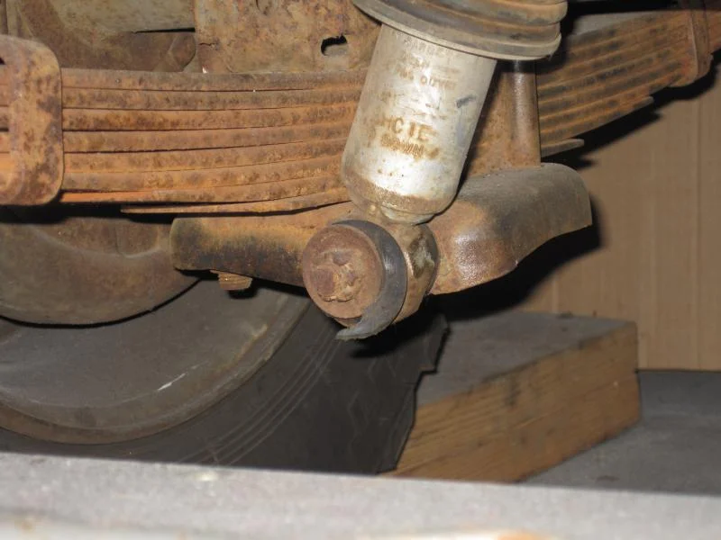

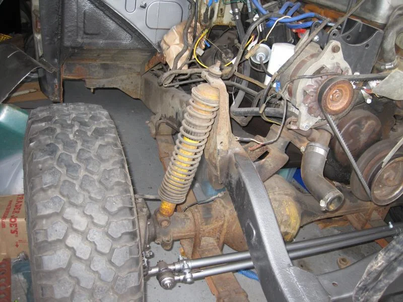

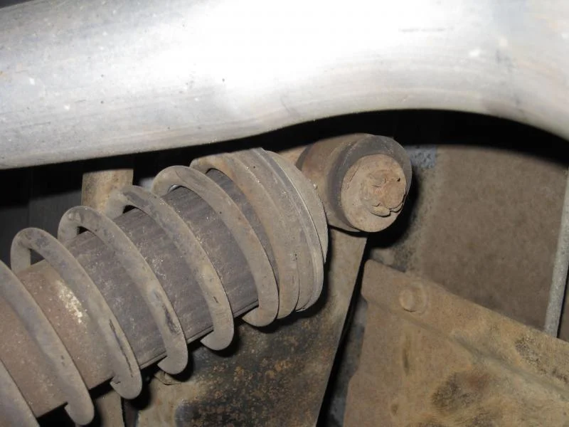

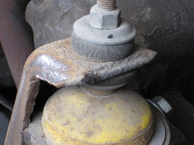

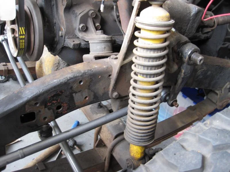

Howdy all. Front end is now torn off as I try and get to the base layer to work my way back. With the inner and outer fenders both off, I'm wondering if now is the time to deal with the suspension issues I'm thinking I have.

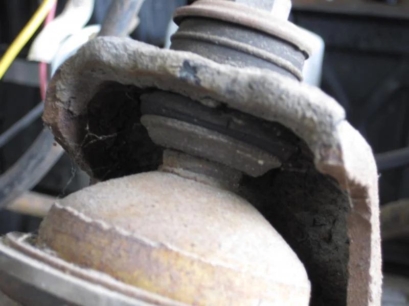

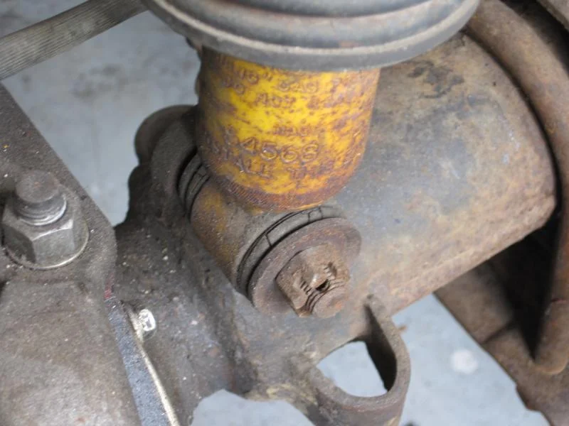

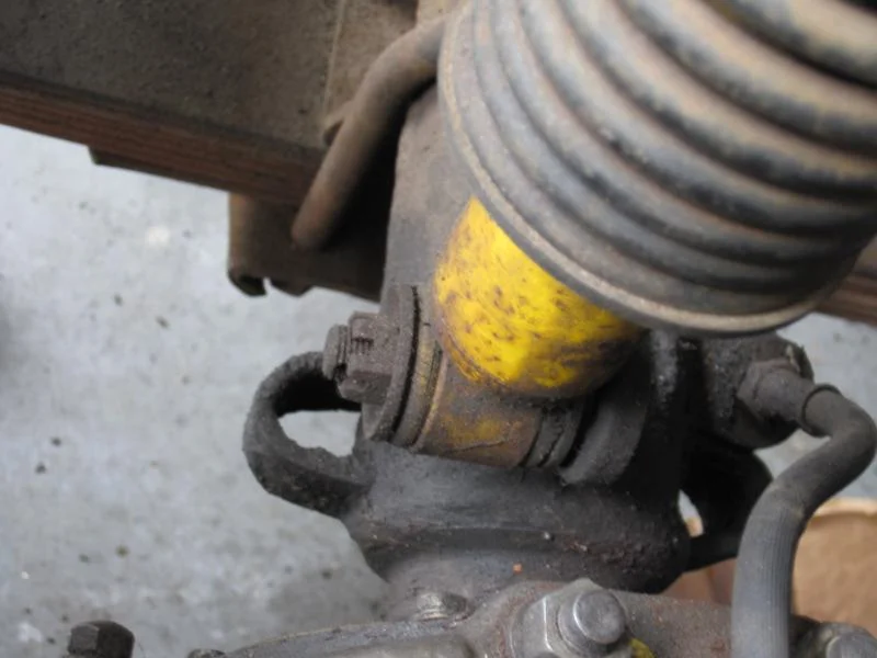

Here are some photos. I'm certain the bushings on the mounts are toast, and I'm thinking the pistons and springs are probably needing to be dealt with too.
However...as I am no where near an expert on this rig yet...I'd love some feedback on what y'all see here.

Bushings and shocks are not as bad to change as you may think. They're fairly easy, just take time and the proper precautions. There are 24 spring bushings front and rear. You need to know if you have stock springs or aftermarket, this will make a difference on which bushing size you get. Irecently purchased doetsch tech shocks and a steering damper for 270 shipped to my door, including sales tax. I thought it was an alright deal. The bushings can be bought at cruiser outfitters or specter, maf has a limited selection of sizes. Bushings are about 2.50 a piece. You might consider getting new spring pins and shackle pins- the hardware is usually crusty and rusty. I'd say a guy should be able to get the front and rear done in a w/e including some time for honey-dos and a test drive. If you have never removed a leaf spring, you should do more research first to cover basic safety and process.
What are the suspension issues you are having???
trust me, lose the coil-over shocks
and LAMBCRUSHER speaks the truth about safety when removing leaf springs

I'm pretty familiar with suspension work, extracting/replacing bushings, etc. I don't know if there's anything wrong with the coilovers, but it's pretty obvious the bushings need replacement. If I have to tear it apart to deal with those, might as well replace the shocks if need be since it's all there.
That said...no coilovers huh? I've always had coilovers in my sports-cars, but these came on the rig and I am in no way tied to them. What I'm looking for in the suspension is not rock-crawling capability, but the ability to do the 4-wheeling necessary for driving to Mt Hood Meadows, Bachelor, etc. Otherwise, it's going to be a family hauler for long-distance (for us 3-4 hours) drives on the highway 85% of the time. So swapping those puppies out for something that'll make this swine ride like a Caddy is good with me:) I'm sure that will irk the rock-crawling crowd, or the 'restoration' crowd, but I like me some comfy:)

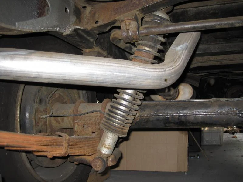

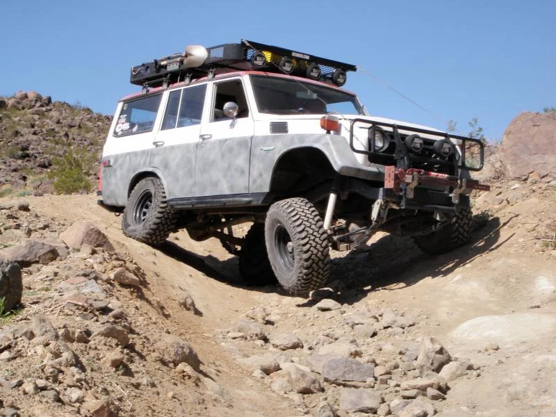

I had coil-overs on the rear of my pig with MAF safari springs (no longer available) I ordered the shocks about 2" longer than normal static ride height to help keep her even when it was loaded. We tend to do some MULTI-day expedition trips, and have put some serious weght in her.
Now I'm running 5" lift Alcan's. I ordered them 500 lbs (IIRC) over stock in the rear, and 250 lbs over in the front. Also runnin' Doetsch Tech shocks. The ride is great, and the springs work beautifully so far.
Hey bogus...does it make you uncomfortable is I say 'nice rack'? Love that setup!

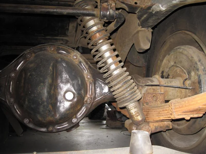

That is some serious suspension travel you have going on there. Can you tell from the photos I posted, what is on my rig and what I can/can't do with this setup? I'm having trouble determining what these coilovers are, when they went in, etc. The PO has no idea as they came with the rig when he bought it from the original owner. Thanks for the feedback and awesome photos by the way!

Looks to me like those are run of the mill Gabriel shocks. That's what my old ones were. Your springs look like stockers. Do you have an "ultimate" gameplan as to what you want to do with the rig? If not, I would just put some add-a-leafs and good shocks on it for now, get it on the trail, and see how you like it. Don't dump a bunch of time and money until you spend more time learniong what the rig can and can't do, what you want it to do, etc.
