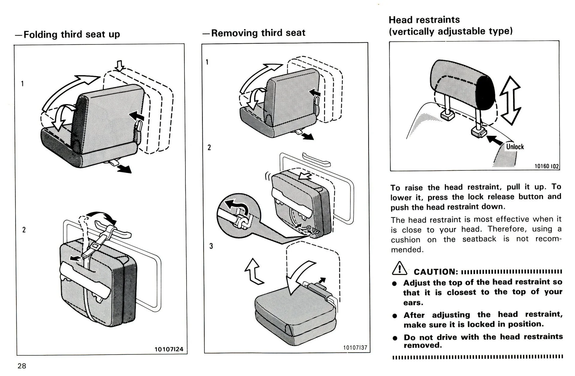

Third row seat removal
After you complete step #2, there is a small lever on the outboard mounting bar that needs to be pulled up. this releases the seat to slide forward as the arrow shows in step #3 and then the seat lifts up and out.
