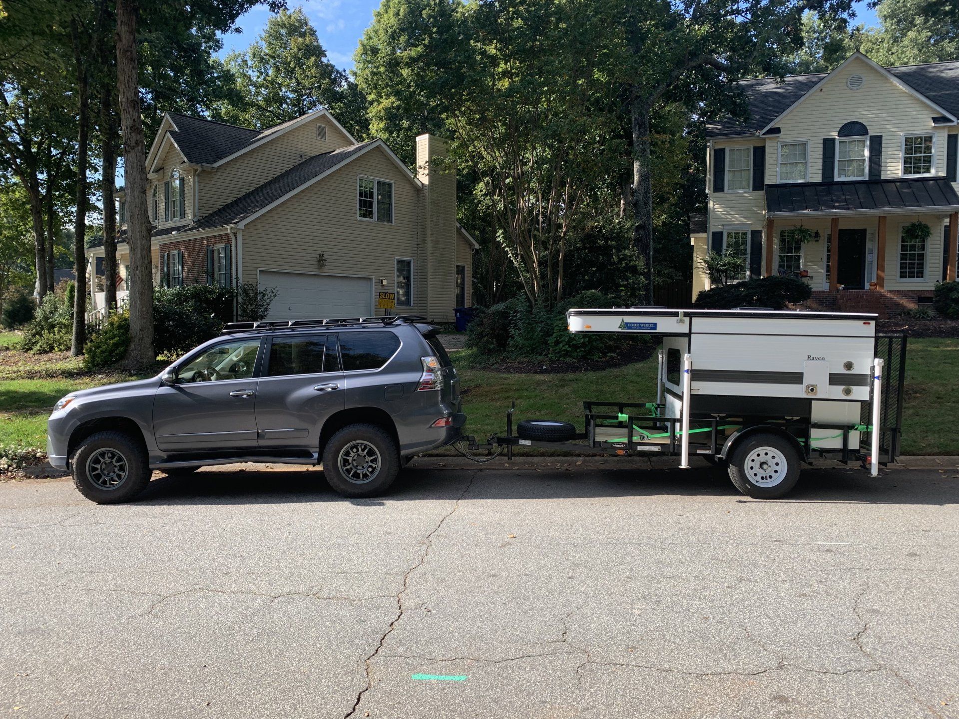

I towed with my 2011 for a number of years. Never pushed its 6500 lbs limit, just mostly our event trailer going to events around the country. 16' single axle aluminum box trailer, about 3,000lbs all in. I found the 4.6 did fine overall and would never hesitate using it to tow a medium tow need with. With the truck being fully built including an ICON Stage 6 suspension, I very much appreciated the KDSS system. Normally a built truck on 34"s can be a bit spongy in the corners or be pushed around by side winds hitting the trailer. The KDSS takes over and keeps the truck rather tame, when others would get sporty. Like all modern Toyotas as soon as you plug a trailer in, I swear its like the computer goes "oh we are towing so who cares about the MPG." Mileage drops.
