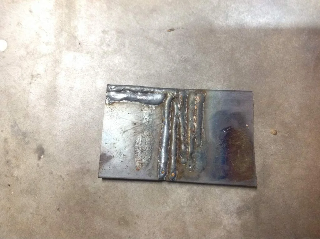

Nice score, but what's with that nozzle? Looks like the contact tip is sticking out 3/4 of an inch past the nozzle? Won't get good gas coverage like that - if you can adjust it, see if you can get it to within about 1/8" of the end of the nozzle.
I don't have shielding gas yet so I'm using flux core.

Many people like the look of that "stepped weld" but the truth behind it is that between each of those spots where you stop to build a dime, is a quick pass without full penetration.
Second pic looks like very good heat and consistent travel speed, nice even bead! :clap:
