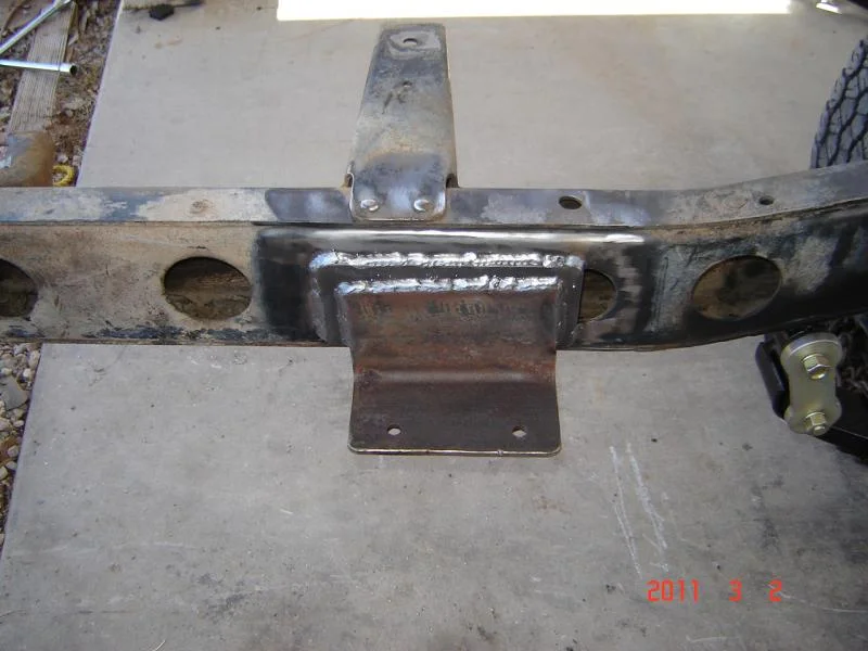

These next 2 images show the transmission cross member and the bracket used to attach it to the frame. The crossmember itself is from a pre '85 FJ60 and the transmission is from a 1987 FJ60.
