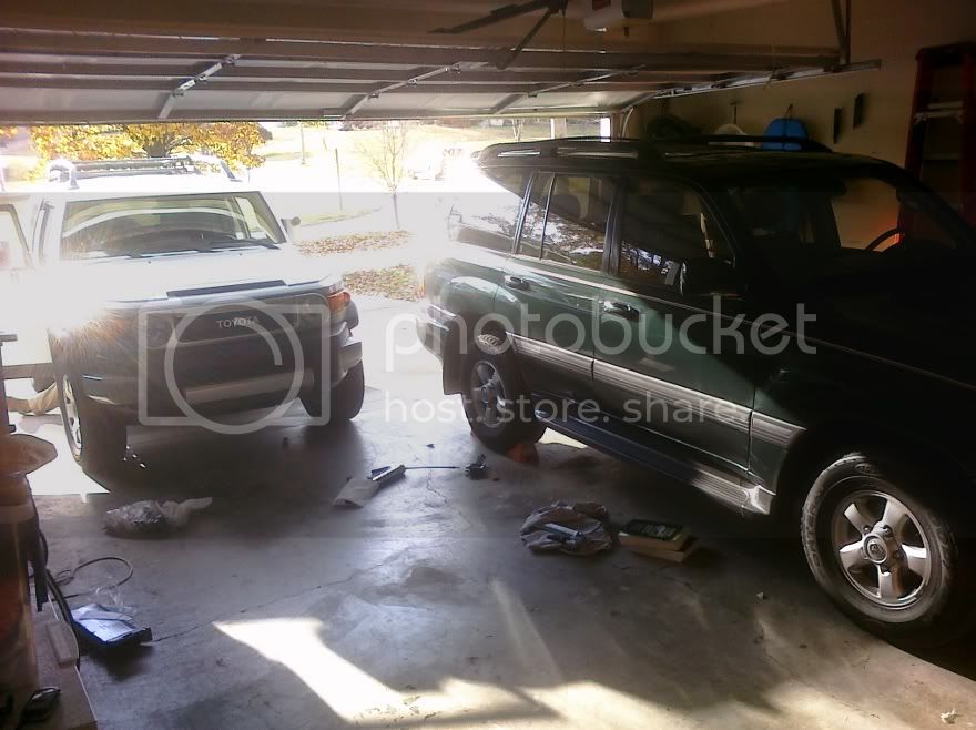

Put about 1/3 tube of moly in the rear slider today. None pushed past the seal, but the clunk is definitely gone again. Turns out a good friend of mine is slender enough to shimmy right under and grease it without a jack. In exchange I found I can pretty much fit under his FJ. Picked up a second grease gun so I can have moly in one and lithium in the other. Surprisingly similar underneath. I took a shot of the work in progress... Looking forward to driving around in my clunk-free Cruiser!
