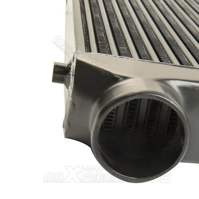

I quite like this one, but it's painted.
New Front Mount Intercooler Tube & Fin Design 600*300*76mm 3.0inch In/outlet | eBay
The core in this is quite open vs the typical WWWWW style internal fin layout. This means its less restrictive due to less surface tension/friction, and less pressure drop across the core. Intake air will pass through the core more quickly/more easily.
It has little turbulator fins inside the core to keep a good internal surface area, so it should dissipate heat well.
Being painted reduces the efficiency of heat exchange from the core to external air
If this was available unpainted and with 2.5" in/outlets, I'd be on it like stoopid on Trump

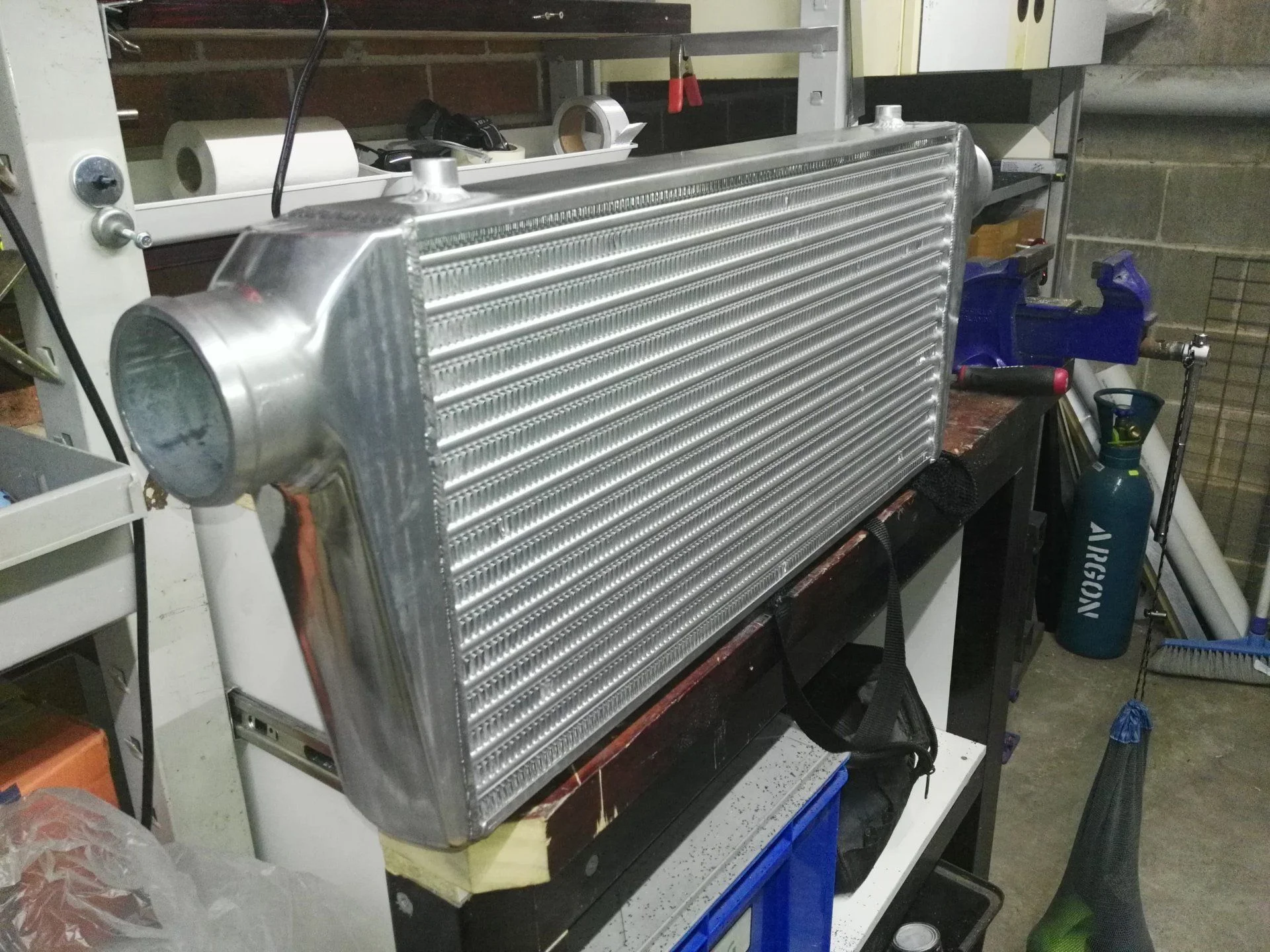

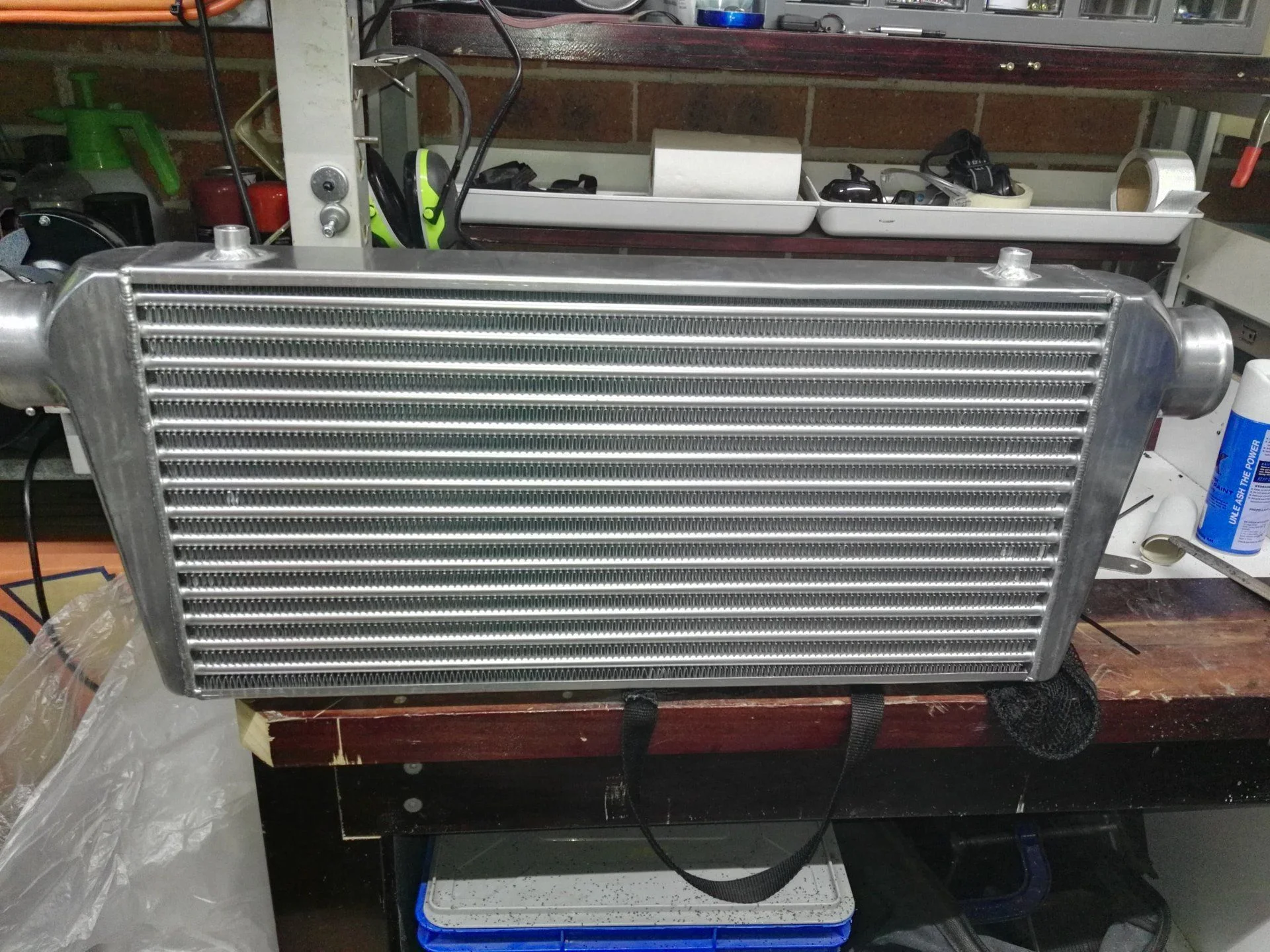

I ended up ordering a tube and fin FMIC core. $150AUD to my door (in Aus)
600x300x75 core, 3" in/out
Brand is "maxpeedingrods"
Cheeky buggers dropped the price since I bought one
Front Mount Intercooler 600x300x76mm tube & fin 3.0 inch In/outlet 76mm 6971362688486 | eBay
Very happy with the quality. Welds are consistent and neat, internally very nicely put together, end tanks are a good shape. I would have preferred 2.5" inlet/outlet, but hey, it's ticked a lot of boxes.
It has a fairly open core design (good for low laminar flow restriction)
Has turbulator fins in the cores to increase surface area in the core to shed heat better

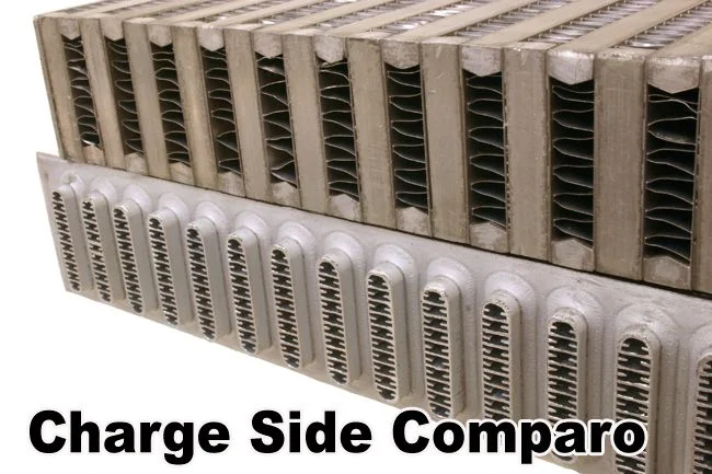

Here's a few semi-random pics from the web

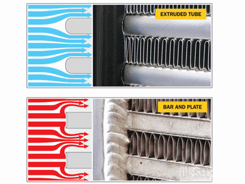

This drawing suggests air flow through the front of the core is smoother with tube and fin vs bar and plate.
Mine has nicely rounded leading edges on the tubes.

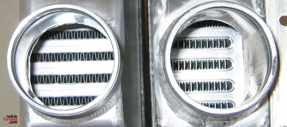

Bar and plate top, tube and fin bottom.
Bar and plate literally is made up of bars to close off the edges of each section of the core (clearly visible above) and "plates" being the finned sections made up of the folded fins sandwiched between two plates.

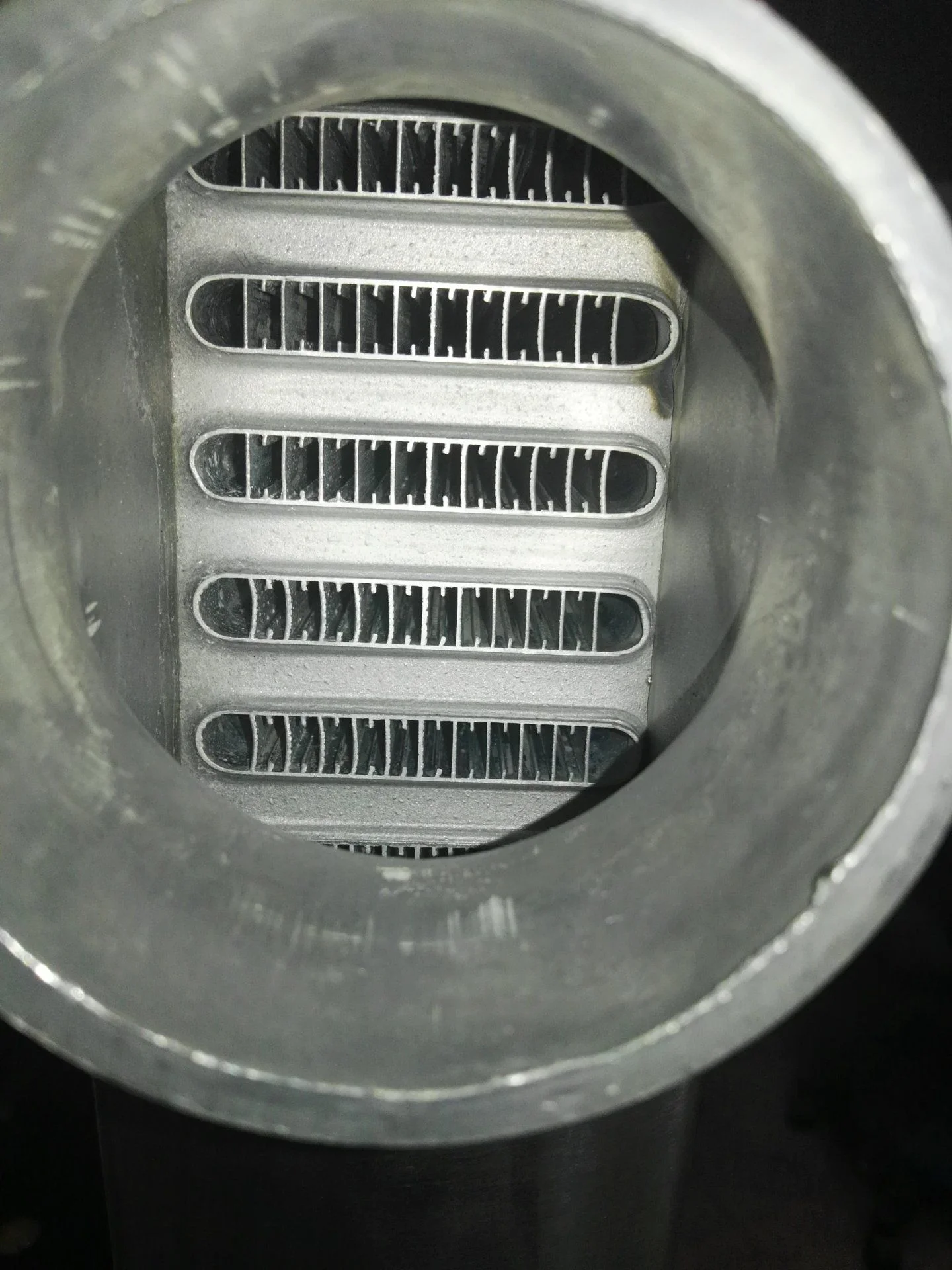

Tube and fin use extruded tubes, the fins are a part of the tube.

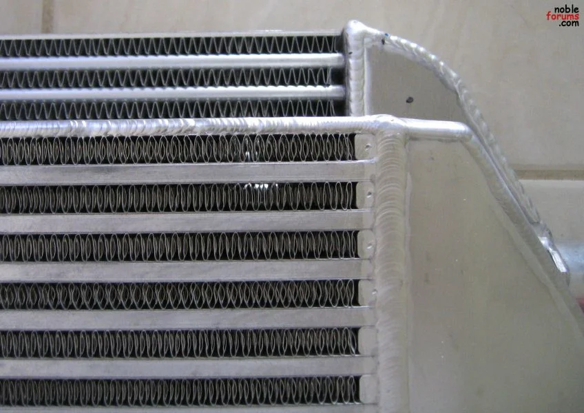

Bar and plate left vs tube and fin right
Tube and fin has wider galleries between the fins, less fins. This means less surface tension, less friction for the air passing through. It's less restrictive.
Trade off is there's less surface area inside, so questionably less heat transfer from charge air, to cooling air. But I think this is not clear cut.
Front view, tube and fin to, vs bar and plate bottom.
Bar and plate has wide flat plates in between charge air galleries. Less efficient cooling air flow through the core.

Everything is a trade off. To my thinking, tube and fin has a more open, less restrictive charge air flow through the core. Air dwells less time in the core, maybe less heat transfer, but fins are an integral part of the tube, so better heat transfer. Turbulators (little fins in the tube) help with heat transfer, but cause less surface tension vs complete fins.
Tube and fin provides smoother, more efficient flow of cooling air across the core, so this gives better transfer of heat out of the tubes.
