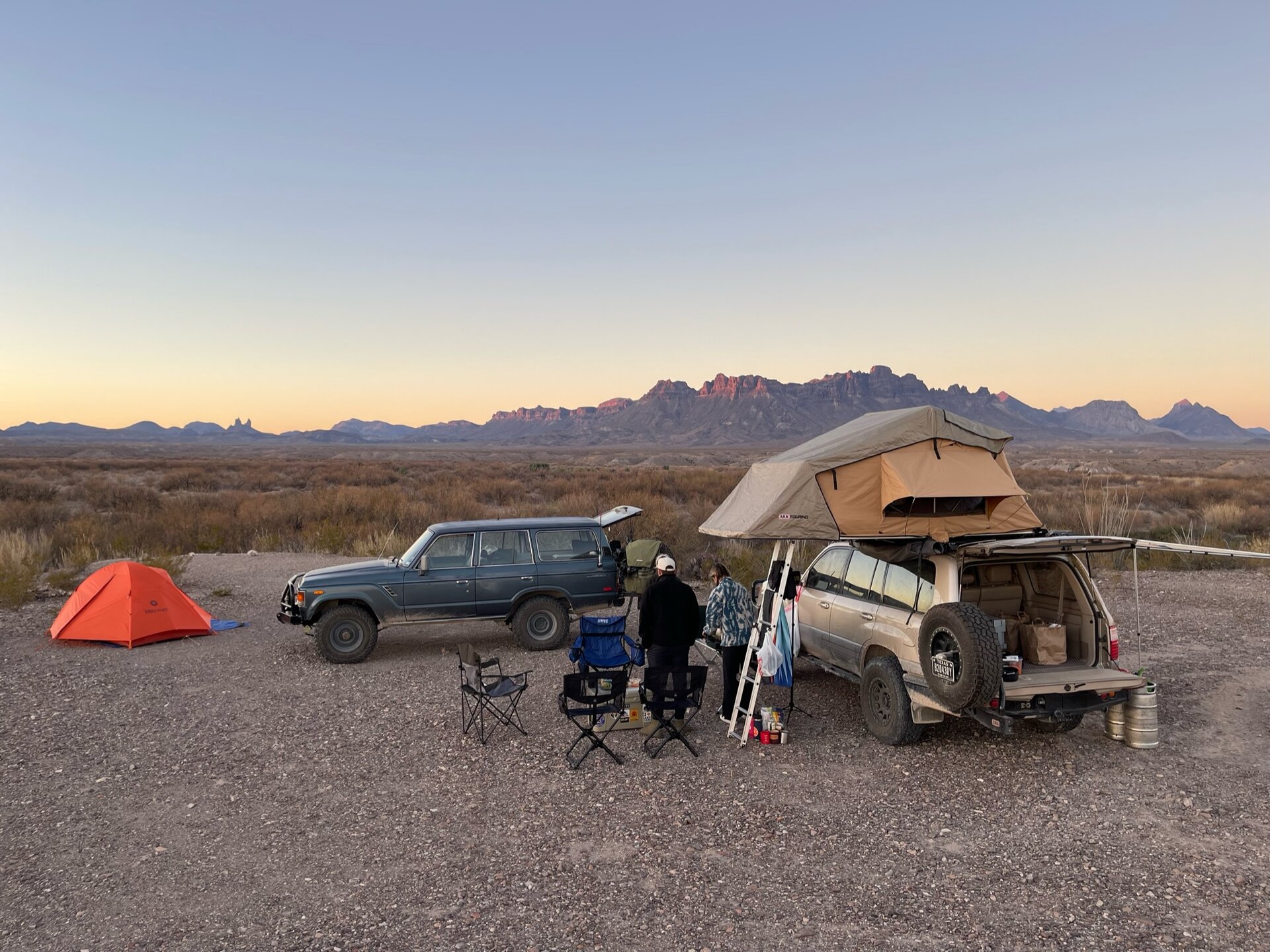

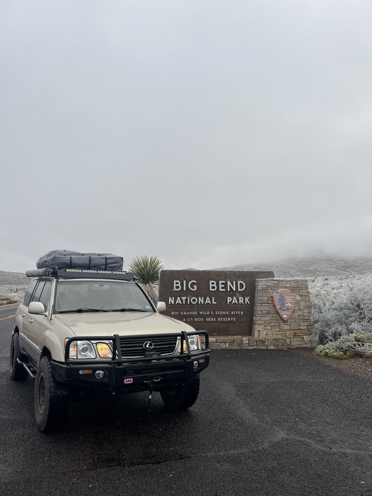

A few pics from a shakeout trip to Big Bend National Park after replacing 80% of the front end and adding some other goodies.
Am I seeing things or do your travel with kegs??
Those are indeed two 1/4 bbl kegs.
I wanted ~15 gallons running water for showers, dishes, etc. but didn't want to wire up a pump as I have no space under the hood (ARB dual compressor and second battery) and no space under the truck for a tank (LRA aux tank) . I decided to use my ARB dual compressor with LINX to pressurize a water system, much like the Road Shower, but for 30% of the price. Against my better judgement, I initially tried using a rectangular aluminum fuel tank from Amazon. The tank worked but was no longer rectangular after testing at 15 psi. The next best option were a couple kegs as they are cheap, readily available, and multi-purpose pressure vessels ;).
I can hold a little over 7.5 gallons per keg. The keg opening faces upward when stowed, so I don't have to worry about leaks. I installed a blowoff valve set at 40 psi (2/3 max pressure) so the keg wont blow in case somebody sets the compressor too high. All in all a good system if you want to use compressed air, but much like our cruisers, it's a little heavy (each full keg weighs 80 lbs.), and not as space efficient as a cube. I hope to fabricate a bracket and mount them to a second tire swingout.
