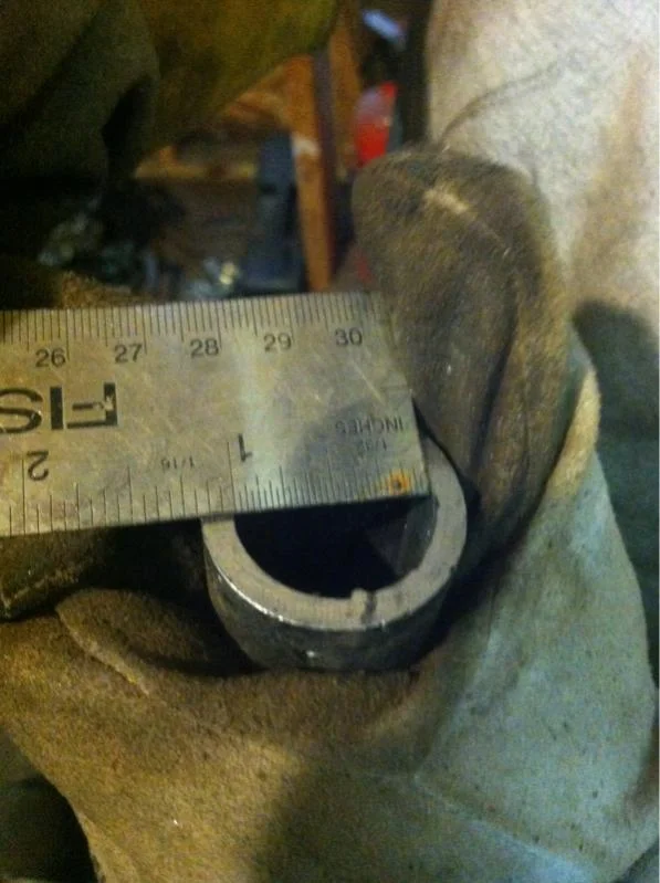

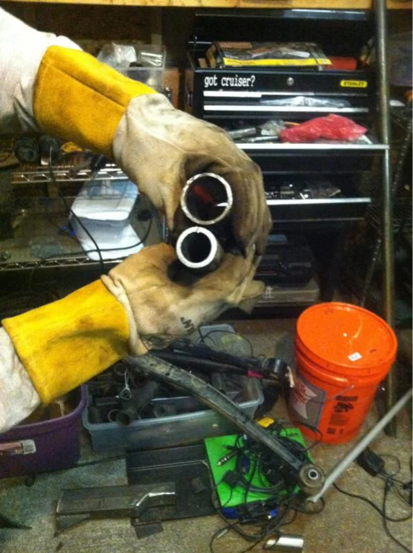

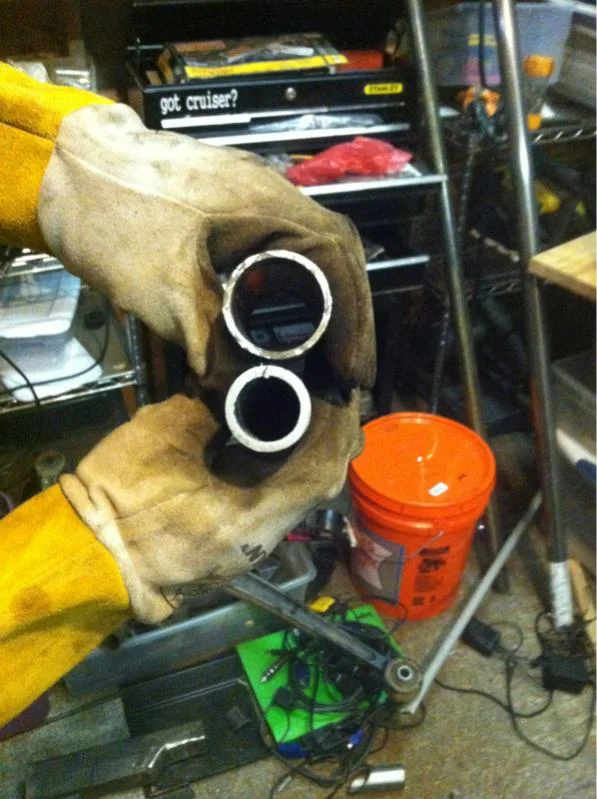

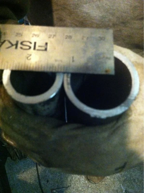

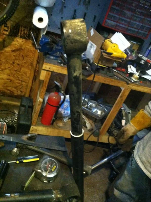

First pics are 95+ LCAs compared to the older ones.
Then pics of what Matt is sleeving the newer, larger, control arms with.
via mobile app.
for the record, 1.25 black pipe is a perfect fit for the later control arms, slip fit but I had to use the hi-lift to compress it all together. total thickness is now 5/16"
