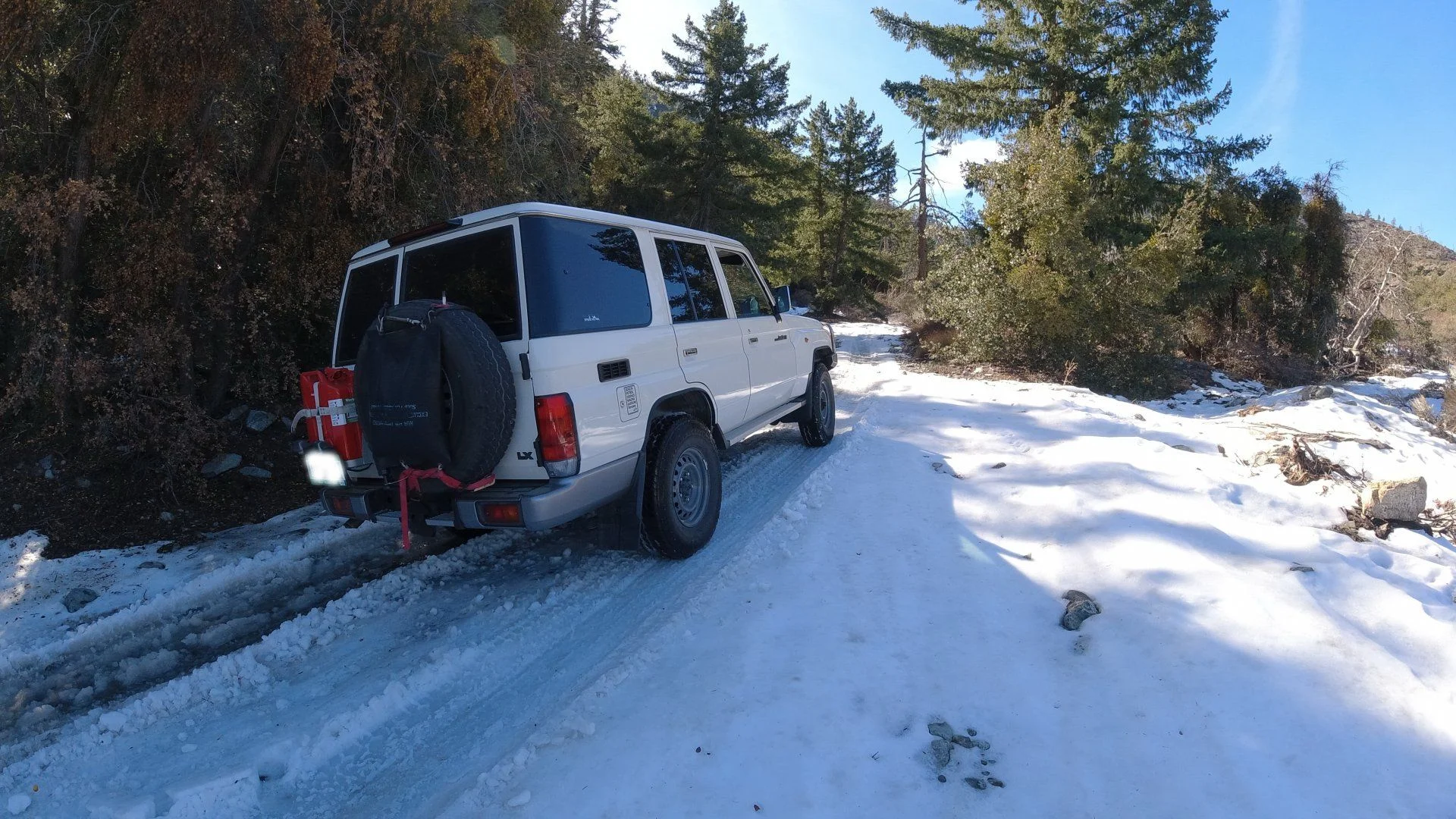

Some pics on Lytle Creek Trail and good food using a TemboTusk Skottle Grill.

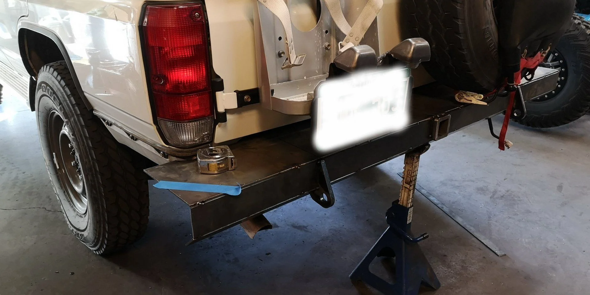

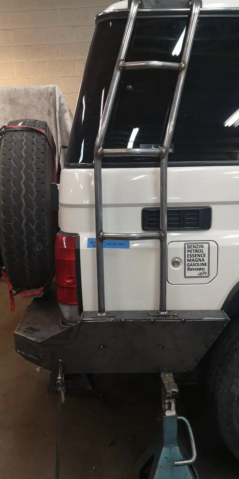

Some pics of the Rear set up. I chose to put a ladder on the side to access my QuickPitch tent that I will be getting from HST.Global website.
Though the tent comes with a telescopic ladder, saves me the effort of storing the ladder.

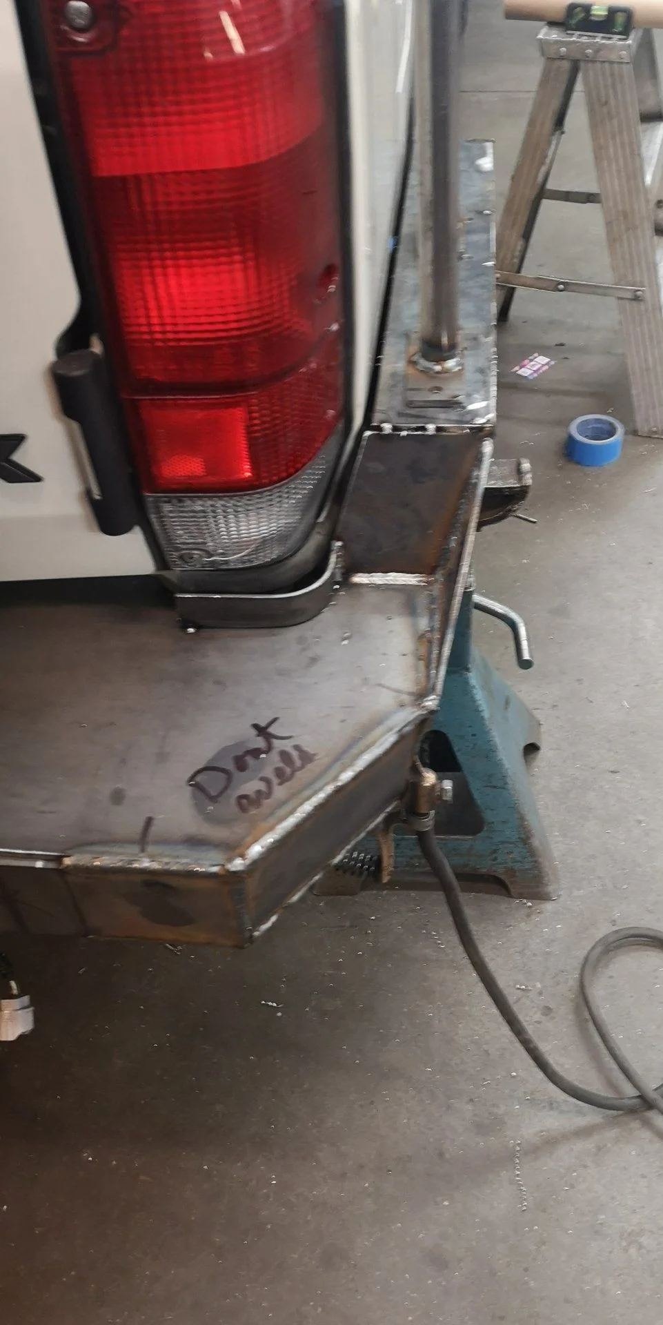

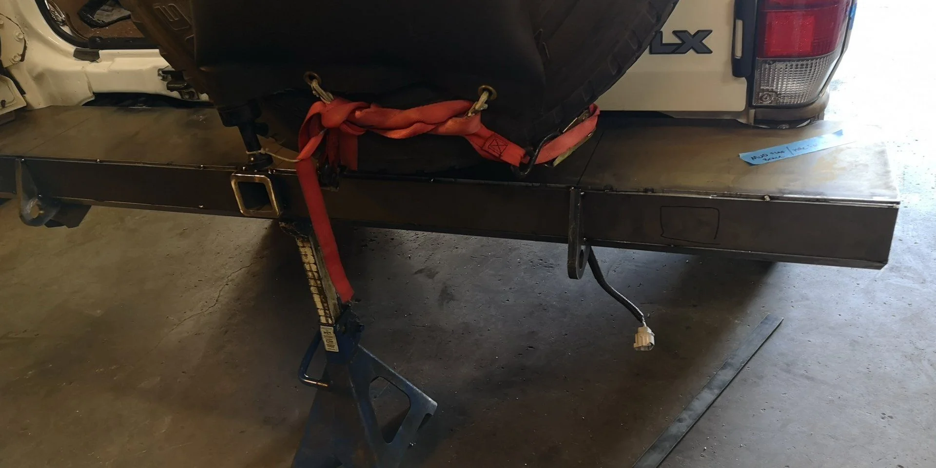

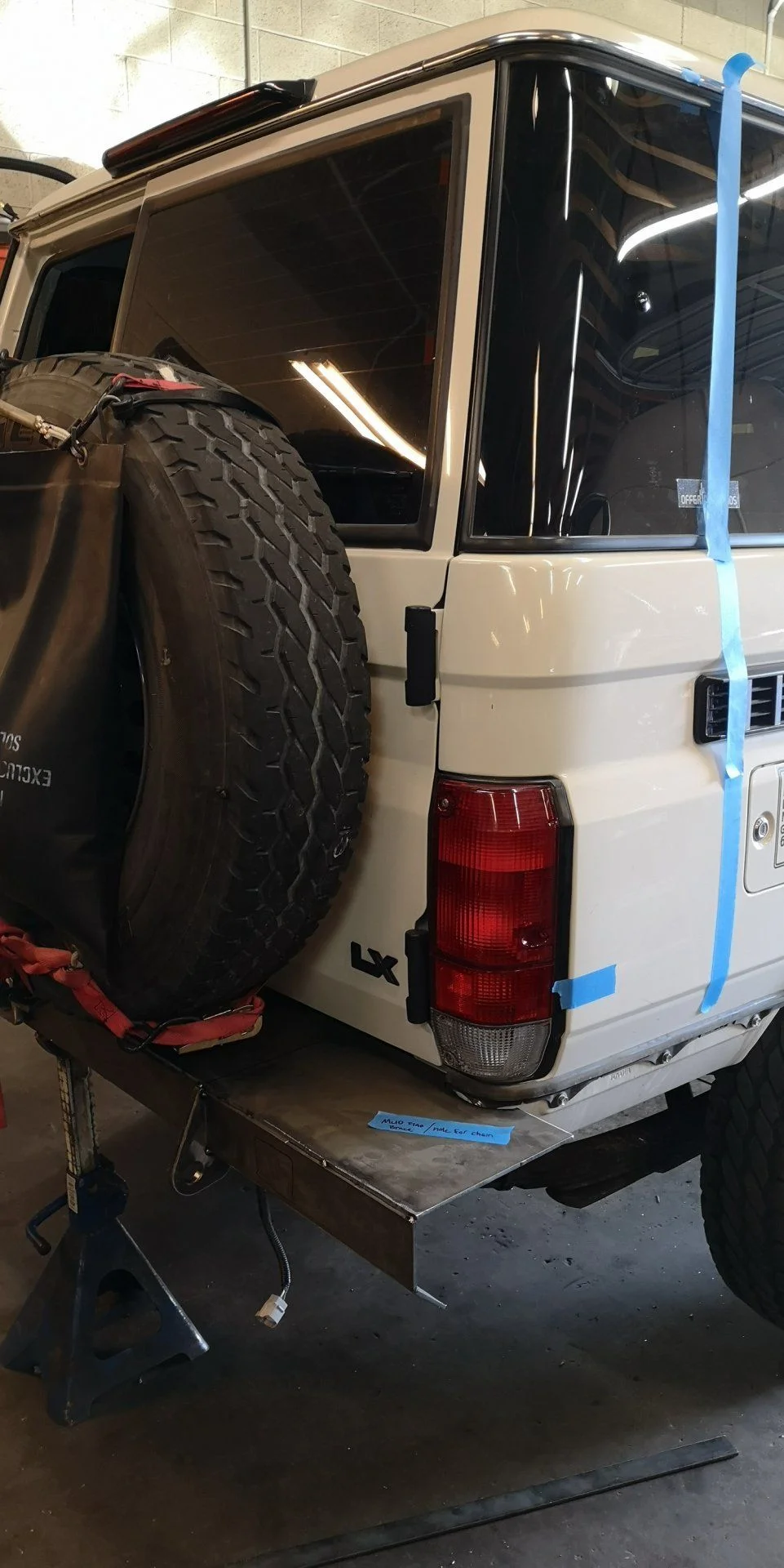

I will be cutting 2 square holes to add rear work lights. I also added a Receiver hitch, wanted it integrated so not to scrape during departure angle.
Still needs some cutting specially under the light area. Work in progress...

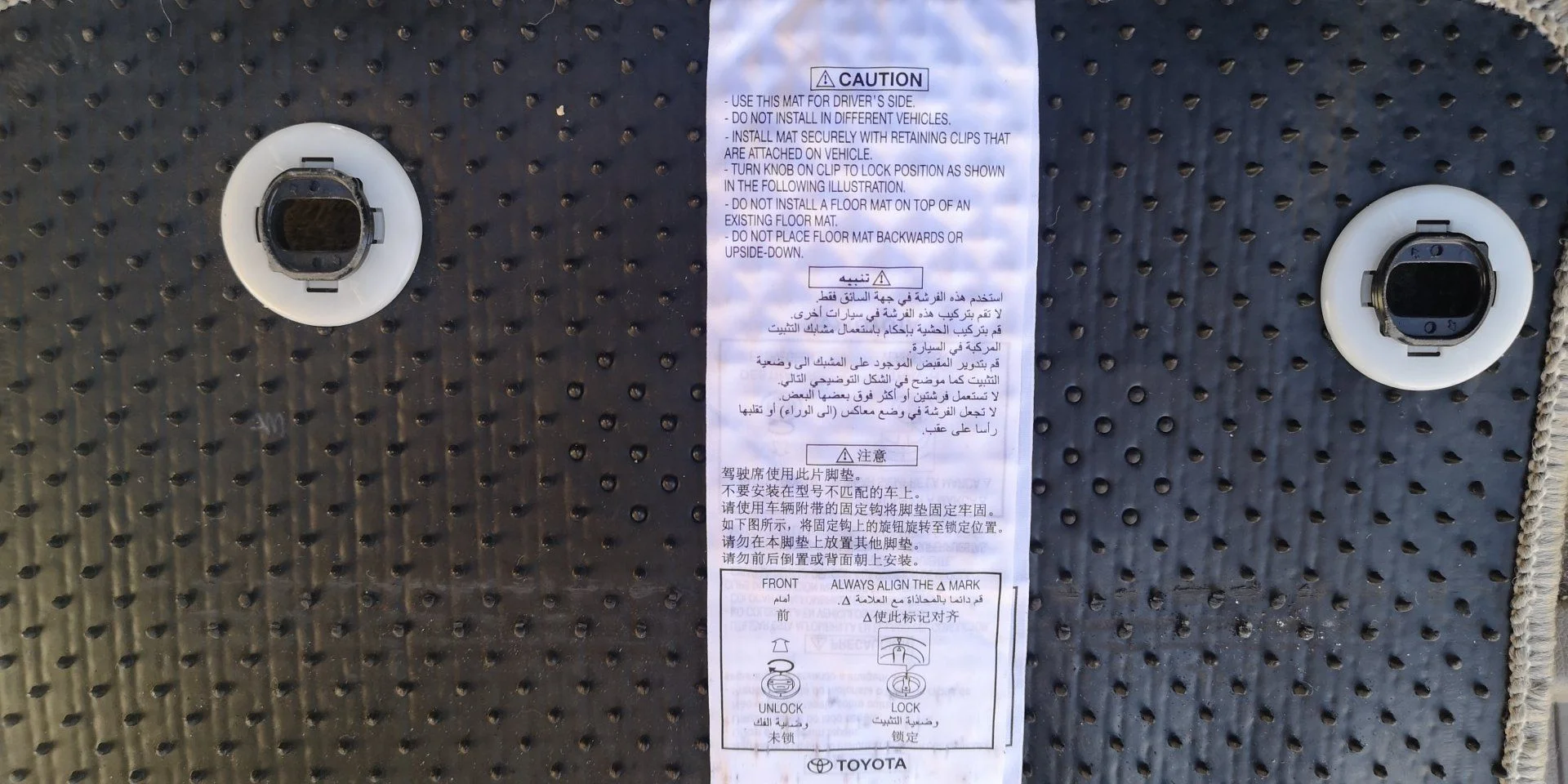

Your's came with floor mats. Do you mind to ask your supplier if they can source them floormats? Our's came without floor mats and I don't find any original / OEM for the J7xL. Strange thing is that there seems to be no part number for the floor mats. Nobody knows, even our suppliers here have no record. They say some come with and some without, that's it.

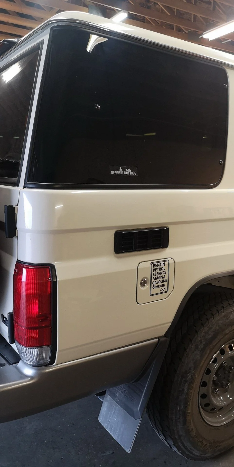

It's got the tank on the back. Our's doesn't.

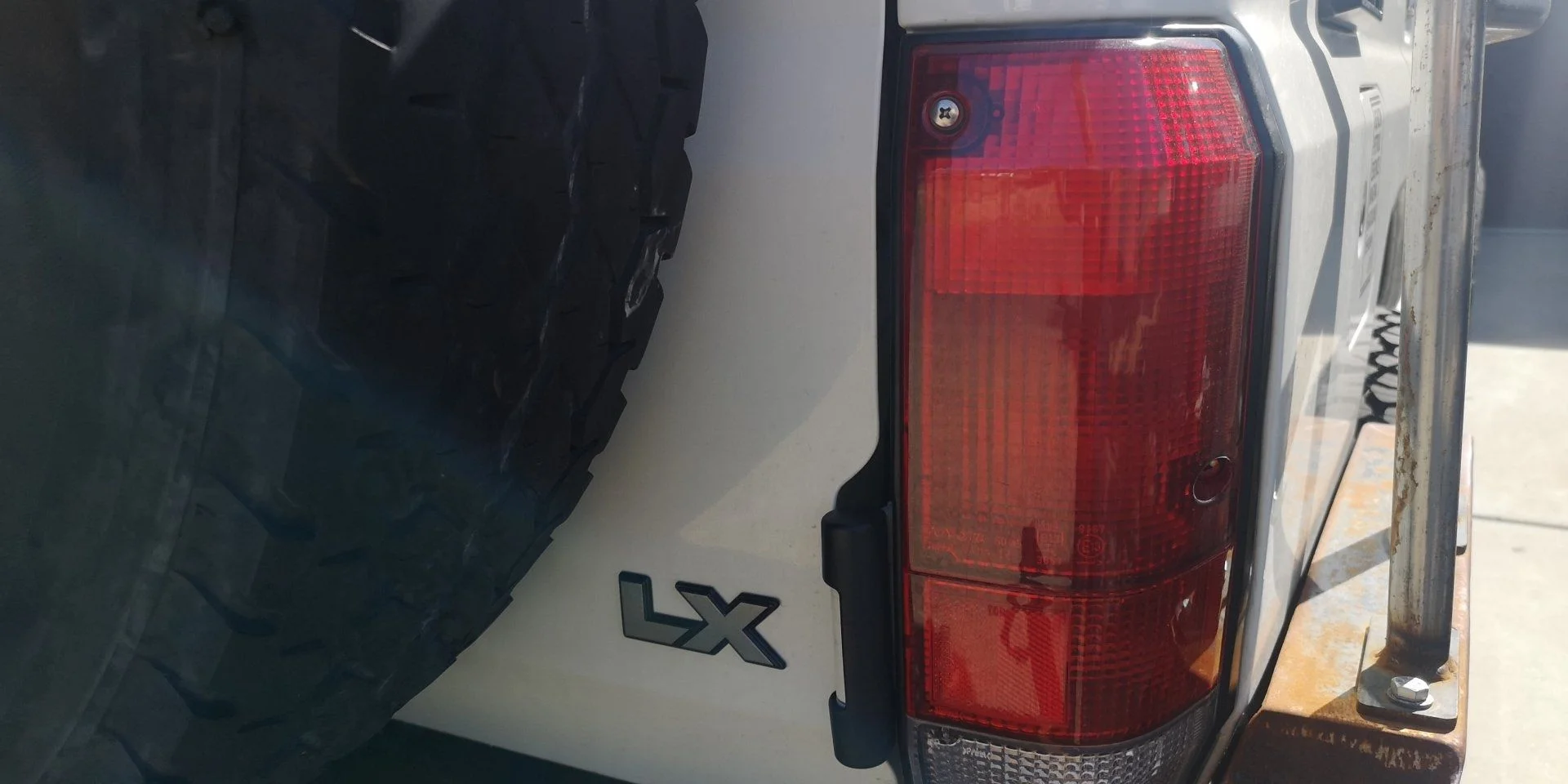

And the "LX" badge is on the right back door bottom right corner. Our badge is on the left door below the window.

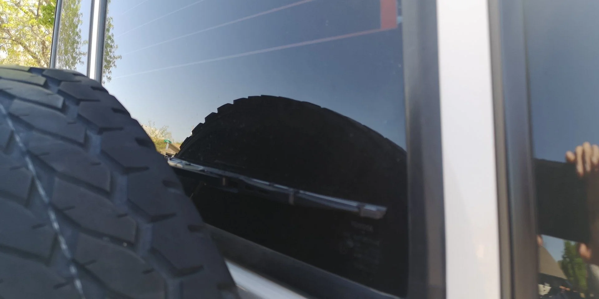

I do have a rear window washing container in the back passenger side. It does have the wiper on the passenger side only. Please see pic below.

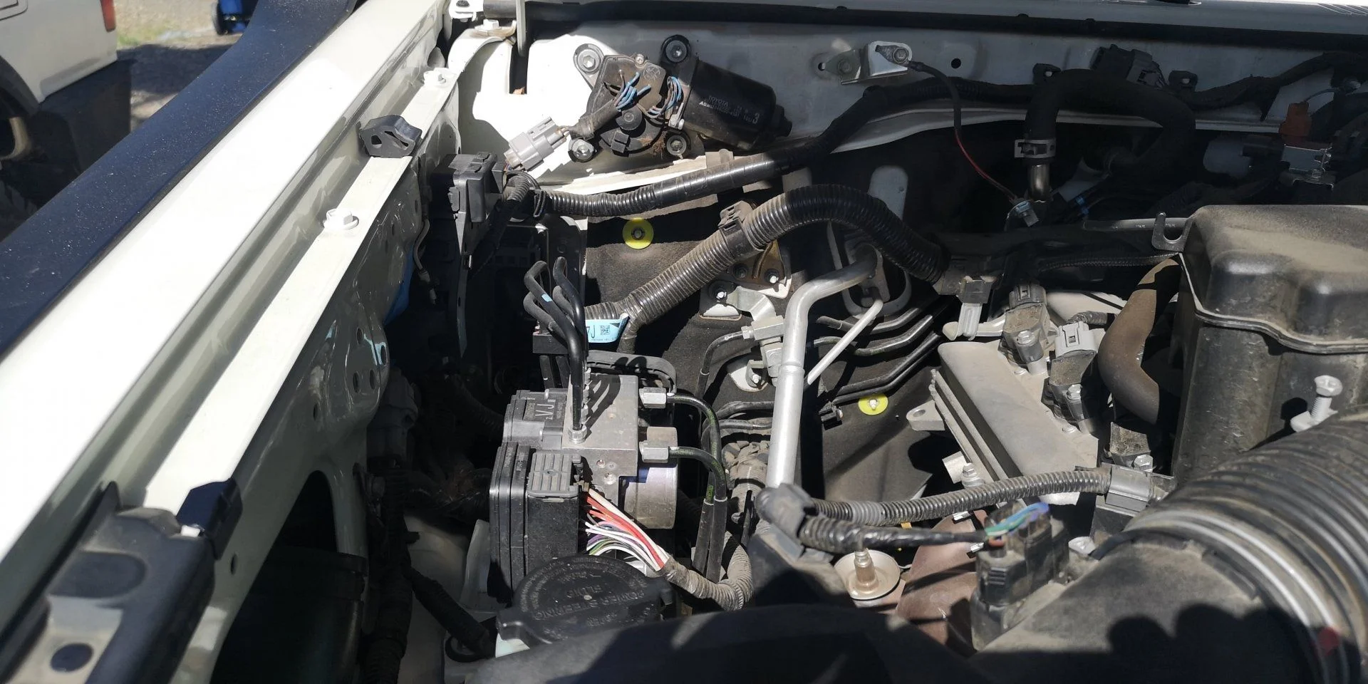

I do not have the Aux power supply box, but I do have the tire pressure monitor box in the rear driver side between the C and D pillar.
I do have the OEM Jerry can tank for the rear.
LX is on the bottom right.

If you could ask for the floor mats, that would be great. I am in Europe, so the may have to be sent there. yes sir, camel-beige :banana:
If you'd ever need to get some additional power supply going from the engine compartment that aux power supply box is a great OEM-like way to go. Basically a simple fuse box with 4 terminals. one ground and the other three for: power-when-engine-on, power-when-on-ACC, power-always-on.
I ordered it from Japan, came today. Plug&Play, easy as pie.
Partsouq has it listed as:
8260060090BLOCK ASSY, FUSE82600GRJ7#,HZJ7# ACCESSORY CONNECTOR-WITH(ENGINE ROOM)
Megazip can deliver too, bit cheaper.
May need the bracket and some fuses aswell.

The cruisers come with different packages. The only thing was the brake stop and turn signals were in bumper instead of the sides. I moved them over to the top right and left and were better for me. This way I have a custom rear bumper with 2 flood lights.

Regarding your light change: We can not have red blinkers in Europe. So when replacing the bumper another tail light unit including orange blinkiblinkis is needed or the new bumper needs to have a light unit accordingly.
