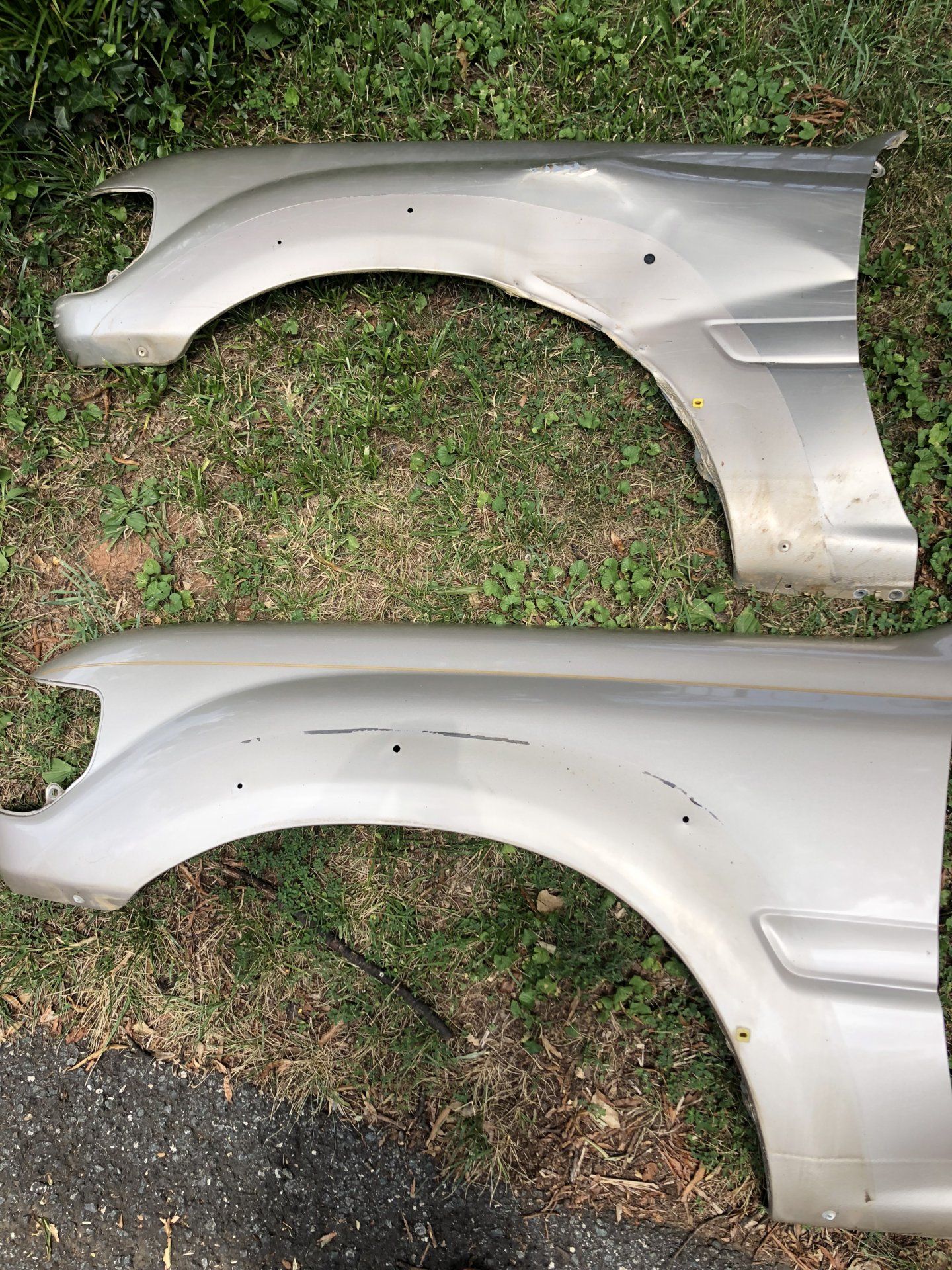

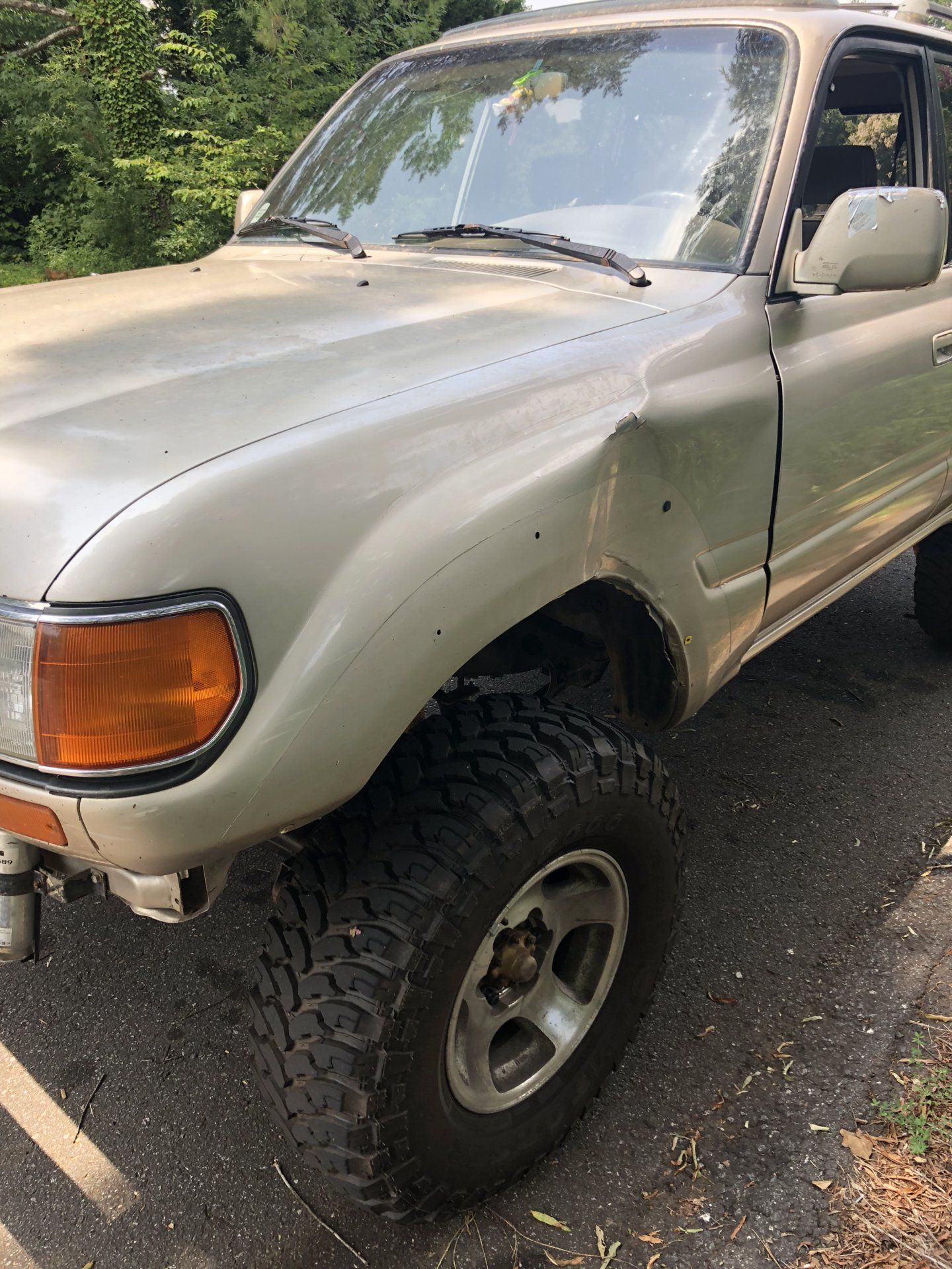

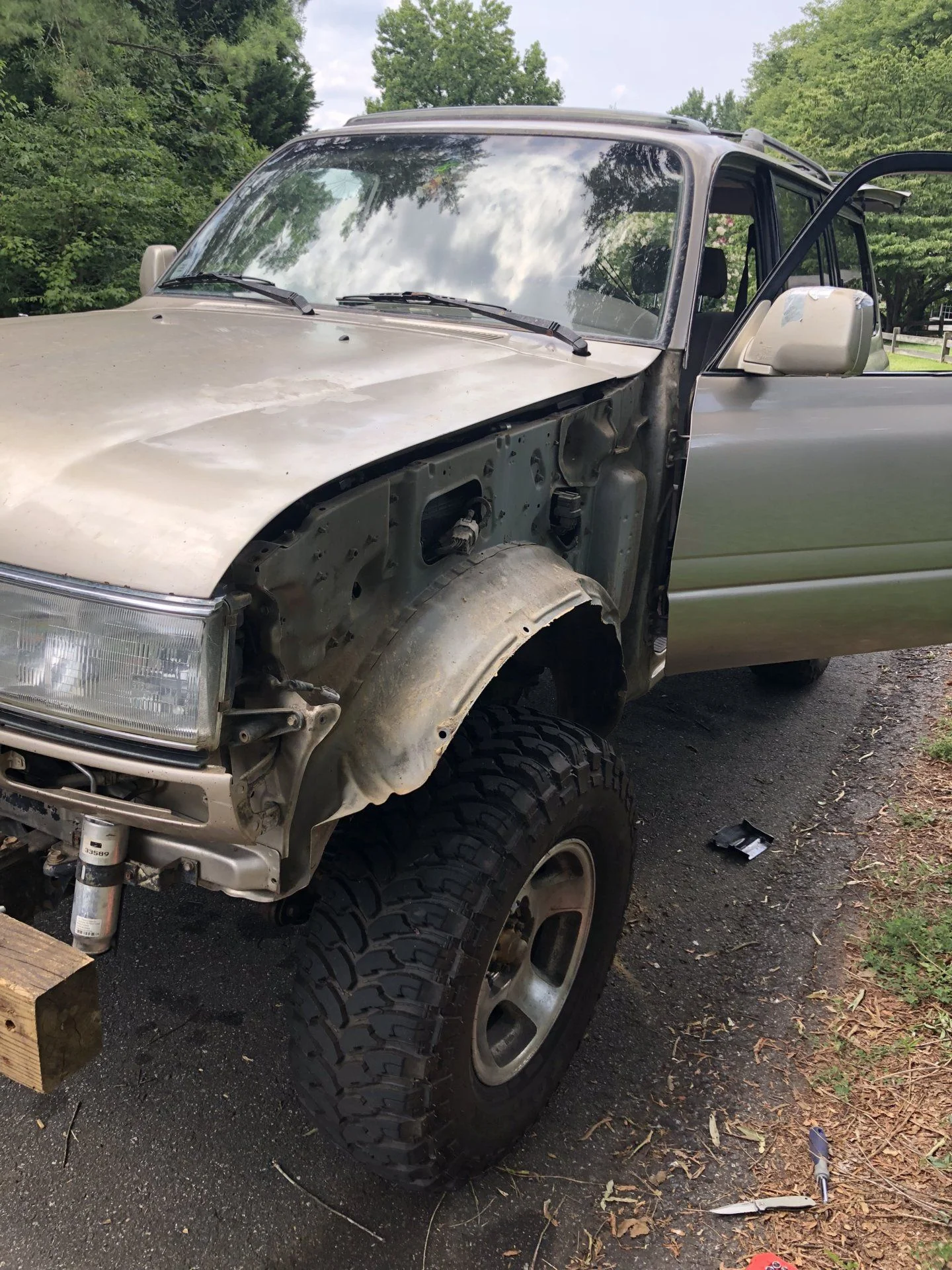

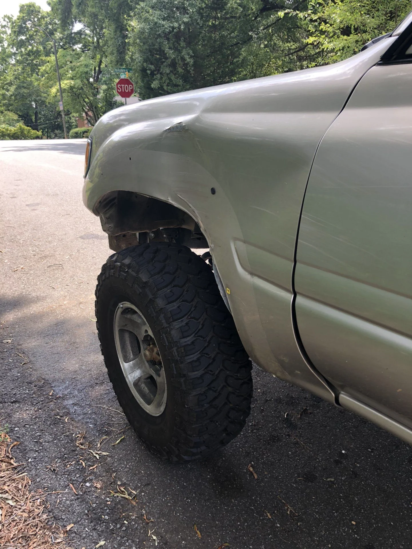

So finally it was time to fix that fender, I got a correct color fender from @AJR and got it on on my lunch break one day. The hardest part was beating the inner fender into submission.
I’d say the gold pinstripe on that fender adds at least 5HP too.

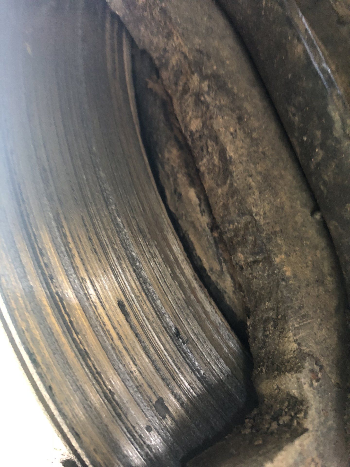

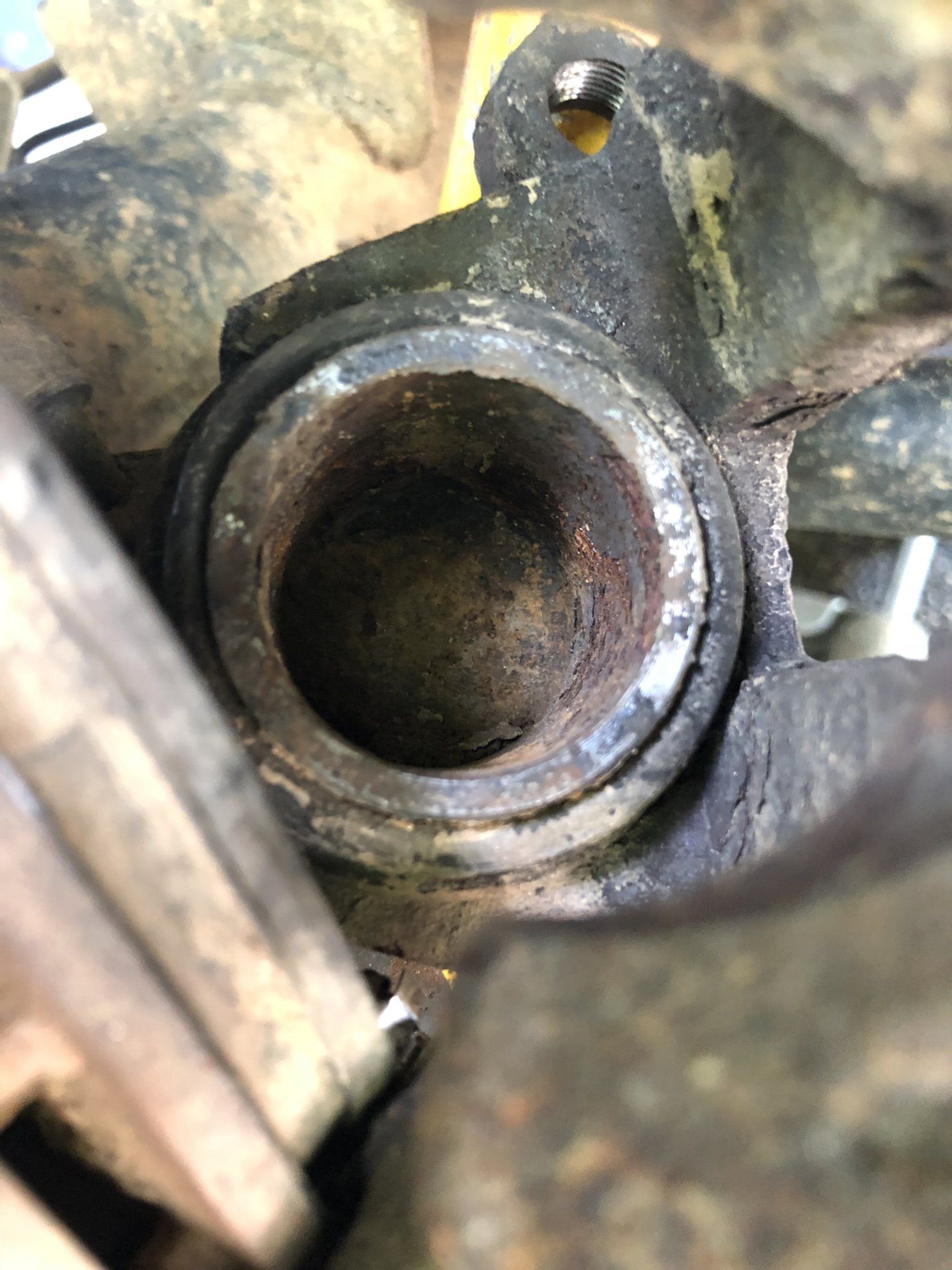

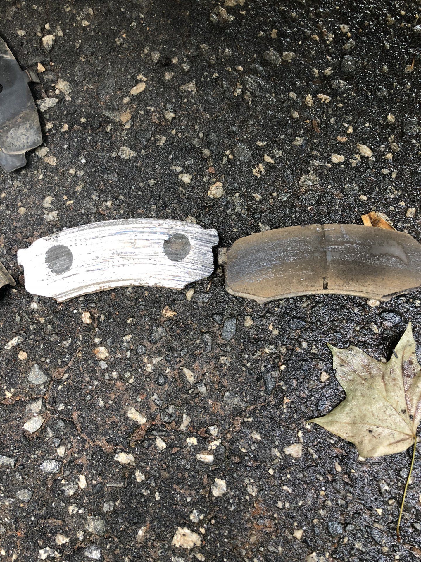

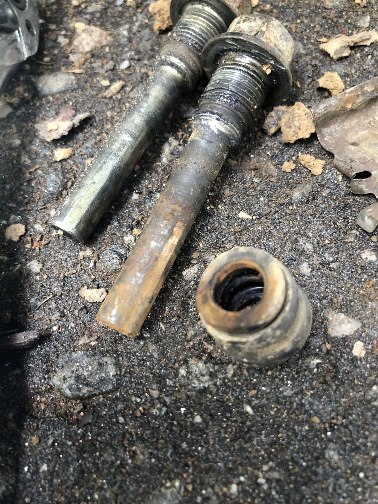

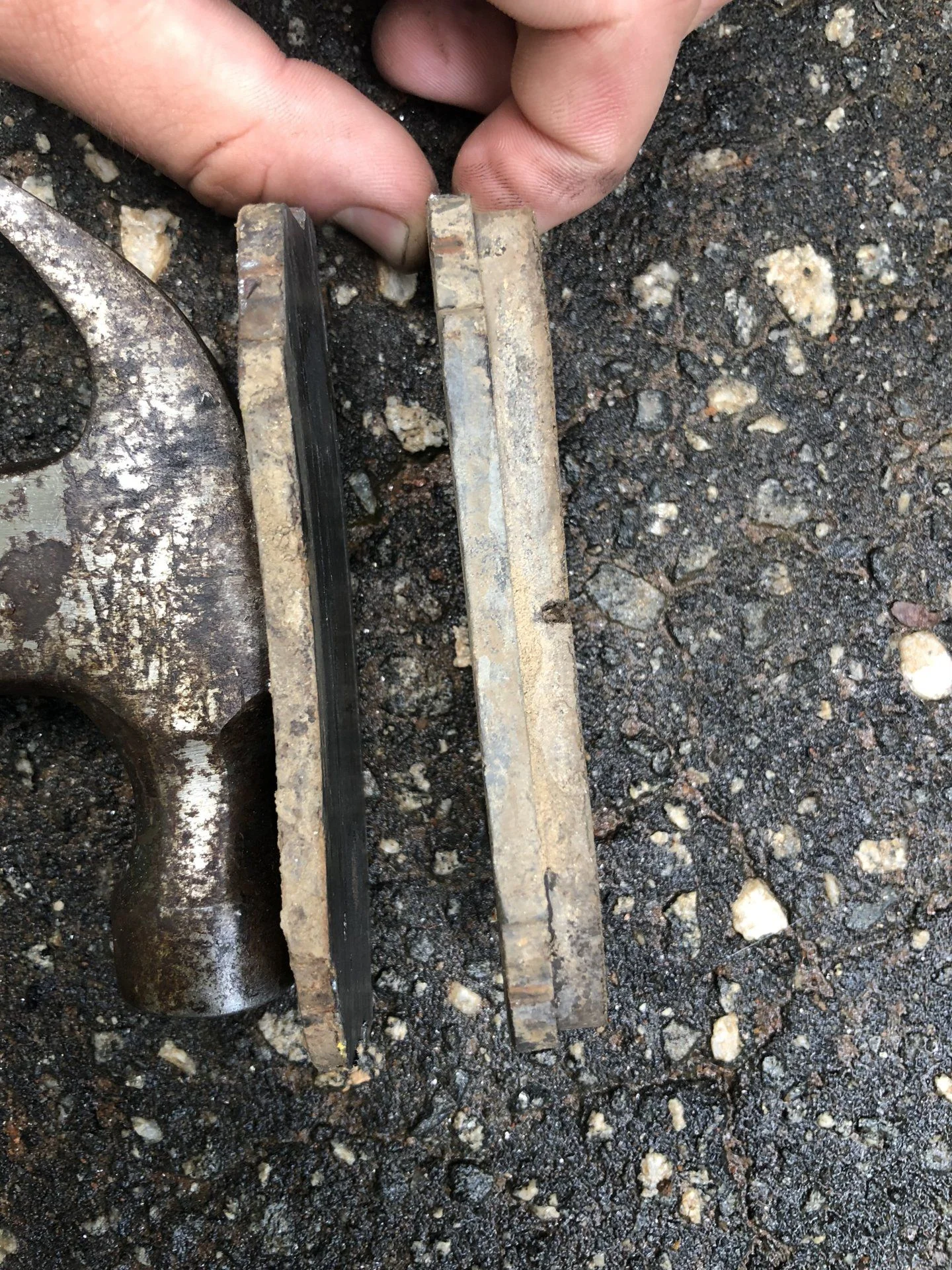

I’d been noticing a strange rubbing sound coming from my PS rear brake for about a week. It was faint but all of a sudden this morning it was very loud. When I got home from work I pulled the wheel expecting to just replace the pads, I hadn’t gotten around to it yet since replacing the pads and the caliper on the DS. The outside pad is good with lots of meat left, the inside pad however has no material at all, just metal. Which ate my rotor. It appears the piston in my caliper was seized, which I assume is what caused the problem. I am getting a caliper and rotor from Napa tomorrow so I should be back in business.
On the rear calipers the primary problem, one pad worn, appears to be the rusty pins not allowing the caliper to float. On the front one pad worn would be the piston being frozen as there are fixed and do not float.
Well one of the pins I had to beat out of the caliper too.
