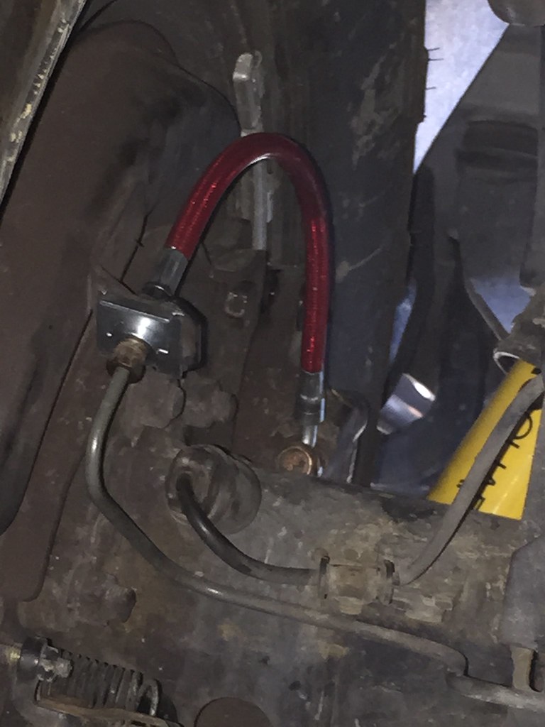

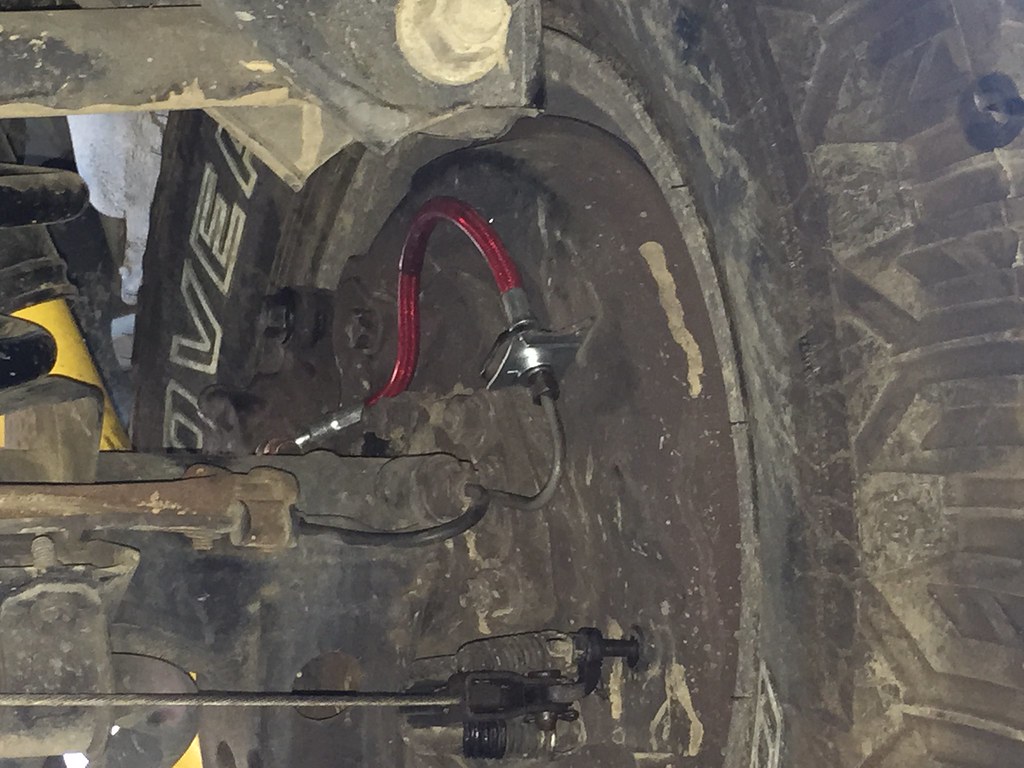

Just got my Extended Brake Line Kit (5") today, will try to install everything on Thursday, go wheel over the weekend and report on the improvement next week :)

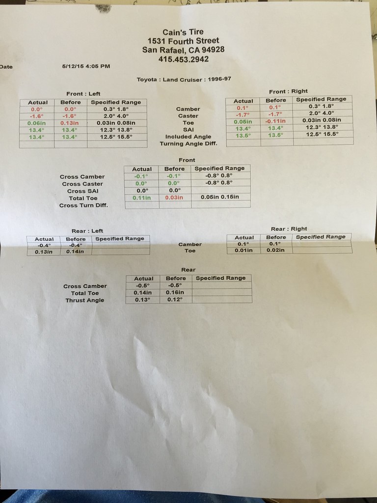

Did you install OME caster bushings?
What was the resulting camber when aligned?
Was it within +2 to +4 factory specs?

Yes on the bushings and here's the alignment report... Hope it helps!

Mine has +0 degree and yours is even more extremely out of spec
Do you know why?

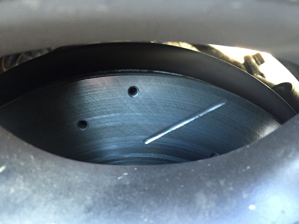

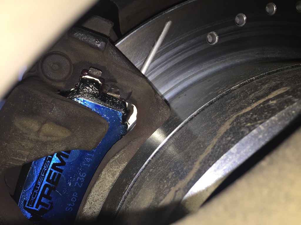

How do the brakes feel? I am in desperate need of new rotors. My pads are fairly new but my rotors are well below minimum. I would prefer slotted or solid over cross drilled but I really wanted your opinion on the whole package.
So I've got just over 700 miles on the new brakes, rotors, etc. and I'd say the improvement is noticeable. Not huge but def. there... I'd say 25% marginal gain compared to the old brakes. They "bite" a bit better but the brake pedal still feels kinda the same to be honest. I was expecting a "firmer" brake pedal but maybe that was the wrong expectation to have.
Now, on trails and heavy braking (like downhill, etc.) def. a serious improvement!! I can ride the brakes much longer without fade and get a better feel & control overall.
For the price I paid (~$305 OTD) for the kit (rotors and pads) I'd say it's a valuable improvement. I got quoted close to $1,200 for the same kinda kit from a local brake place (with labor) and that would not have been worth that kind of money.
Since I did the SS brake lines at the same time, I'm not sure how much improvement is to be attributed to that... Hope this helps!! :D
No, I have to go back to Cains as I also suspect they installed the OME springs wrong... Left side is lower than right :meh:
Common rookie mistake as springs are labeled for Aus handed drives. Stupid.
Its also possible to install OME bushings "clocked" (oriented) incorrectly resulting in insufficient caster.
Factory suspension should be +2 to +4.
2 1/2" lift w OME bushing should be similar.

I stopped by today to talk about the issue, will go back on Thu. to double check it all... will keep you posted!

Cains confirmed they matched long with the long and the short with the short, so I have the A coils on the driver side and the B coils on the passenger side...
Now, we did confirm that they did not install the OME caster kit (probably wasn't delivered)!! So I'll be back next week to put these in and that should fix the caster situation ha!
