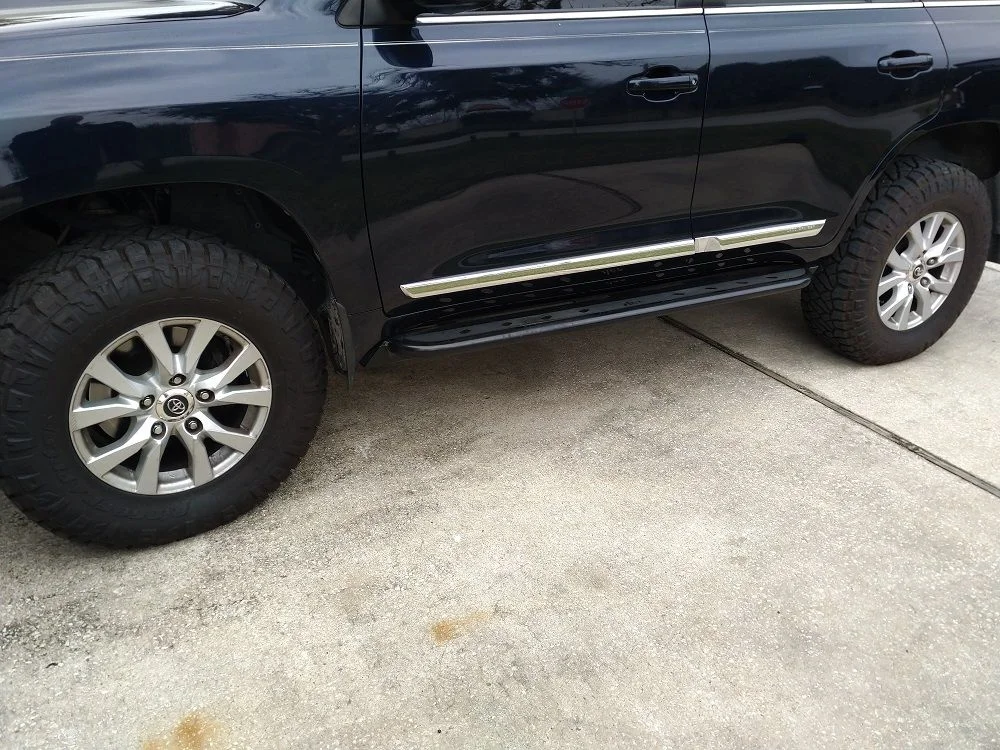

After much research on what others had done I went with Nitto Ridge Grappler T285/70R18 E 127/124Q which measure at 33.98" x 11.5.

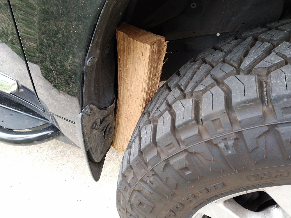

They barely touched the KDSS on the front driver, and both front mud flaps I needed to heat with a heat gun and then press them back with a piece of fire wood.
To fix the KDSS touching I used BORA 3/4" spacers.
I removed the front mud flaps, and installed the tires and they were ok driving around.
The when the bora spacers arrived I installed them and put the mud flaps back on.
Then heated the mud flaps with a heat gun till they were soft and put a piece of fire wood to pinch the mud flap into place until it cooled down.
They fit perfect.
