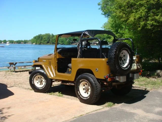

Hey guys.
i painted the rig. First paint job for me.
HVLP gun from Home Depot.
Napa Crossfire paint.
A garage.
One week off of work.
Here's the result... Enjoy!

Looks awesome!!! Bet that paint gun is addictive now. I'd be painting everything......
nice job...ct? no top :)
Yeah, i took it off in early April... It's still white (doors too...) A bit of a chill in the mornings.
You bet- my wife wouldn't let me paint the dog :hillbilly:... the unfortunate thing is that I learned how to use it on the 40- came out so-so... but I bet if I did the dog first the 40 would be a show stopper!!!! :D
Nice Job Jamie , Nice pic of Congamond too. Come over here and show me how to do that paint Job pls . Joe Egolf
Thanks Joe! that's a shot from the 'old man's' house... beautiful weekend this weekend, eh?
I'll stop by soon.
Thanks guys!!! :cheers:
