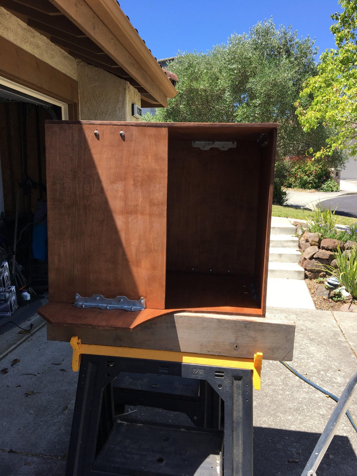

When starting this I knew I wanted a box to go around the fridge. So I could keep the sun off of it and stuff the car full and still get into the fridge easily.
For this I used 1/2 inch birch ply and Simpson strong tie stair stringers with carriage bolts as connections. All found at home depot.
This side of the box goes against the wheel well and the "missing piece" is for easy access to unplug the fridge and run its cables through.
