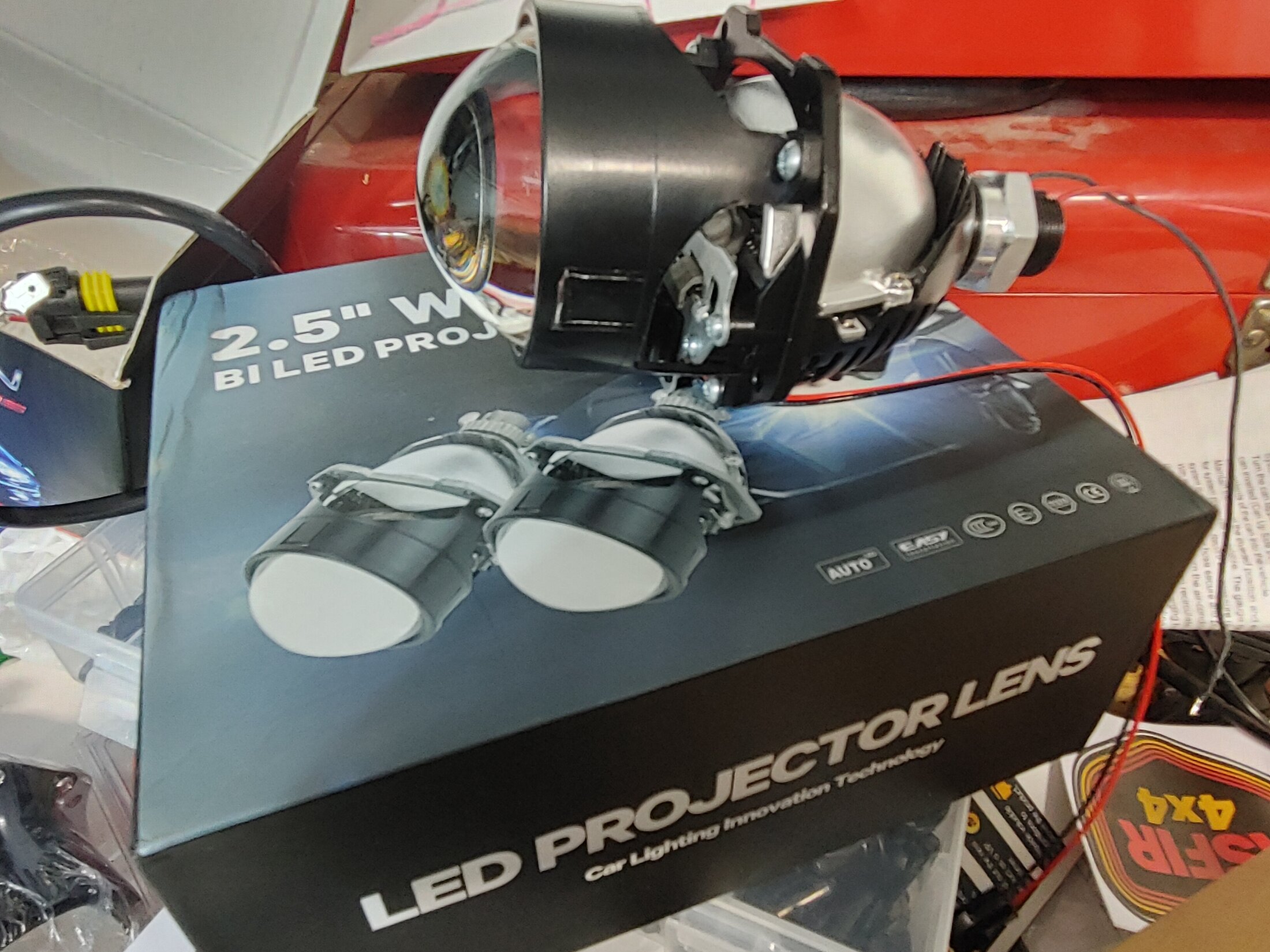

Compared stock LX470 H1 projector (squirrel finder delete + clear lens + Hikari Future bulbs) with an Amazon special LED projector and a micro D2s with 5k bulbs. I was shocked how well this sub $100 led projector did. Didn't have huge width but man the hotspot is intense. It also fits Luke111s brackets so it will be a direct drop-in for the LX

These were the LED projectors, I'm sure they go by a bunch of different names and brands

Well, I was going to go the D2S at first, but the led is tempting. Cheap, instant performance with no ballasts or extra harnesses. From outside the car I think they'll all look more or less identical.
However, longevity makes me unsure. Would suck to have to bake the whole headlight again when the led dies. Replacing just a hid bulb or ballast is comparatively much easier
