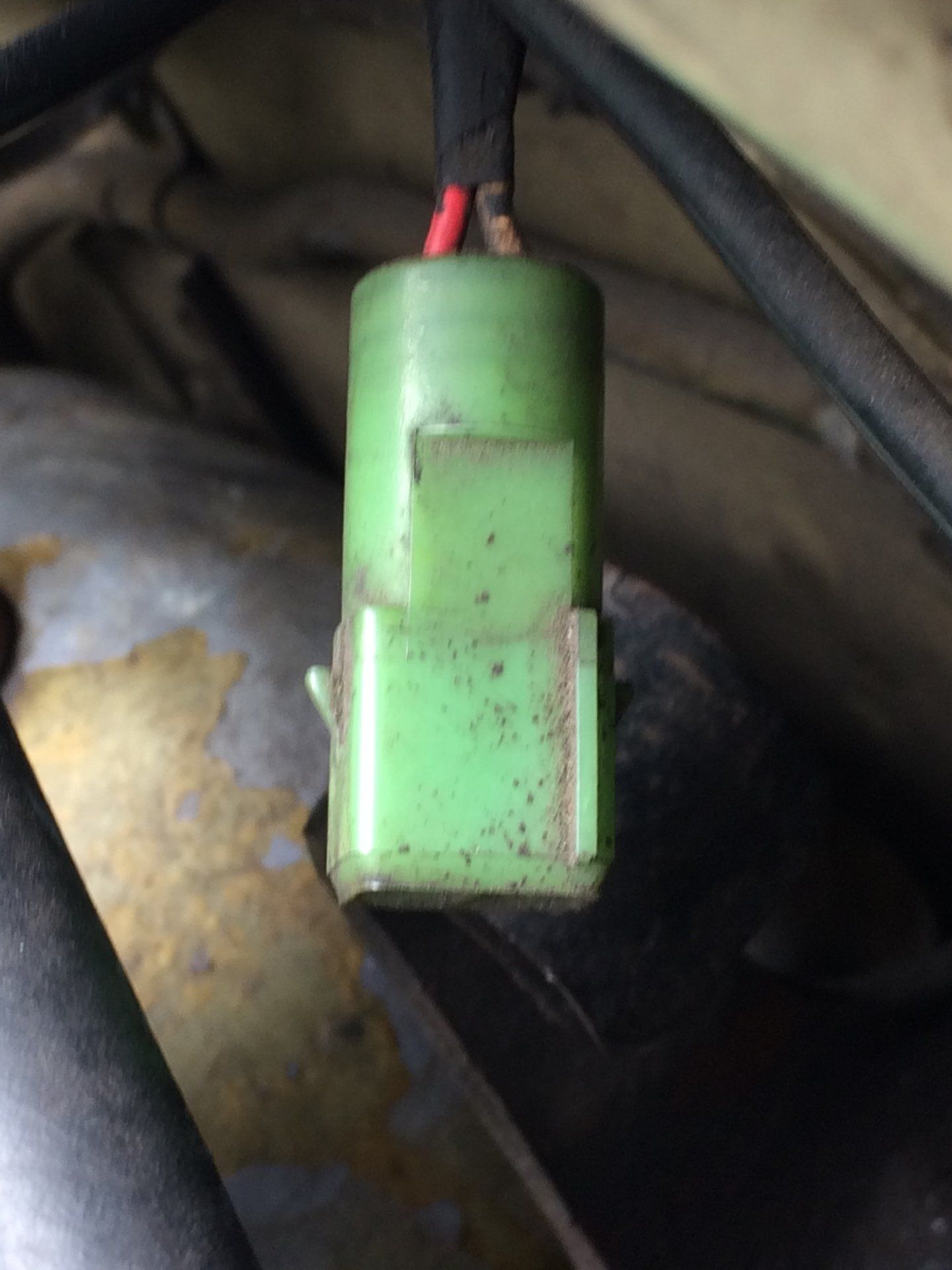

where is your choke solenoid Wire's ? / wire
if u have a 2 wire one then on the fender , but if u have a single wire one then ?
- i do recall seeing a single wire choke solenoid leed coming from one of the
2 green wire plug terminals in the past ?

The choke solenoid is there, I am unable to bring it up and around toput it in its holder(clamp) due to the way it was put together. It’s on my list but I haven’t looked yet at how to accomplish that.

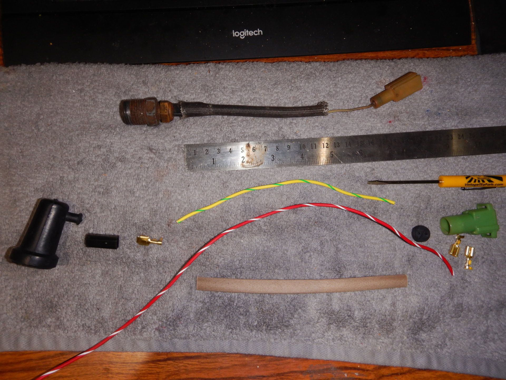

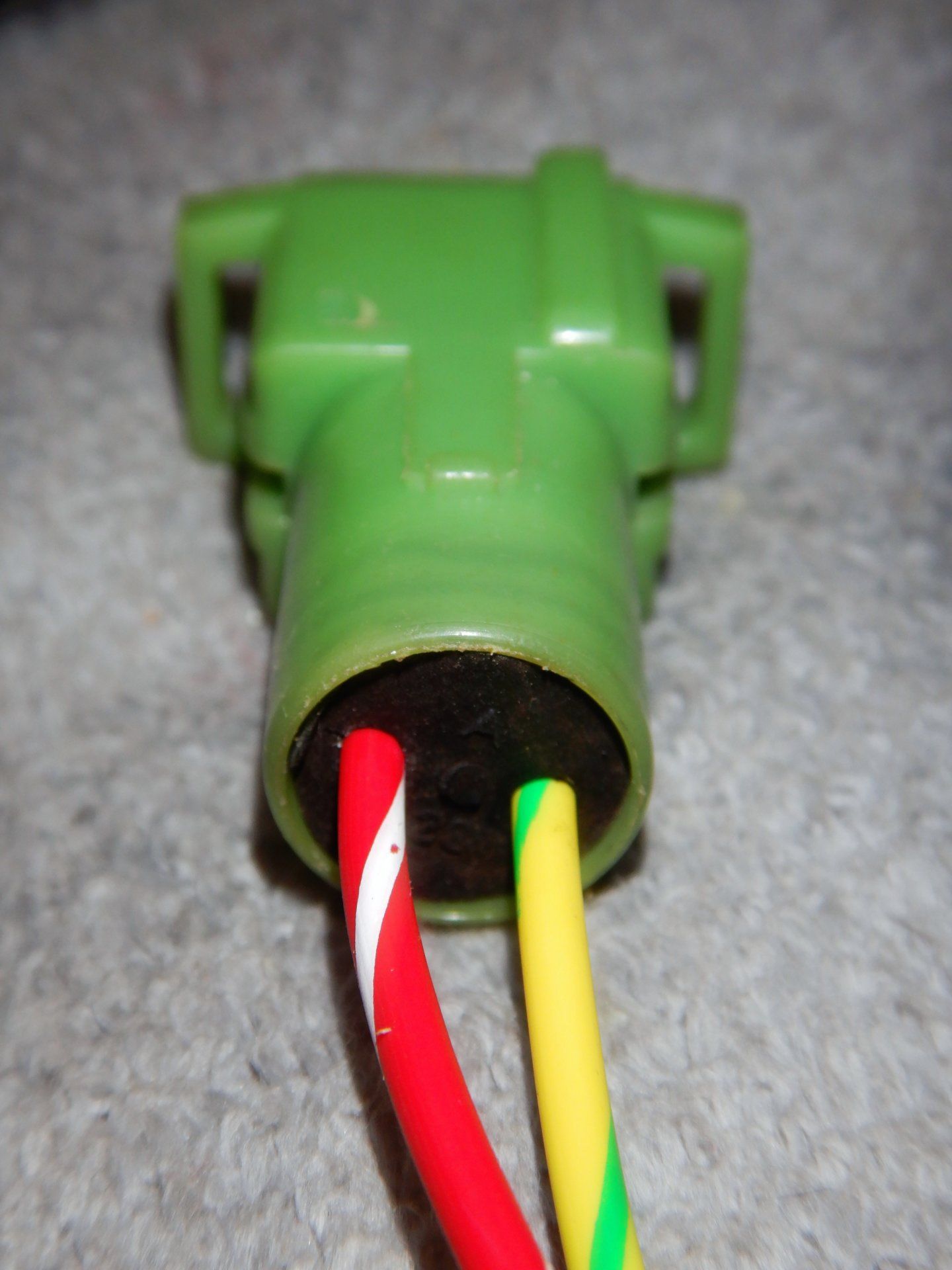

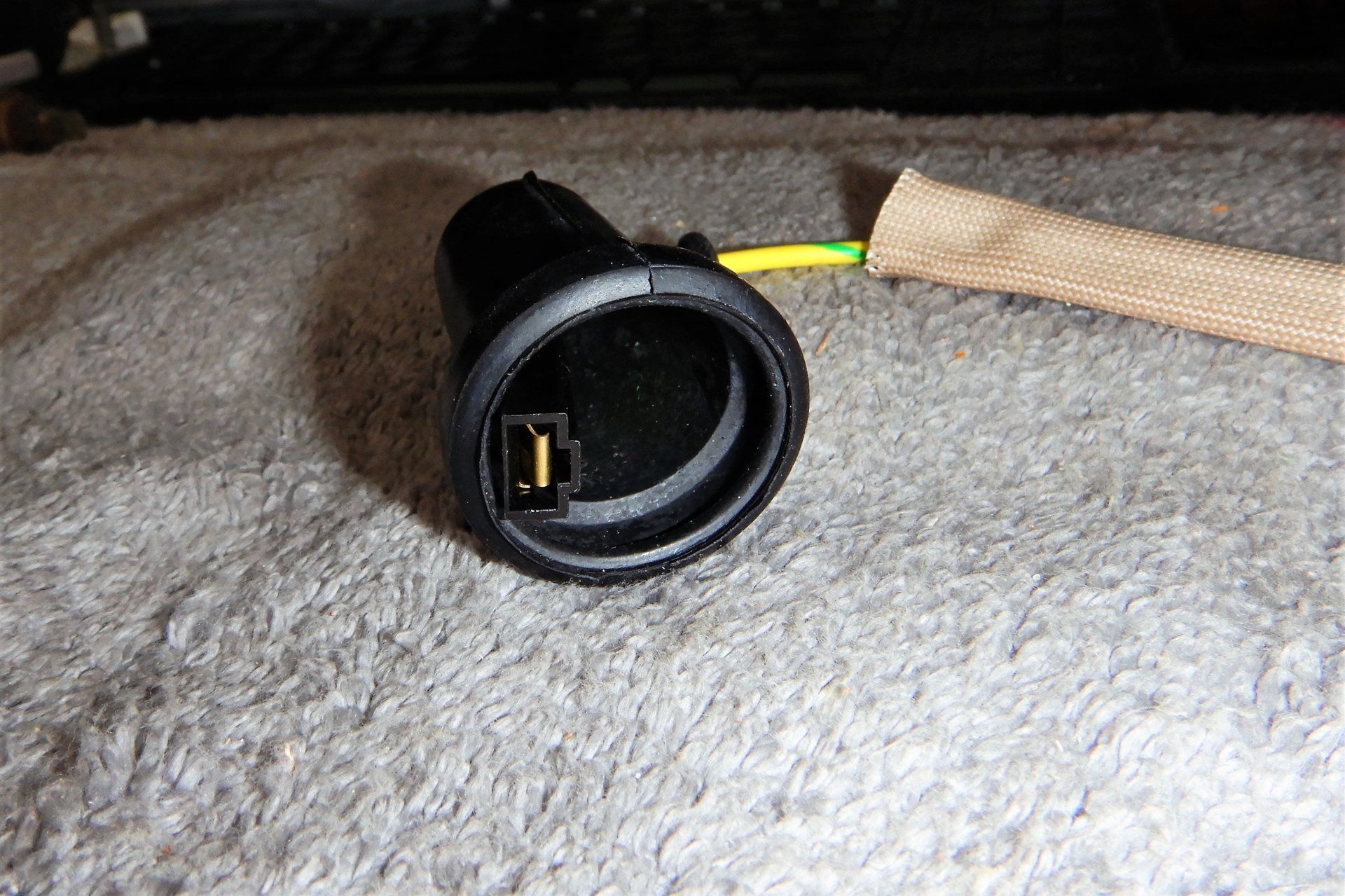

ok , here we are from start to a FSM finish level .
- your long dormant Thermo Red Wire will simply tuck up inside the Flame Proof Loom for possible later Use ....
- i had i last NOS green matching Connector , and followed your profile photos as we discussed
- i will cap off the thermo wire end for u
- well , Plug and Play she is ! :)
Awesome, Looks great. PM me PayPal info and I’ll take care of it. Going on Vaca for spring break a Saturday. I’ll have something to look forward to when I get home.
One more problem solved. And it makes me so happy. The wiring from Toyota Matt looks great and confirms that the temperature sensor and temperature gauge work. I will leave it connected to one of the current temp sensors for now as I am acquiring the parts and pieces to replace all the heater and radiator hoses. Also rigged a way to get the in dash gauges covered with the radio blank. Looks like a PO butchered the factory hole.
