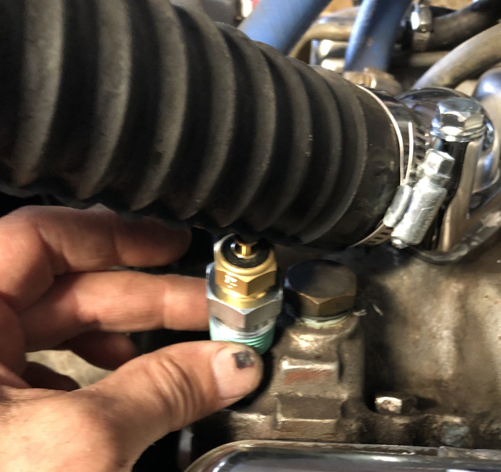

Hi guys - seems like the natural spo for this (yellow circle) is blocked by the neck. I’ll need to create a bypass that allows coolant flor still but any thought on red vs green location?

I have mine in the cylinder head on the passenger side.
I have mine on the driver side cylinder head..works great that way for me..
GM typically put them in the drivers side head near #1cylder. The water pump is a bad idea.

X2 on the driver side head by first cyl., at least thats where all the sbc's I've had were. Speaking to older sbc's , I have not looked to see where the temp sender is on the LS motors.
Plus the water neck puts the temp sender on the radiator side, no engine temp until thermo opens, assuming the thermo opens ? Just my 2 cents but I like it on the engine side.

There's a plug next to # 1 spark plug, in the cylder head. Your pic is of the intake manifold.
In between #1 & #2 spark plug. Driver side.

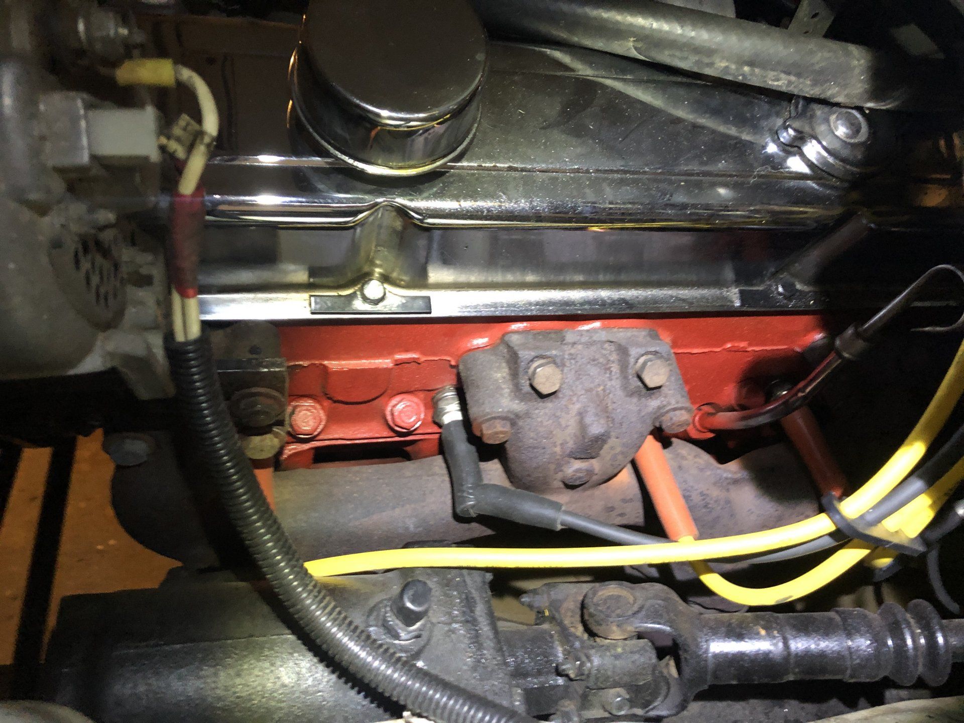

Got a FJ55 with SBC 307 swap. Am putting in Holley Sniper EFI. But I just can not find the Temp Sensor location. On driver side between #1 and #3, and Pass side #6 and #8. Seems like wasn't there, or someone fill it and bored it out. I got a sensor on manifold already. Don't know if anyone makes dual sensor splits? Thanks for the help!

Got a FJ55 with SBC 307 swap. Am putting in Holley Sniper EFI. But I just can not find the Temp Sensor location. On driver side between #1 and #3, and Pass side #6 and #8. Seems like wasn't there, or someone fill it and bored it out. I got a sensor on manifold already. Don't know if anyone makes dual sensor splits? Thanks for the help! View attachment 2373435
