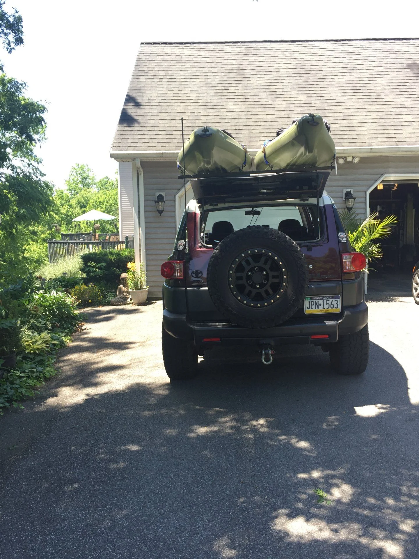

BAJA Flat. This works best for me. Low profile so I fit in the garage again... could not with the OEM rack I used to have. Can carry everything from a hi-lift jack, gas cans and gear to full size plywood up there. not real noisy. I can throw a small 2x2 piece of plywood on top and it works as a platform to stand on when taking pictures or video.
BTW: I usually don't carry much weight up top on the trail... prefer to keep the center of gravity low. But if I need too we can transfer gear from another's truck to the roof and bug out in a pinch.

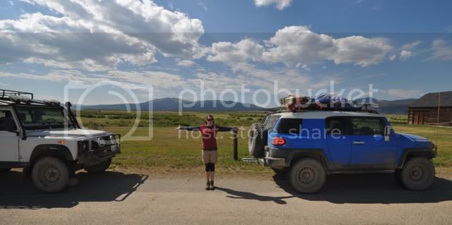

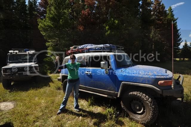

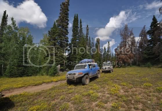

I really like my Gobi Ranger; holds a ton of stuff, holds more weight than you should really put up there. I've had a bunch of people standing/sitting on mine at one time, without bending or deforming it. I bought it just before a long trip along the continental divide, where we had to self-sufficient for everything for a week for three people, and it was perfect - we had enough gas, water, food, shelter, everything. Even took an astronomical telescope and computerized mount, and a portable toilet for the women folk.
It does make some wind noise on the highway when it's empty, but no worse than MT tires.

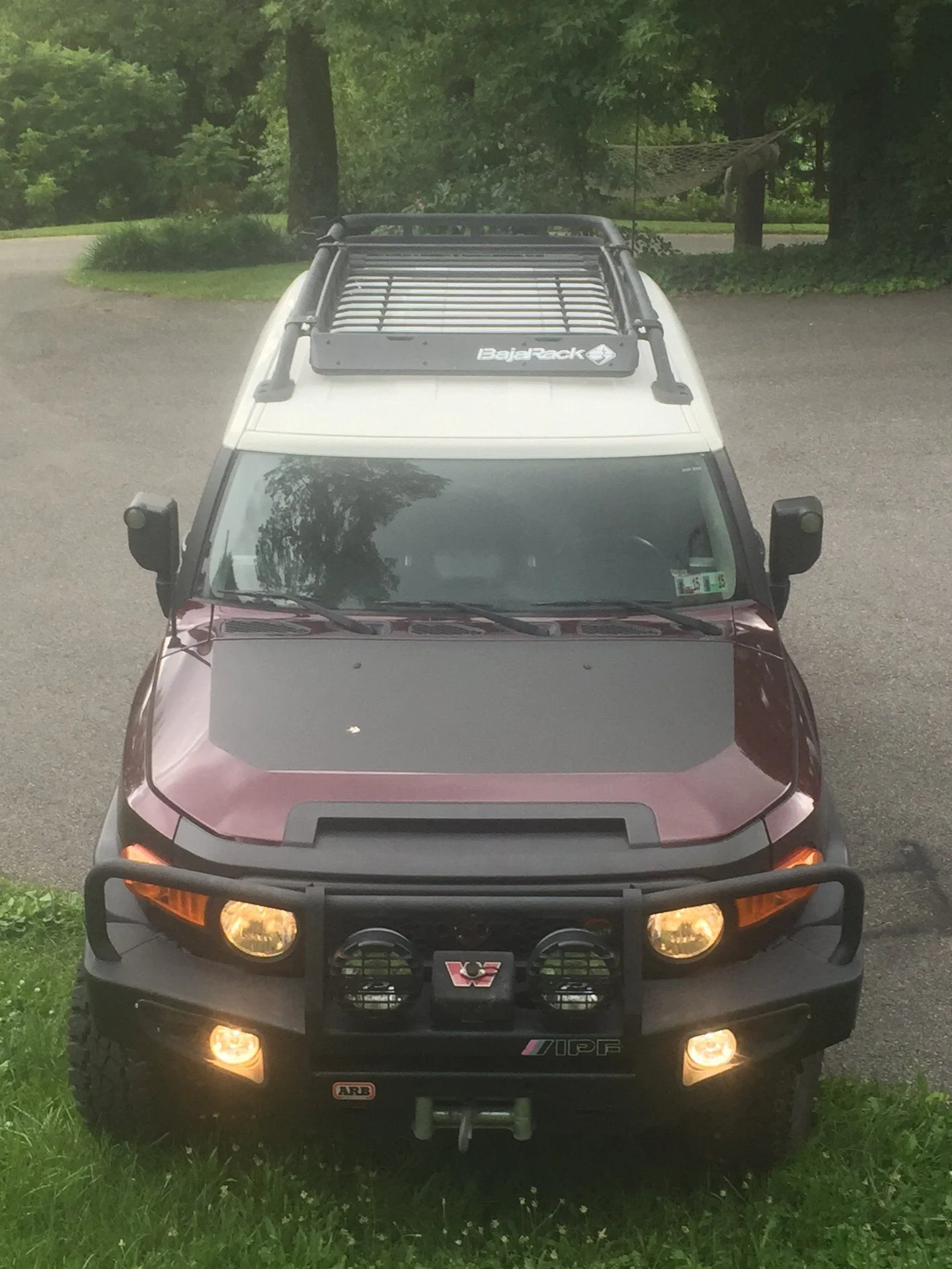

I used the OEM rack with the Baja drop-in basket. ... Pretty much made the entire rack useable real estate. View attachment 1895716
I used this set up for several years and you are right... make all the real estate usable at an fordable rate. And as your pics show, it keeps the good looking OEM lines intact.

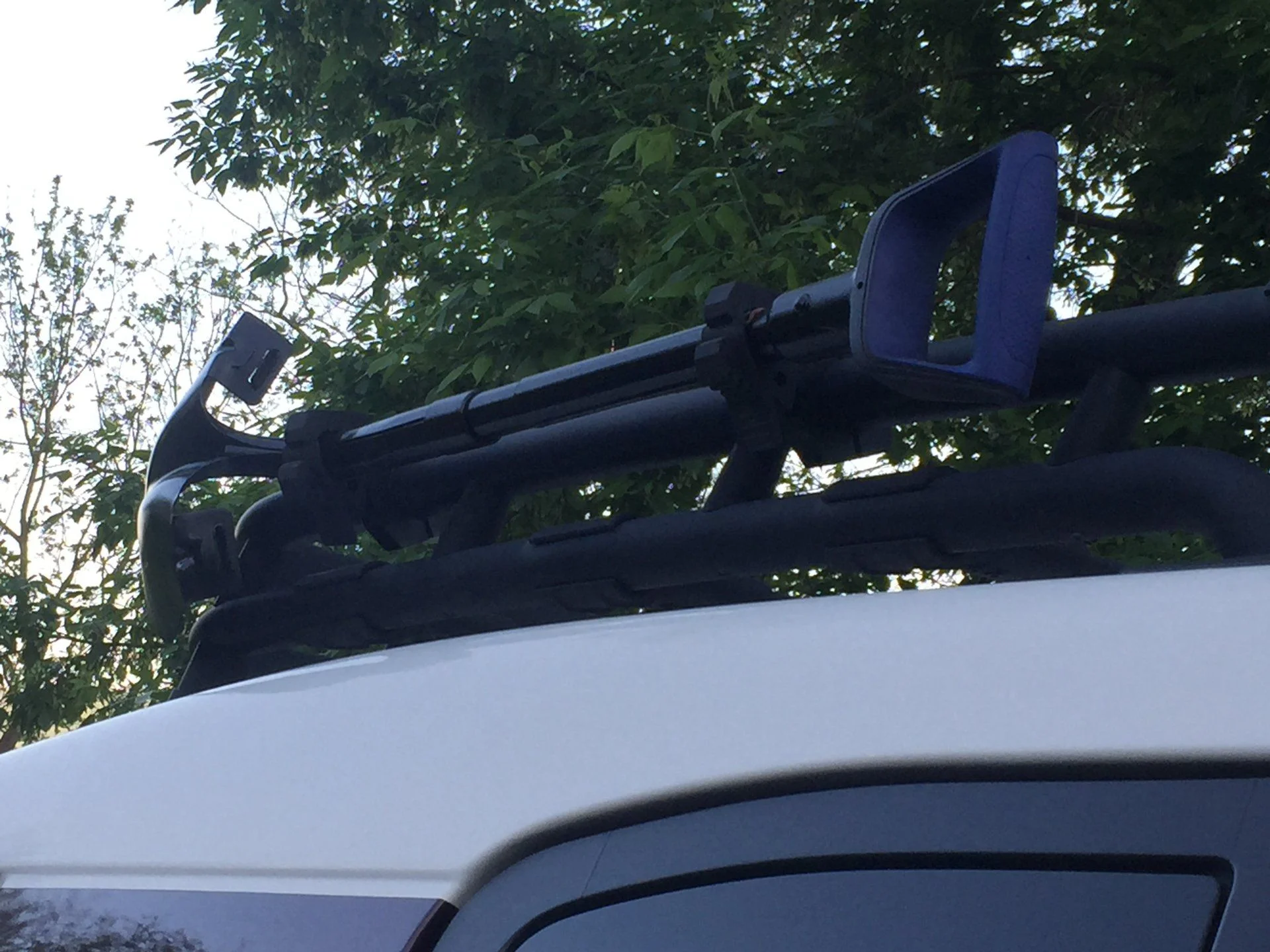

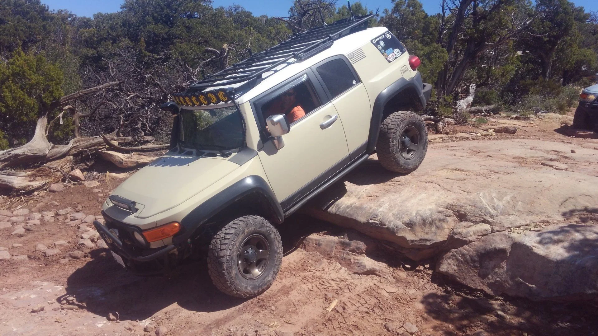

The big advantage I've found with the flat rake is hauling large items such as plywood or long items such as 2x4 lumber for home chores and then the low profile gets me in and out of the garage. When it comes to adventures you can see a flat rack gives you options since you can tie down to cross bars, rails and they all have other tie down loops. On this trip (two weeks and 1,000 miles) I put 2, 5 gal cans up top, a ratchet strap holds them in place (highway and trails). A hi-lift jack and a full size shovel stay put with Four-trek mounts an two sets of Maxtrax with a ratchet strap holding them in place. With no rails it is easy to get to items when I need them.
Nothing wrong with side rails... I've just found the flat BAJA flat rack is more versatile to my changing needs. But everyone is different in what they need or thinks looks good.

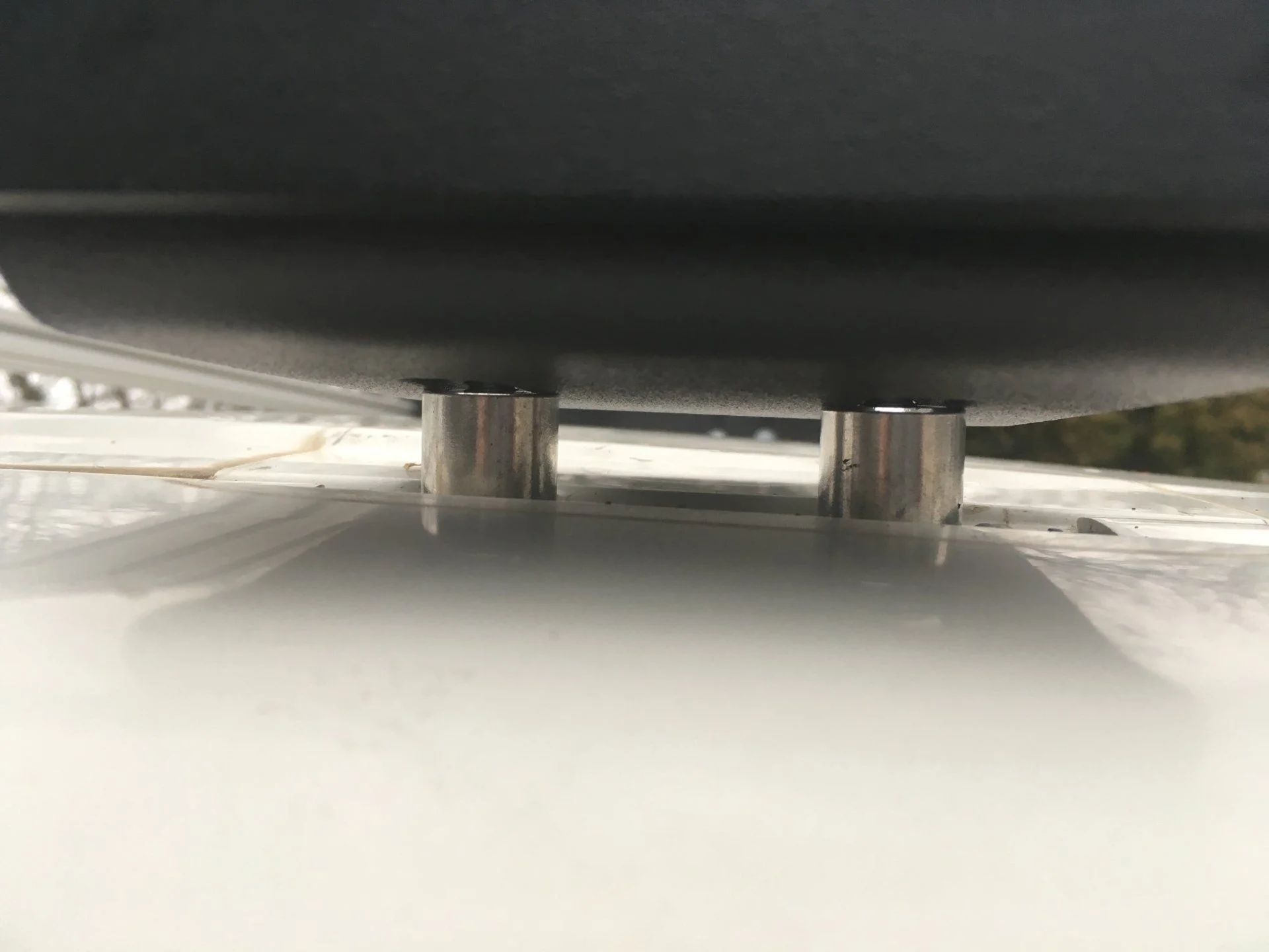

  • Provided spacers are too tall (cut mine down)

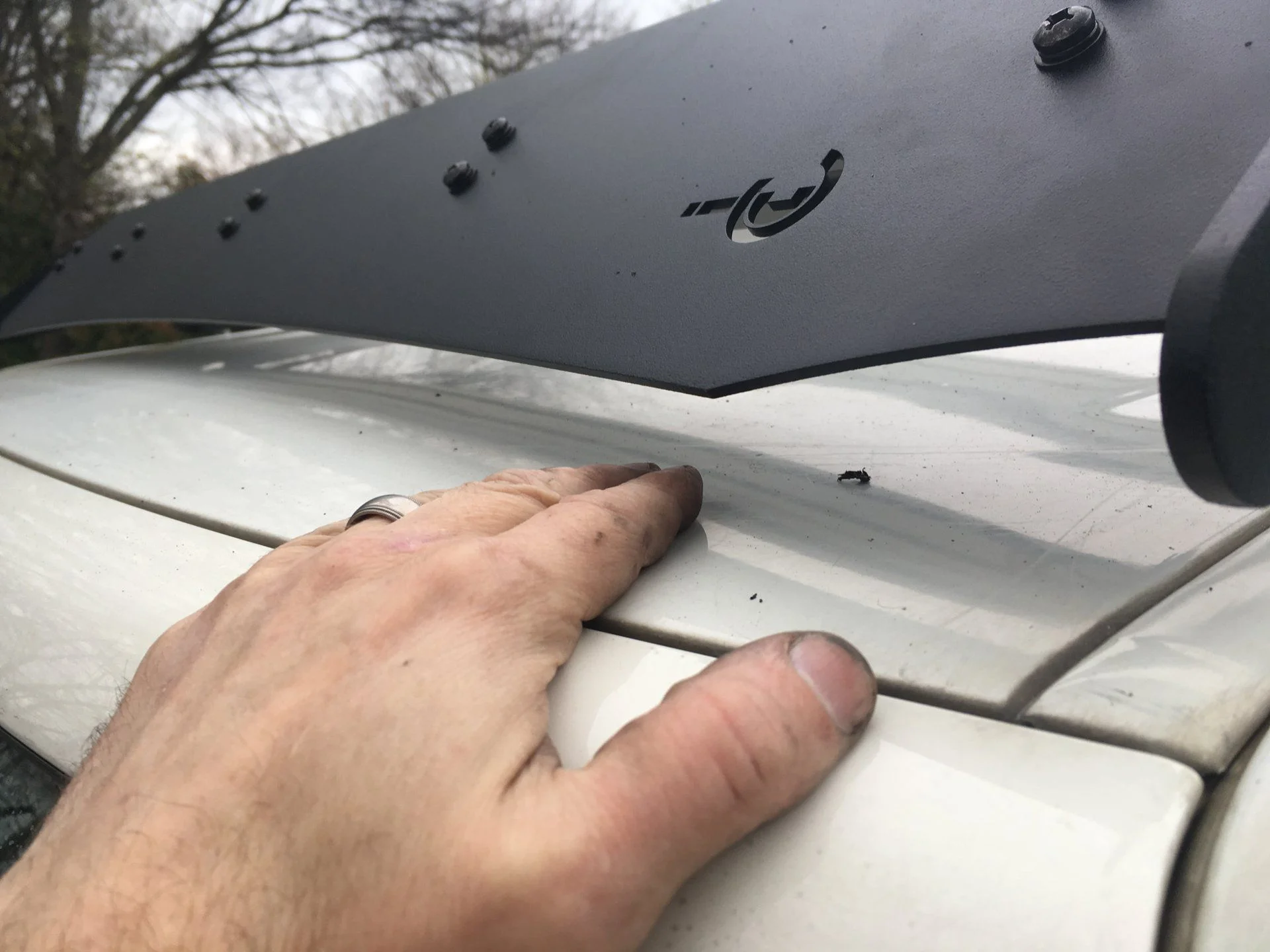

  • Air dam had too much gap below leading edge (modified mine)
  • Water jet/laser cut logos are dumb (they turn into whistles at speed)

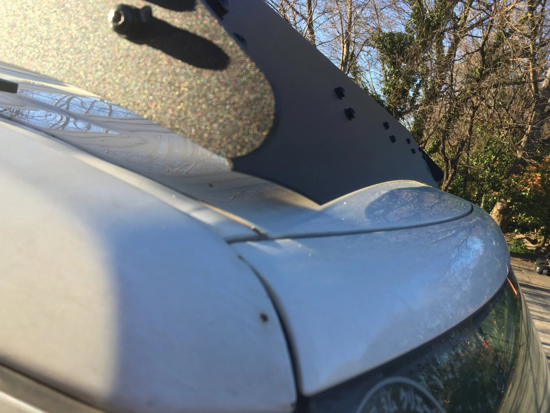

1902491
Air dam gap and whistle no. 1.

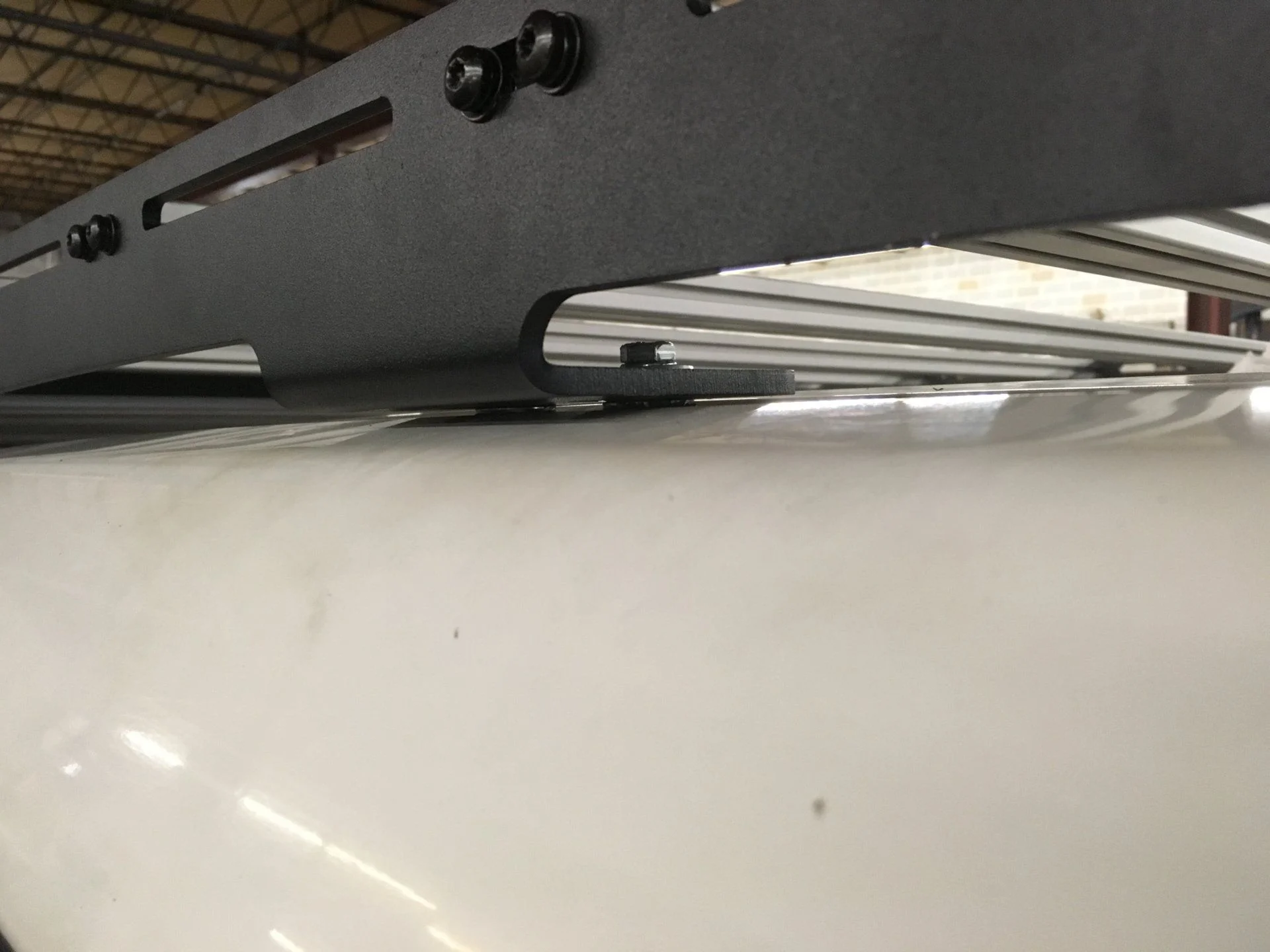

1902492
Original spacers sit about 5/8" above roof gutters. Washers that sit above them are too small on OD and too large on ID to be remotely usable.
