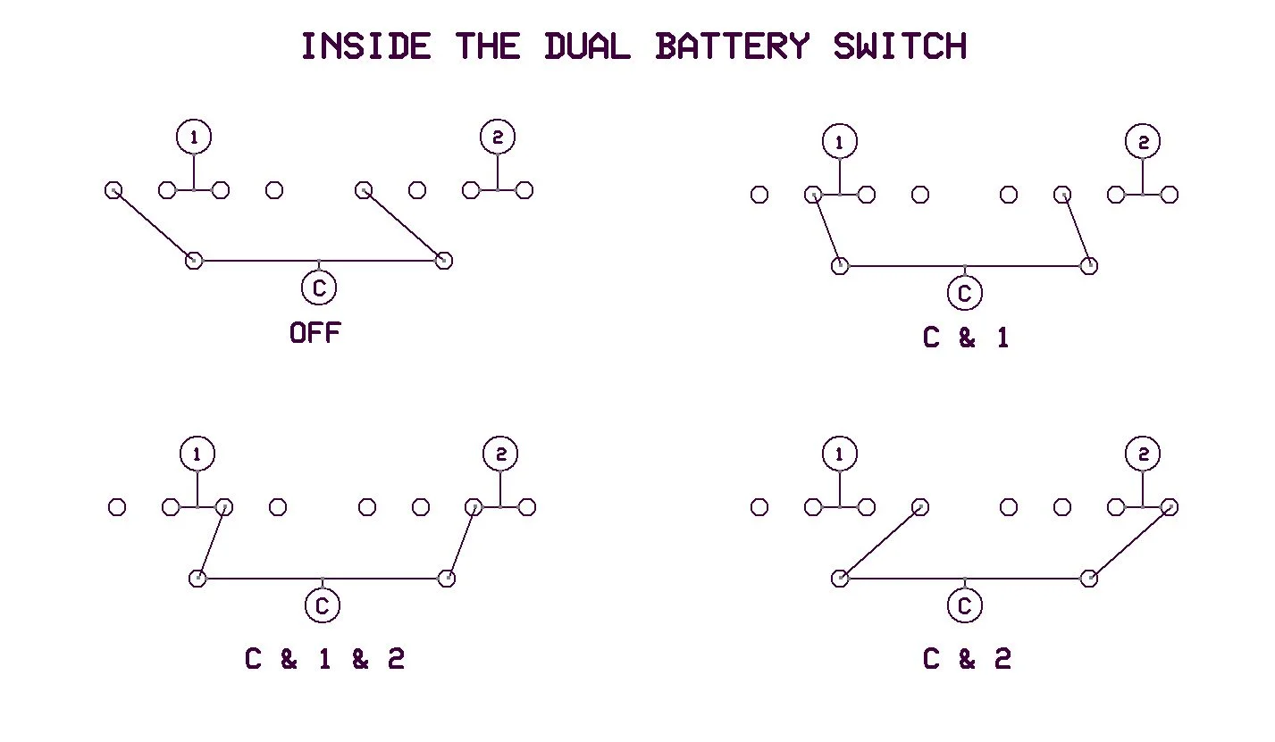

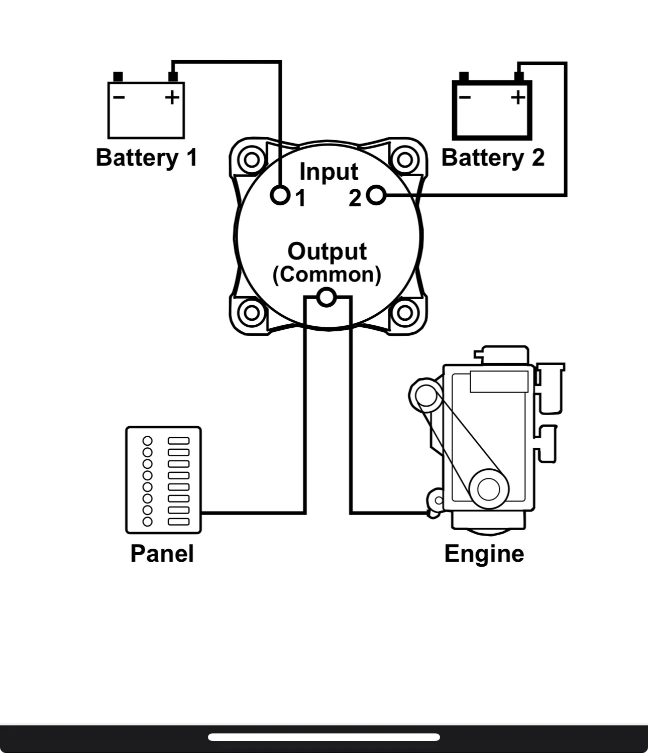

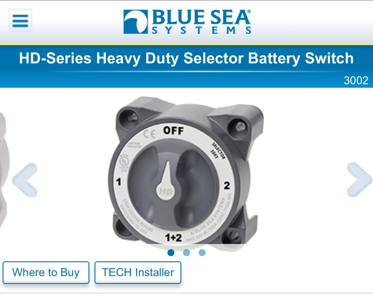

Is it possible to use this switch in reverse? Wire one battery to two outputs using the 1/2 input posts?
Example: Crank Battery to 1) winch and 2) Anderson plug for compressor or BCDC for 2nd battery
@NearJetties Hope this helps. It is just a fancy switch. Current can flow in either direction. The common post can be in or out.
Ugh! Now I'm hungry for an "In & Out" burger. ;)
Thank you! Super helpful. That’s what I thought but was unsure when they only showed this setup in the instructions.
