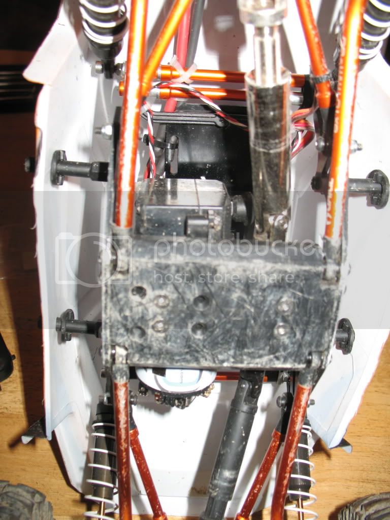

Modified stock chassis
CKRC skid plate
CKRC ax10 batt/servo plate
TCS rear uper link plate
JR DS8717 servo
Futaba FP-S31S servo (dig)
RC4WD R2D trans
Novak Super Rooster
Integy 35 turn motor
STRC Alumunum C's and Knuckles
Uinversal drives in front
Modified Traxxas big bore shocks
Axial bead locks
Airtronics MX-3 third channel modifed third channel
2 - Thunder Power 11.1v lipo batteries
Lipo cut off
Pro-Line Hammer tires (look like TSL SX) with memory foam
Since then I bought a 65t motor for it, but have yet to get it in.
I changed the shock oil to a lighter oil
I star cut the foam
and I installed a much better body.

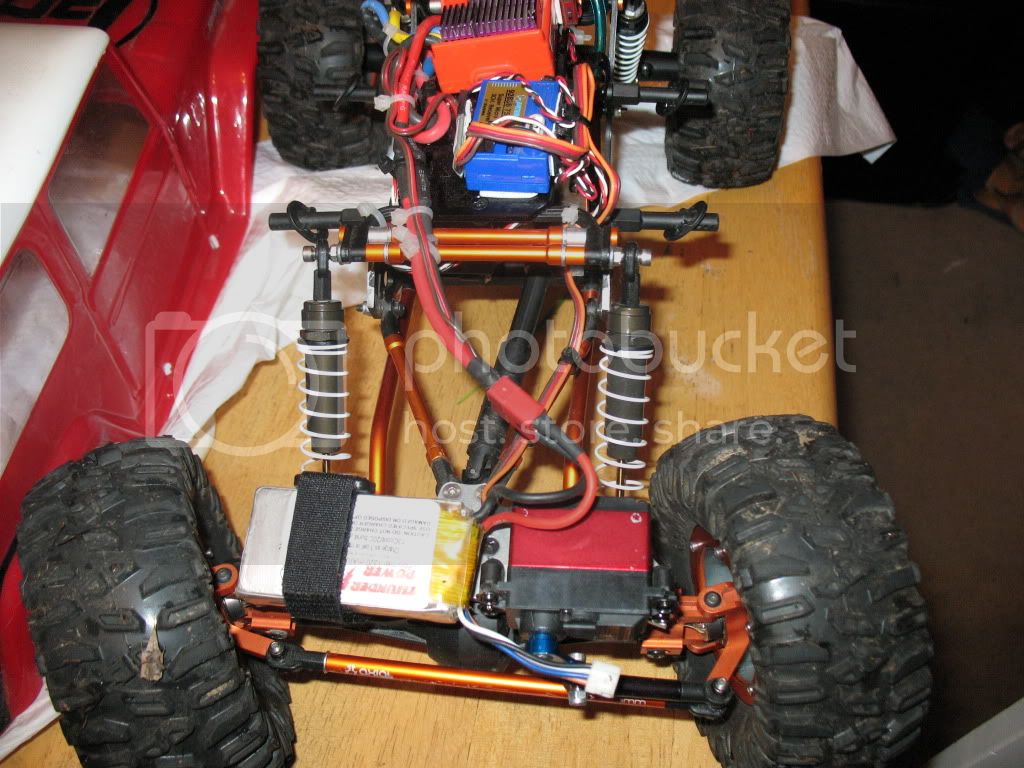

and what LiPo are you running? On the front axle? on my list, have the charger set for it, just need to decide what LiPo to spring for...
I've got the stock body for real rock climbing. The cruiser body is just for pimpin' :) It does help a lot with rearward endos. It just sits on the rear doors until I give it a dab of reverse.
The LiPos are Thunder Power 11.1v 1380mA. I'll get a pic of one sitting on the front axle mount. When you ditch the wedding to go to the HC hoedown you can check 'em out.

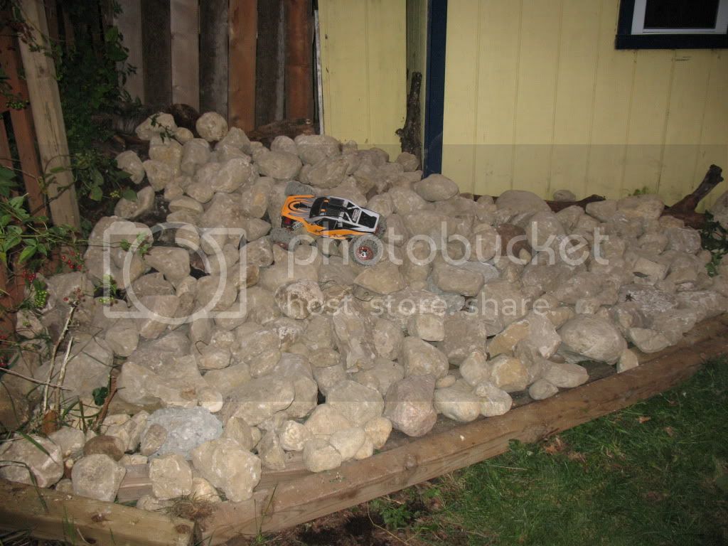

I think I have a source of a bunch of good rocks for the yard.
I'm still running NiMH sticks, strapped above the gearbox....works, but want to either do saddle-type lipo's on the front axle or the single offset like yours....
price wise, likely stick to the offset...

Here's a pic of the LiPo on the axle mount.
Score!
They are putting in artificial turf on the school football field and graded out a ton (literally) of rocks. They were planning on taking them away today, but I got there first. I have to spend my lunch loading the Tundra, but I got a free rock garden.
I might leave the 600 pounder.

A bed full of rocks for free. I had to skip lunch to load them, but now I don't have to go to the gym this afternoon.
Got em unloaded and thrown over the fence. I'd like to build up a corner or against a wall to get some height. The RC store has a platform underneath to get a mountainside about 5' tall. Makes for good climbs.
Right now it's just a pile the way they landed.
