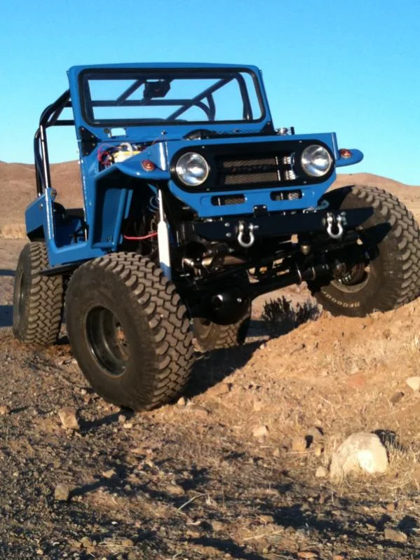

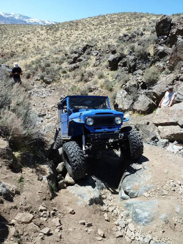

Are you going to make us go back and read the whole monster thread for details on your setup?
I found this with a google search though.
attachment.php
Edit: Find the original of this one and zoom in and bump the brightness.
attachment.php
Edit too: This one too:
https://forum.ih8mud.com/attachment.php?attachmentid=623947&stc=1&d=1335044212
