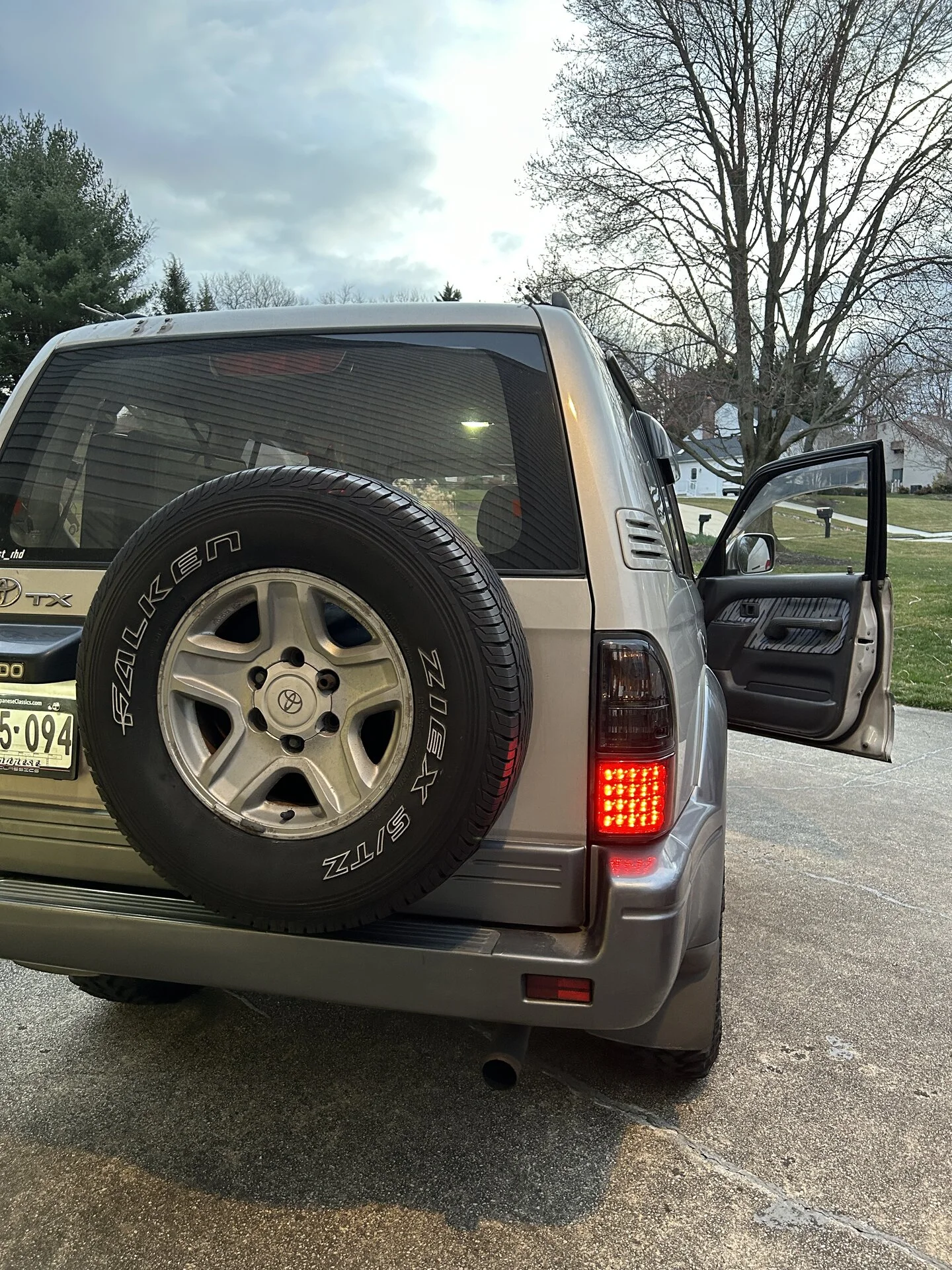

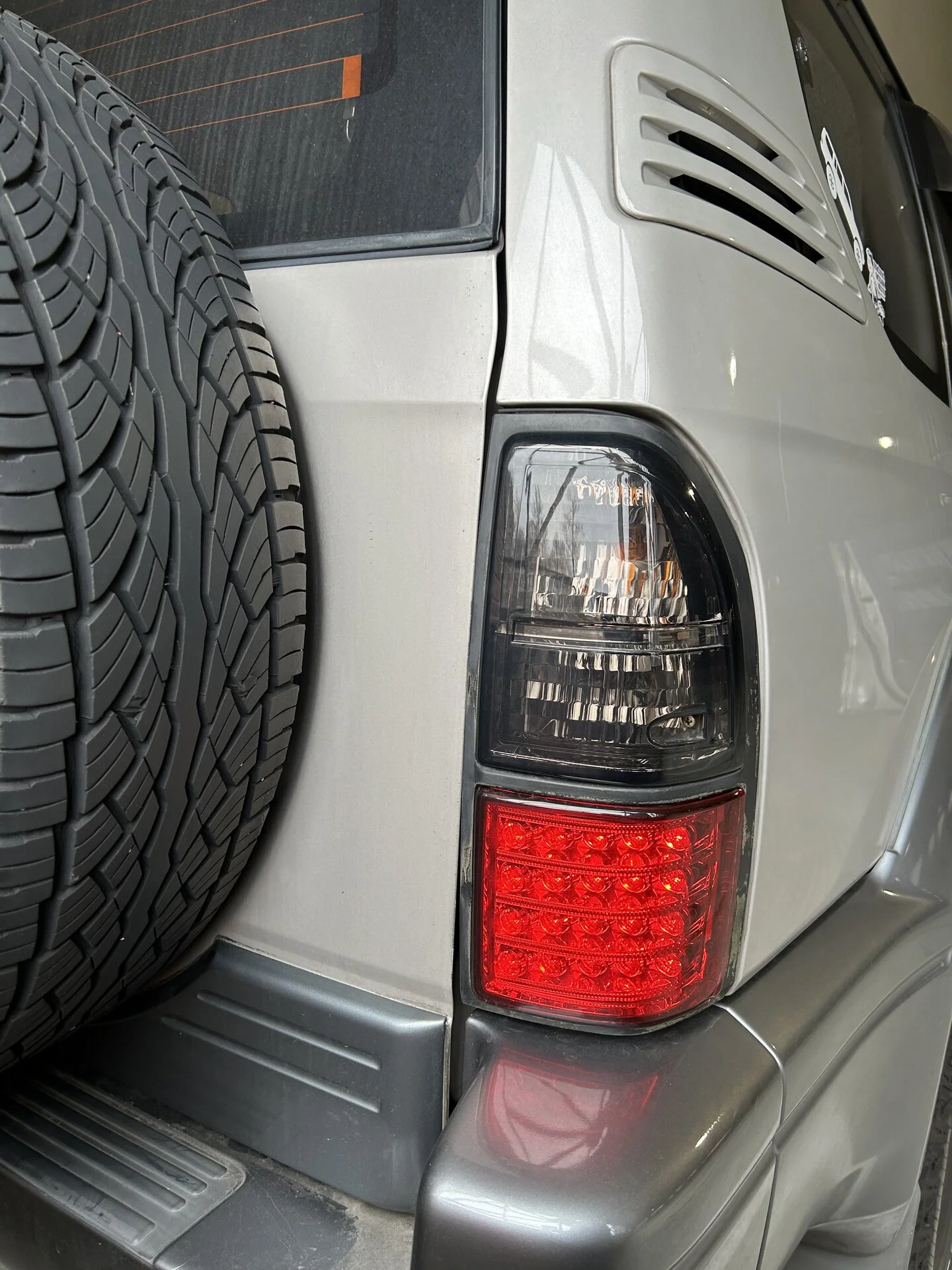

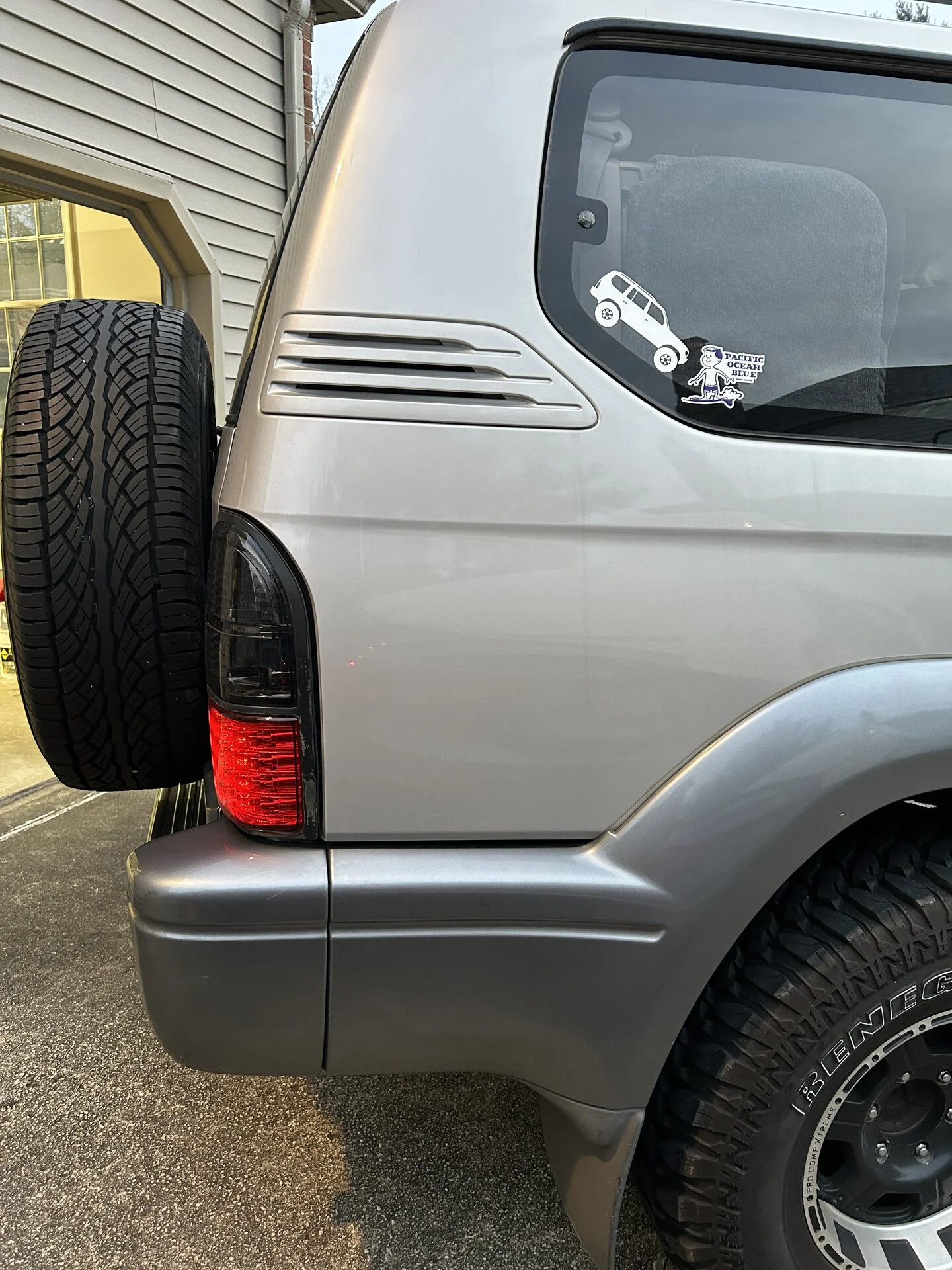

Tried to take my Prado through the DMV for inspection last Friday and got denied because my taillights "do not emit any lights from the side".. or so someone at the DMV argues.

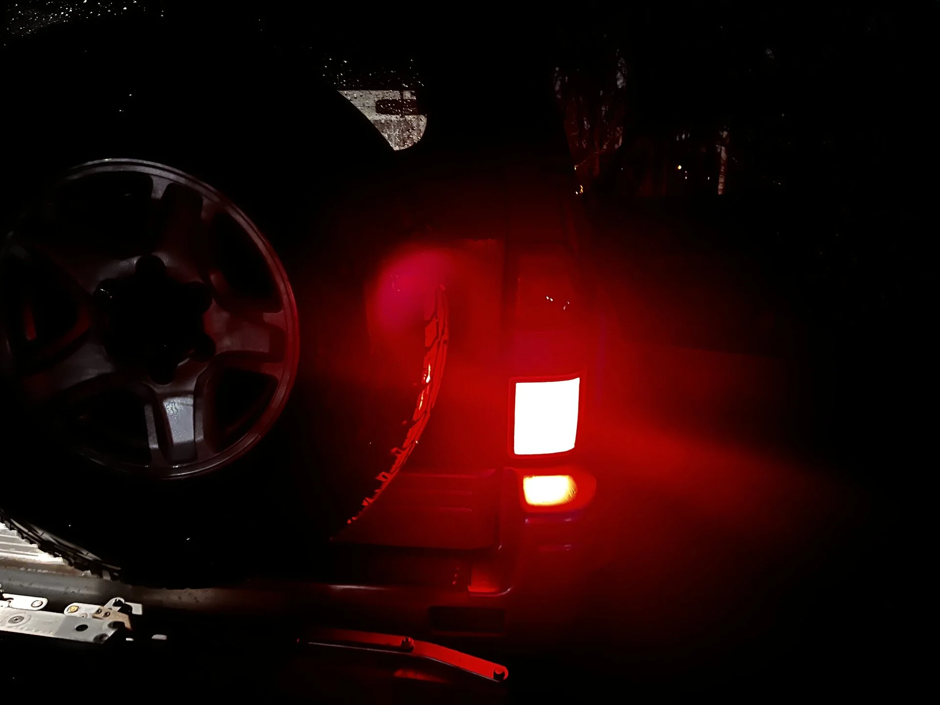

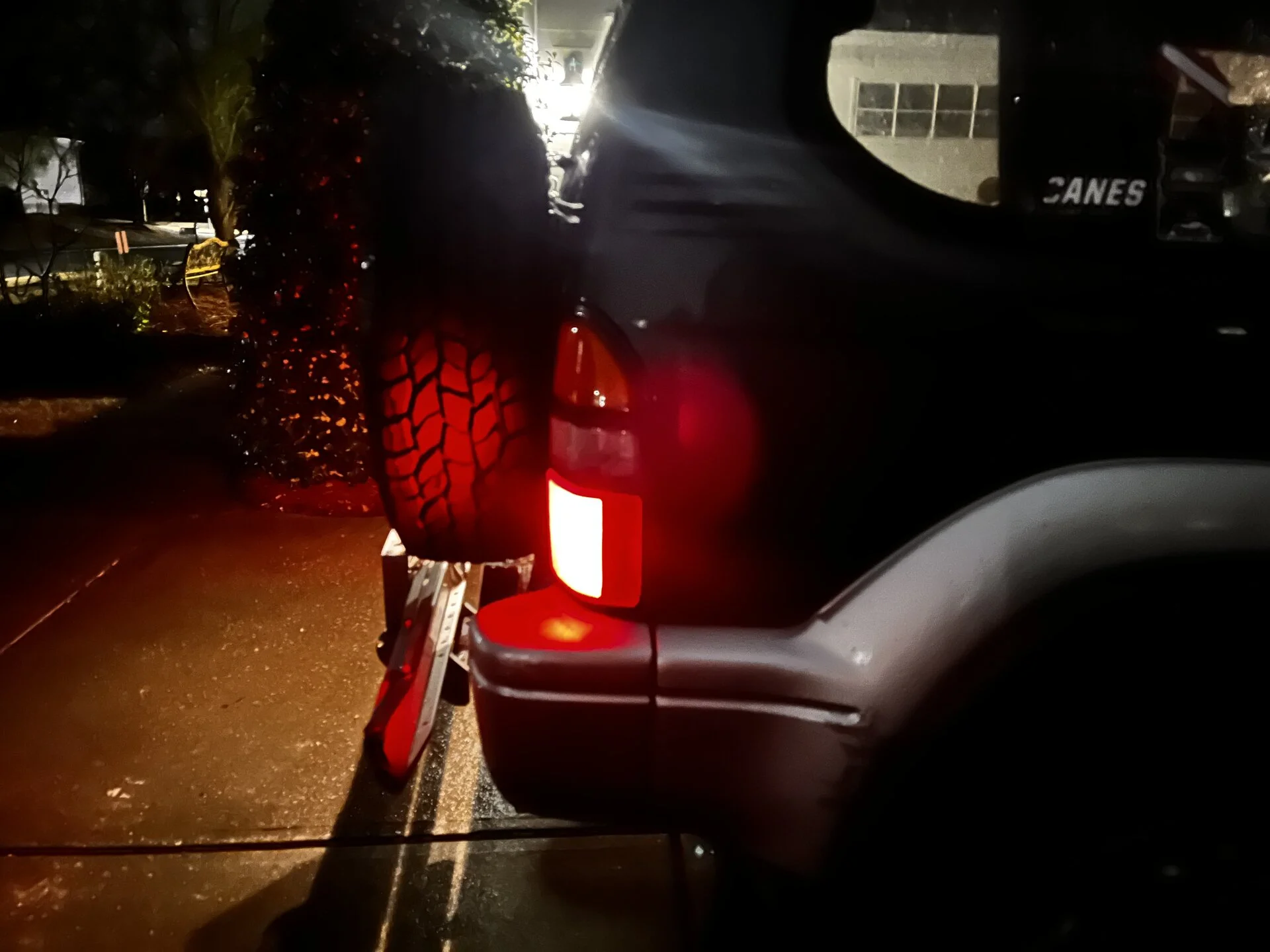

I've been searching for pictures of OEM taillights and other options, but can't find any at all.
Can some of you share some photos of your tail lights at night from the back and from the side?

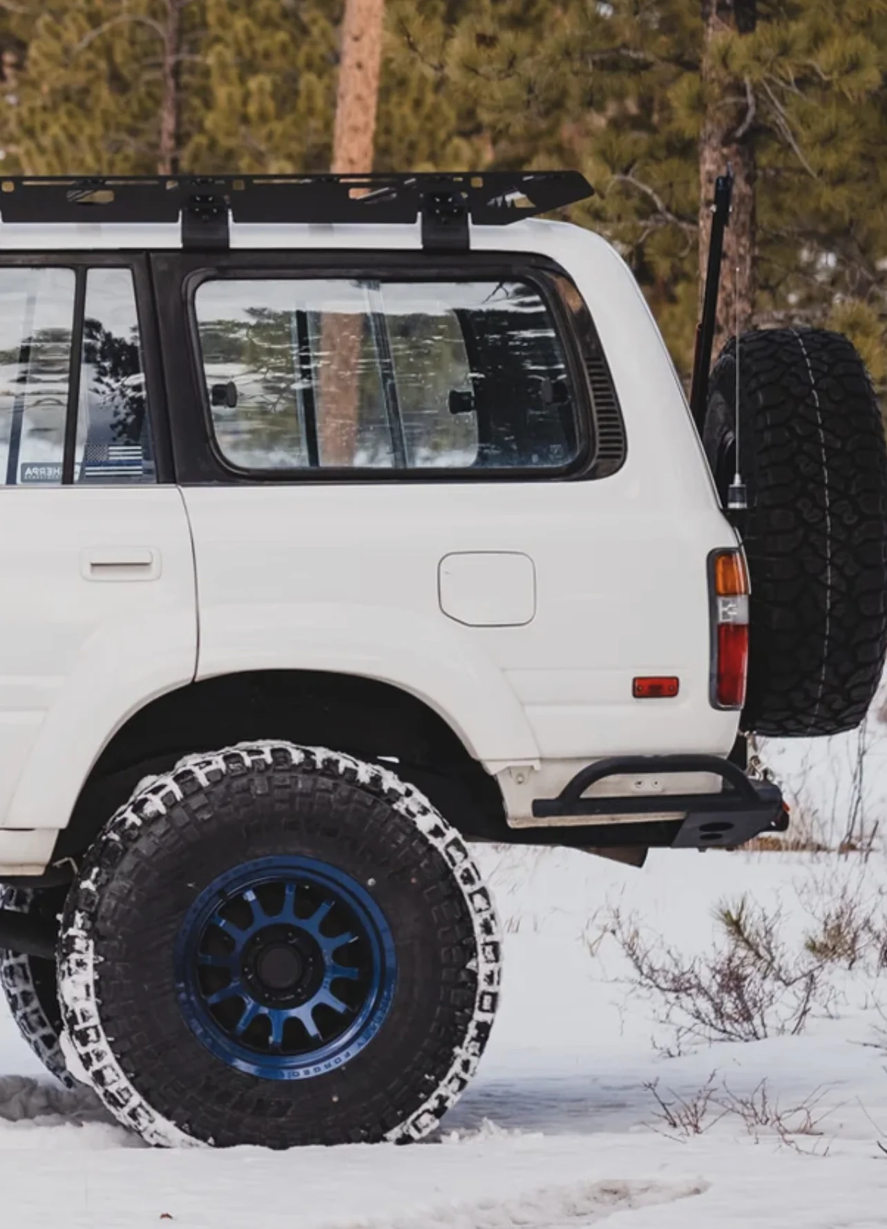

Since the taillights on my Prado are aftermarket, I'm wondering if the oem ones will meet the requirements.. If not, my other option is to install marker lights on both sides in the rear like the 80's have:

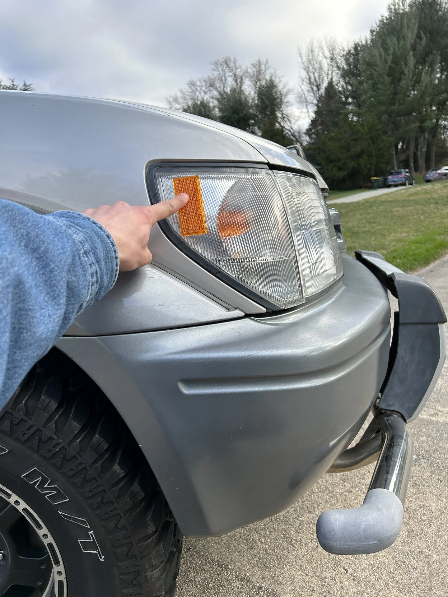

Also got knocked on having no reflectors in the head light corner lamps... Plan is to just stick on these reflectors with an adhesive tape and remove after inspection.. Though, I wouldn't mind having corner lamps with reflectors. No options out there available however

Yep. Only the front amber side reflector's would be put on using 3m double sided tape. The rears I would do legit, and use oem 80 side marker lights like these:
93 - 97 TOYOTA LAND CRUISER FZJ80 REAR LH + RH SIDE MARKER LIGHT SET OEM NEW 304626141957 | eBay - https://www.ebay.com/itm/164514921549?chn=ps&_trkparms=ispr%3D1&amdata=enc%3A1GQXhFXsMR4qp6OD0dxDL9w72&norover=1&mkevt=1&mkrid=711-117182-37290-0&mkcid=2&mkscid=101&itemid=164514921549&targetid=1644837434363&device=c&mktype=&googleloc=1014927&poi=&campaignid=16743749222&mkgroupid=138744546207&rlsatarget=pla-1644837434363&abcId=9300842&merchantid=6390954&gclid=Cj0KCQiA6rCgBhDVARIsAK1kGPLW2QDkSrJwl5iPVi5DZOiOkewe4sU015nA0Axf1wVteb4V7DqGHcQaAk8dEALw_wcB
But, Would love to see a couple side angle shots of oem tails at night to see if they would satisfy the requirement.. Can't find a single photo of a Prado at night!
