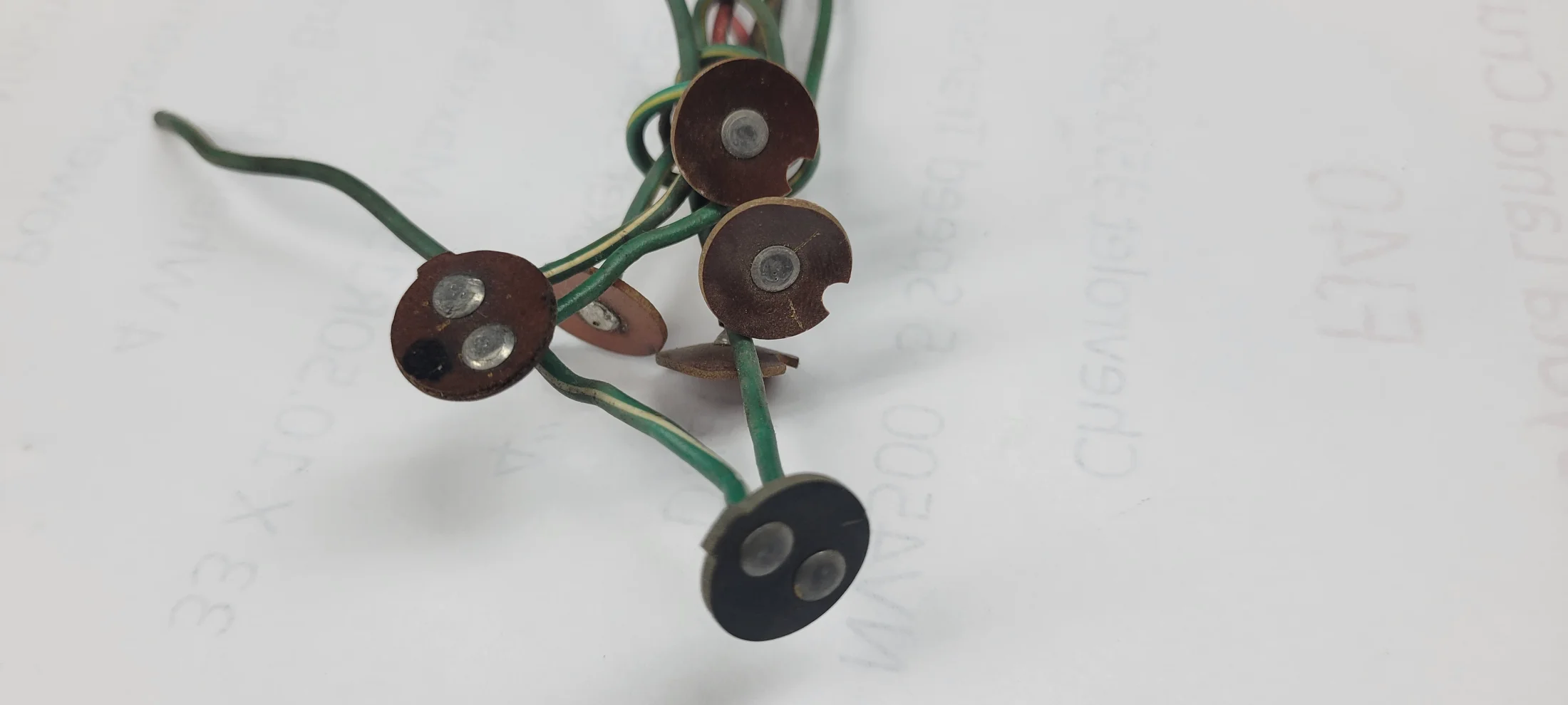

I need to replace this wire on my tail light that has since broke off. It's so close the socket that I don't think I can splice it. How do these sockets come apart?
Just push the wire and rubber plug towards the front where the bulb plugs in. Do you have a soldering iron?

The guts shown above have both 2 and single contacts.
Remove the bulb. Push wire out from the back side towards the bulb socket. De-solder the wire/s - attach new wire/s proper color code if you can. Poke it back threw - attach proper connecter if you can - put light bulb back in socket. Put the assembly back on the rig. Plug in wire - test the function.
