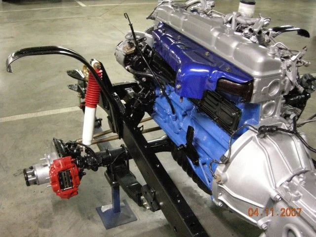

Hi, the tacho hooks up to this sender on the bellhouse. My motor is 2H, the same nearly as a 12HT but without the turbo. You will have the same bellhousing etc and the sender on the side is for the tacho.

Still, perhaps the harness could be attached to the existing tach; we will pursue this. Thanks for the photo - good looking engine.

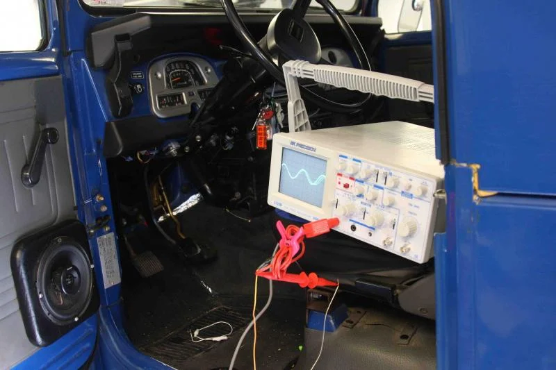

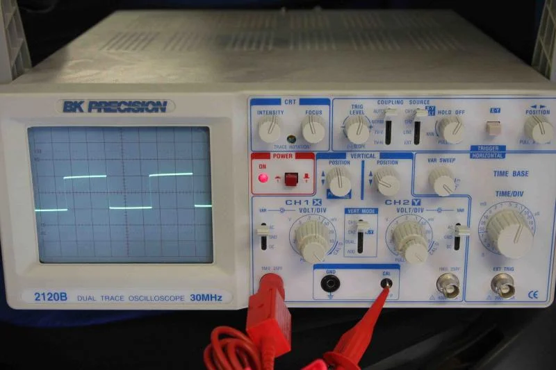

UPDATE : Sensor Tests!!!
Okay,
I just could NOT leave this subject alone! I spent 1/2 the night researching Hall Effect circuits and tachs.
I decided to move my scope and test leads to the flywheel sensor.
I don't have a tachometer installed yet.
My FJ40 has a 12HT with a factory 12HT bellhousing tach sensor installed.
I simply measured the sensor while the engine was off and then when it was running.
fwiw: The sinusoid frequency increases with engine speed.
Next step is to buy/borrow a cheap laser tach and measure frequency vs. rpm to determine what conditioning (divisor) needs to be done....
Does any of this info help anyone?
