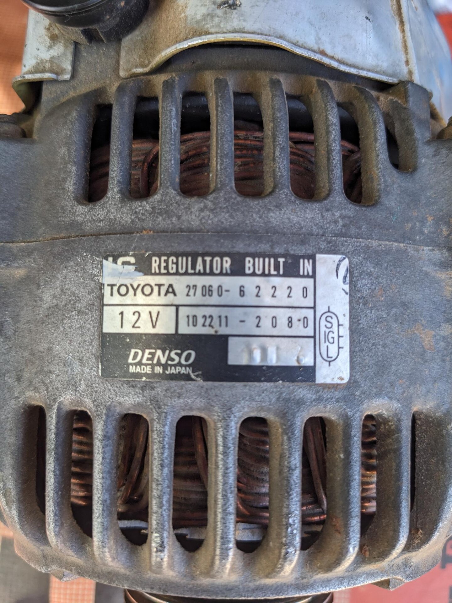

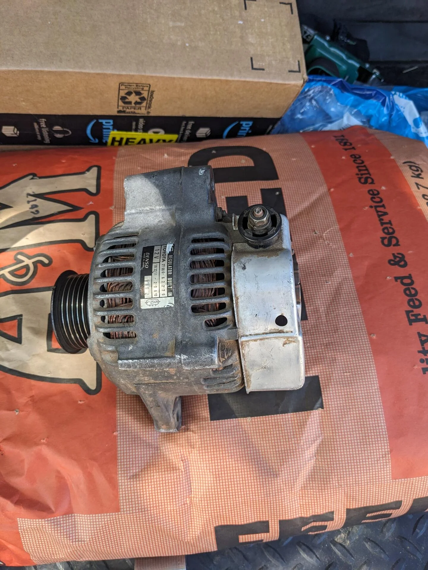

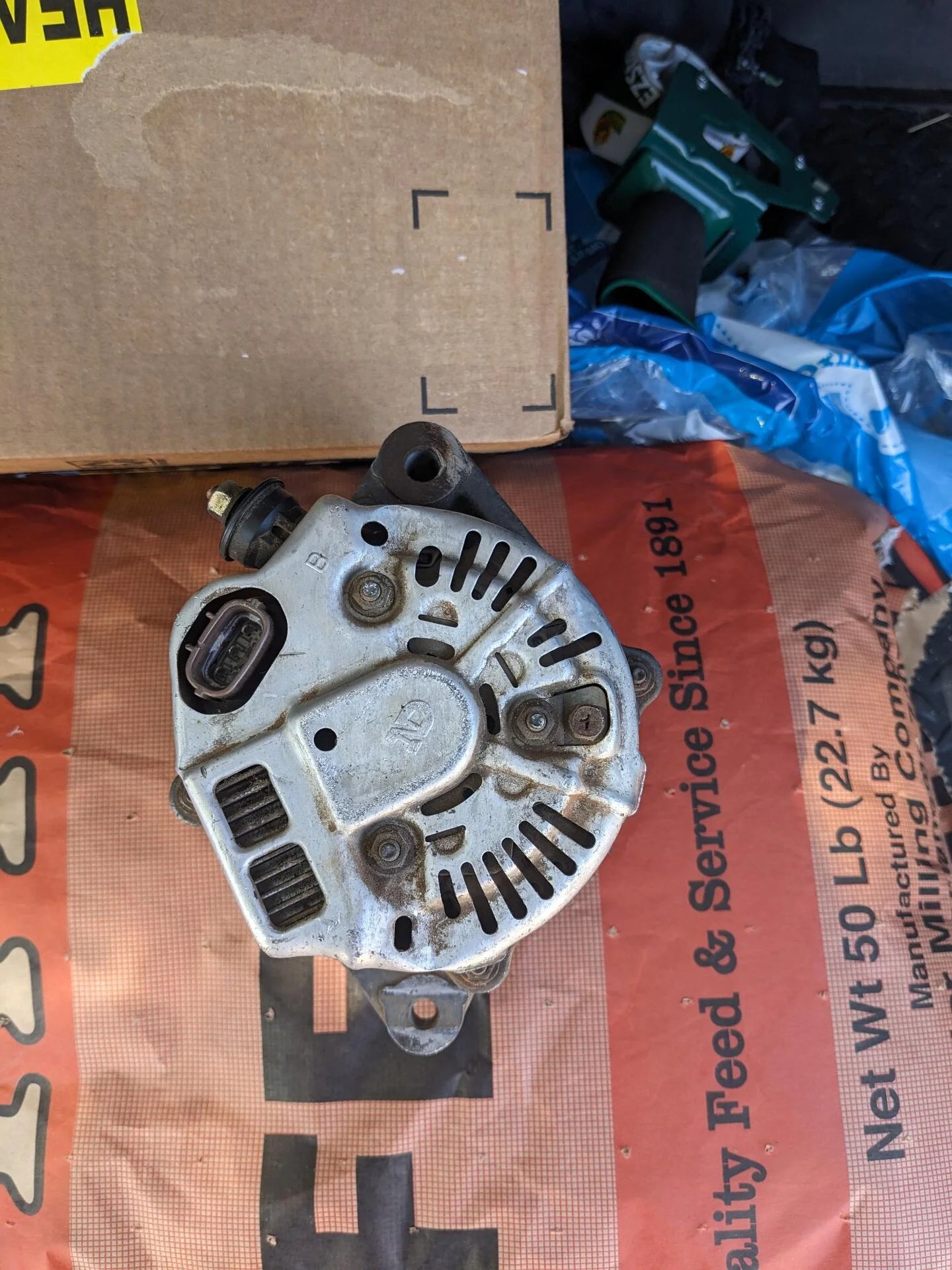

Just bought this truck, the alternator was not working so I ordered another.
I received a 4 groove, and different parts stores all showed the same alternator.
I googled around and think it is a 6 groove that goes on a 98 Landcruiser. Could this be a JDM truck?

the pulley shafts are different diameter
the old broke one is larger

i better planned out approach here might be to accurately conform and identify this incorrect 27060-622200, and find out what it is actually supposed to fit first ....

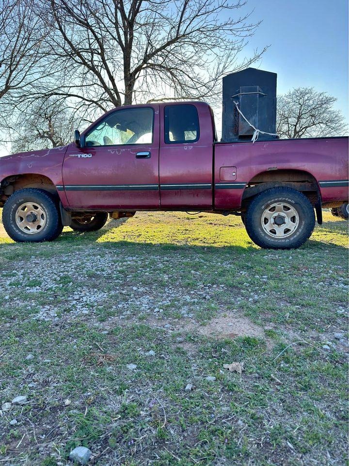

this combined with some supporting needed T-100 vehicle specific information , such as the Production Date on the Drivers side white door Jamb Decal
modle year on your glove box registration card
your exact engine family on the under hood DATA ID white decal , and also on the Emissions smog and routing diagram white decal too
ATM
or
MTM
3RZ-FE
or
3VZ-FE
or
5VZ-FE
this body style T-100 has a wild array of alternator choices and possibilities more then any single TOYOTA Vehicle modle body style production run
there was a rare 2WD in 96 ish ... that was NOT a pre-runner , but had the 4WD suspension under it , only came is the extra cab option
the maroon paint code you have was offered every single modle year 1992-1997 both in solid and a sparky 2 tone silver pewter below the rocker moldings ..

04/2000 TOYOTA GRAND HIACE VCH16W-PRSGK 27060-62220 That has a different clocked top tab slightly
, and the B+ plus ring terminals , also clocked out a same slightly , that uses a
27441-50050
does not belong on any 92-97 T-100 ...
how exactly does a 6-groove pully rotate the 27441- less grooves pully ?
do you have photos of how this all was set up ?
