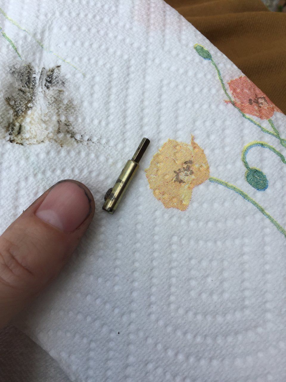

Also, I just learned the hard way:
If you take the sensor out and pull the gear assembly apart, make sure not to lose anything!
I changed mine today, and I swore I felt something fall out and hit my foot. I didn't see anything so I reinstalled the gear and clip, and replaced the O-ring. I put the unit back in, but the speedometer wouldn't work at all. After a bunch of reading and puzzling, I saw Slee's instructions for replacing the gear- it mentioned a square piece. I looked up and literally saw the piece laying on the ground near where I'd felt it hit my shoe earlier. Kind of a weird event!
Anyways, here's a picture of it- the end with the tooth goes into the keyed part of the gear shaft. Don't forget it!
