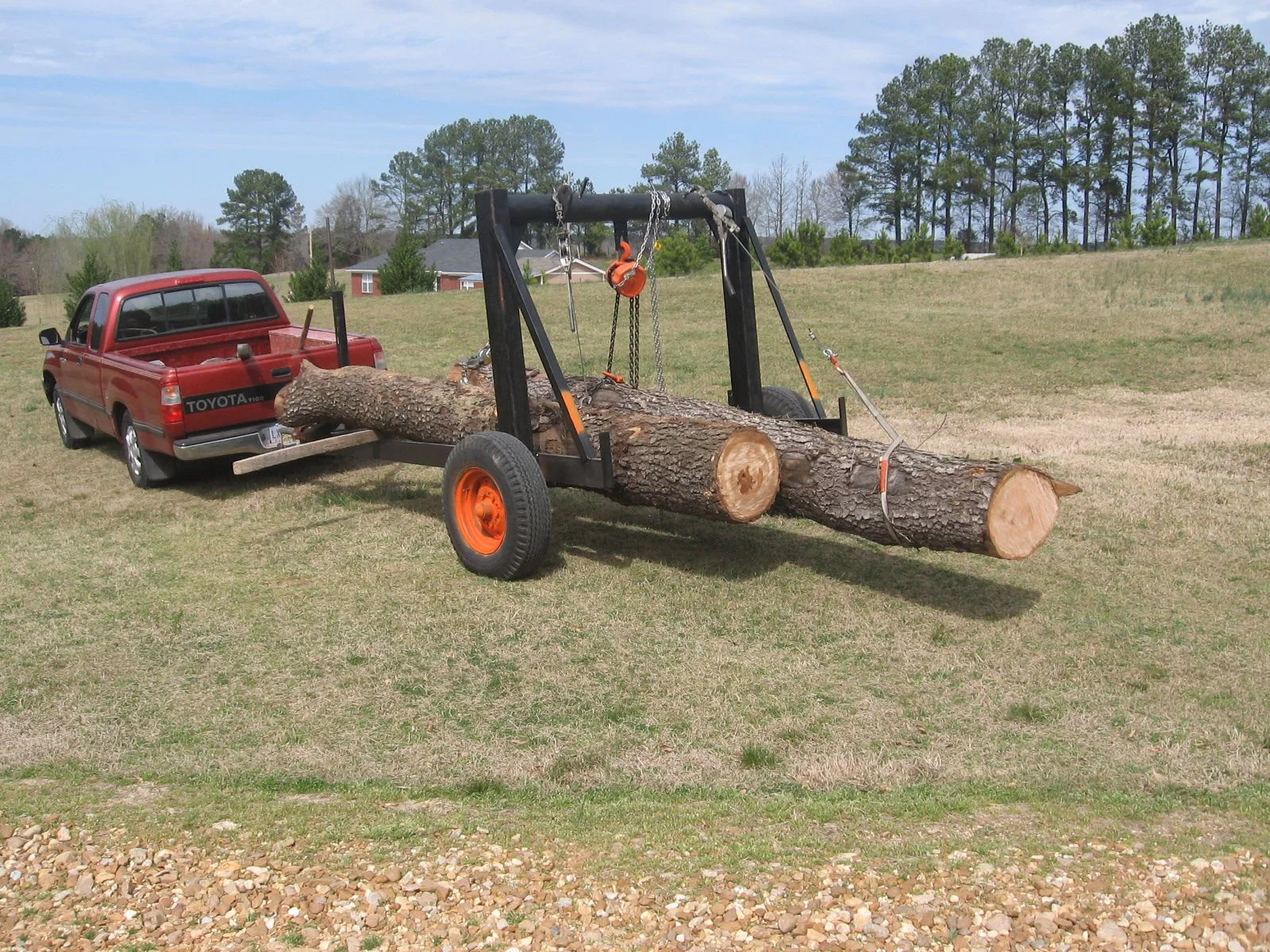

My T100 is a 1995 with 338,000 miles on it, original engine/auto. I tow with it regularly. I attached some photos but can't find any with my tractor in tow at this minute but I do haul several tractors with it. Not huge diesels but a 900 series Ford and a 4000 Ford and an 630 two cylinder John Deere and a 3020 John Deere. Just have to watch braking distance and slow down very slow and maybe use back roads a bit. Paul

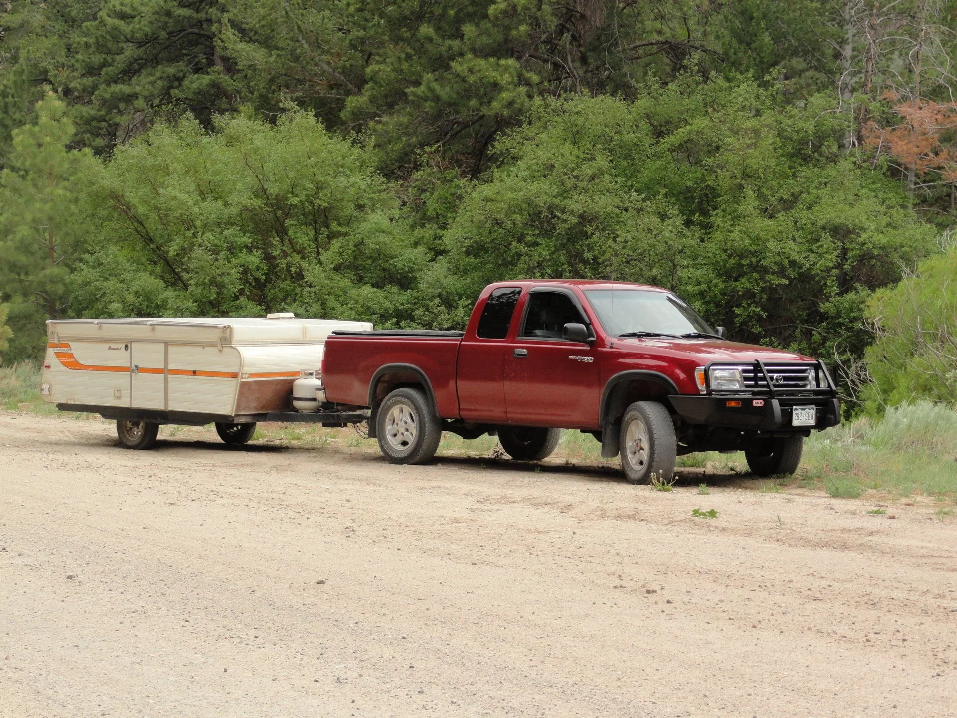

I have towed upwards of 6000 pounds with it for short hauls. We have a 20 foot camper we bought last summer. So far I have pulled it once with the T100, and will hook on to it tomorrow for another trip. Conversely, I have pulled the camper with our FZJ80 4 times, and it handled the trailer better. The 80 is heavier and has more power. I have added airbags to both trucks to help with the tongue weight. Trailer is 3500 pounds dry, so probably around 4000 loaded or better. We'll see how it does with the airbags on this trip. As mentioned above, 4th gear and high RPM's, the 80 series is running down the road the same way with the camper.
Towed an older Starcraft tent trailer with it quite a bit, again the FZJ80 handled it better too. The tent trailer was 2000-2400 pounds loaded and I still felt under-powered. I added brakes to that trailer so that long mountain passes would be less scary. Of course I'm in Colorado, so elevation and passes make driving different. Either way, on long descents, even in 2nd gear the 5VZFE just raps out and does not have enough displacement and compression braking to hold the load.

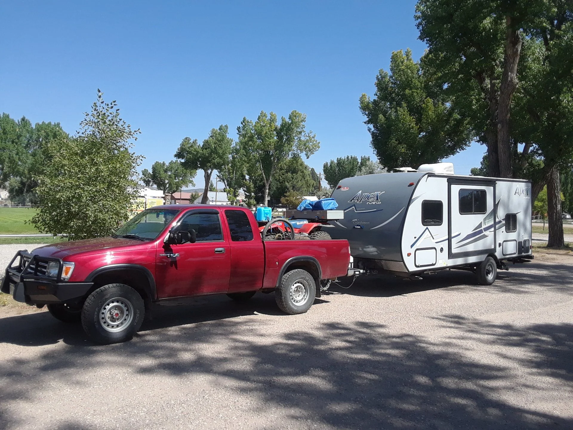

Meant to update this, spent a month camped out on a once in a lifetime hunting oppurtunity. Fortunately it was close to home, and I left the camper at camp most the time, but did drag it the 75 miles from home to camp and back on three occasions. Picture below was my trip back to camp halfway through the month, reloaded for another two weeks of camping. Actually had a close encounter with a Mtn Lion and then had to pull up camp and outrun a wildfire that week.
Truck has the gas tank full, 500 pounds of atv, three jerry cans of fuel, one jerry can of water and other misc stuff in the bed. Trailer was loaded with my needed camping gear, clothing, bow, backpack etc... propane grill, chairs, blocks, normal camper stuff. Two full 20lb propane bottles, 100lb of generator, full 30gal freshwater tank, plus 20 more gallons of water at front wall of camper. Fridge was full, and there was enough cangoods and other snacks stowed under the sink and seats to keep me alive for another week or so if the cold food was lost for some reason.
I can't guess the true trailer weight, close to 4000 plus pounds I'm sure. Tongue weight was whacked with the spare water under the bed in the forward compartments. Extra load in the bed of the truck was obviously a factor too. Had the air bags at 95PSI to get the load as level as it is in the picture. Overall it pulled pretty good. Strong cross winds were an issue at times. Headwinds on two trips knocked me to 2nd gear at times. Long grades were slow too. Braking was good though. Very happy with the way the airbags are leveling the load on this truck and the our FZJ80 and this camper.
Overall, the picture shows a lot of load on a T100, in the mountains, there is no way you could tow the rated 5000 pounds in a safe, sane manner on busy highways. My roads were pretty rural and empty, so I took my time.
On one trip out and back I noticed the brake controller was intermittently blinking like it lost connection. Figured out it was a bad spade in the trailer plug. Was very happy and surprised how well I was able to stop at the bottom of a long grade while trying to figure out why I didn't have any trailer brakes.

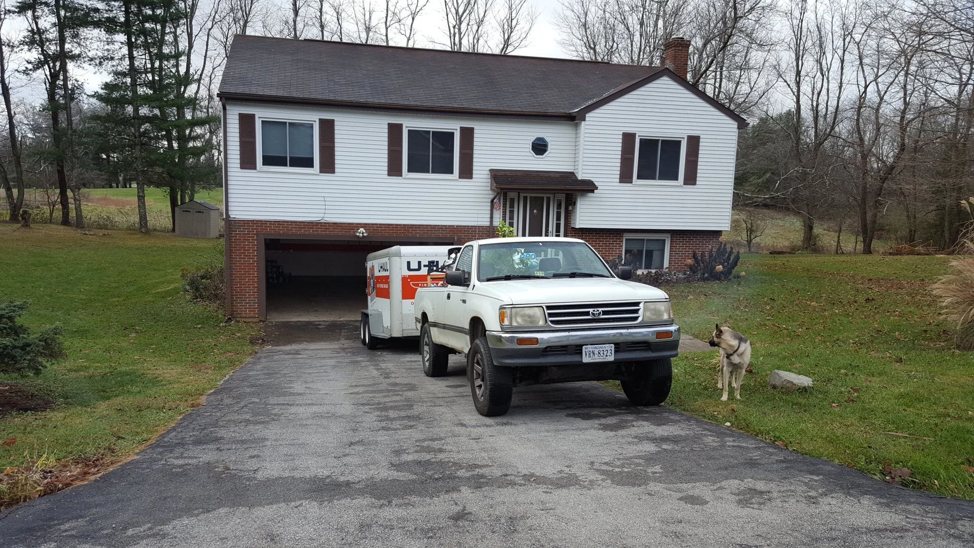

The engine isn't the same 3.0 anymore, but the rest of the truck handled the 12ft? (largest U-haul trailer they have) trailer pretty well. it'll never be as safe as a 3/4ton if you had to stop real quick in traffic...but it did the job and rode along just fine at 70mph. It's a manual so i certainly was using the gears to slow down, granted the brakes felt fine the entire time.
