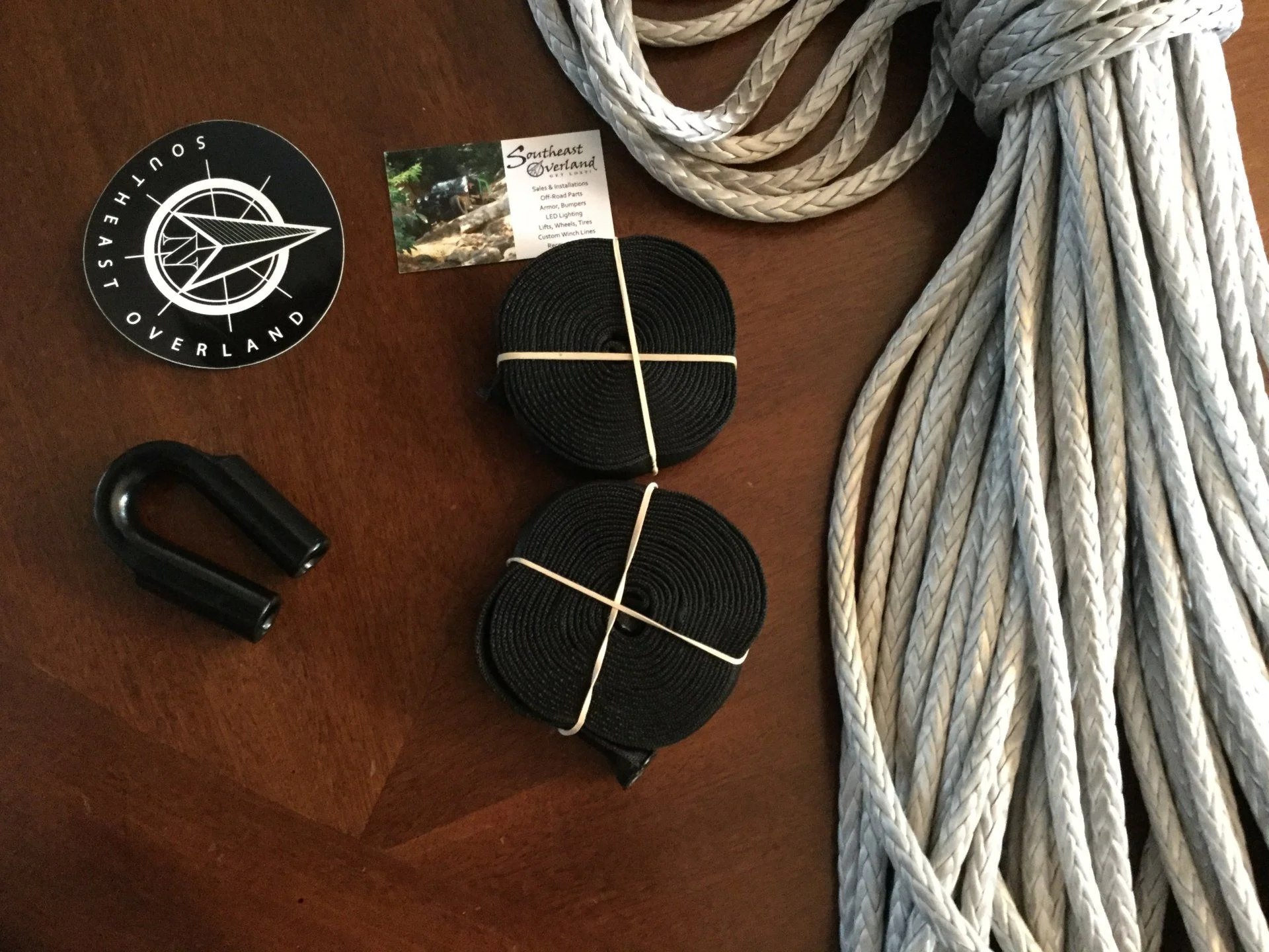

I bought some Amsteel Blue for a great price at West Marine, 100' 3/8" at $1.70/ft. Spliced it myself with fids, line covers and thimble from Southeast Overland.
I followed this video for splicing and it was pretty easy to do.
