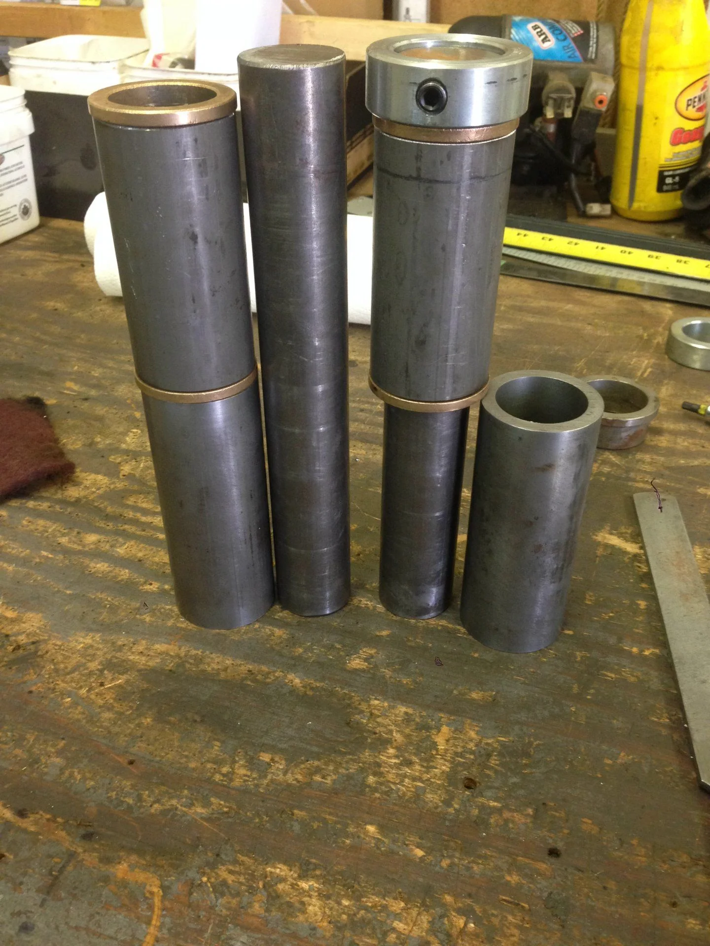

So 1 1/2" solid stock 10" long, 2 collars from Amazon, 2 bronze inner bushings with ID of 1 1/2" and
he used 1/8" DOM which you can source from Metal Supermarket.
I have a few. Made by Summit Machine in Utah. Very beefy, and runs tapered roller bearings (won't wear out like a bushing). $150.
