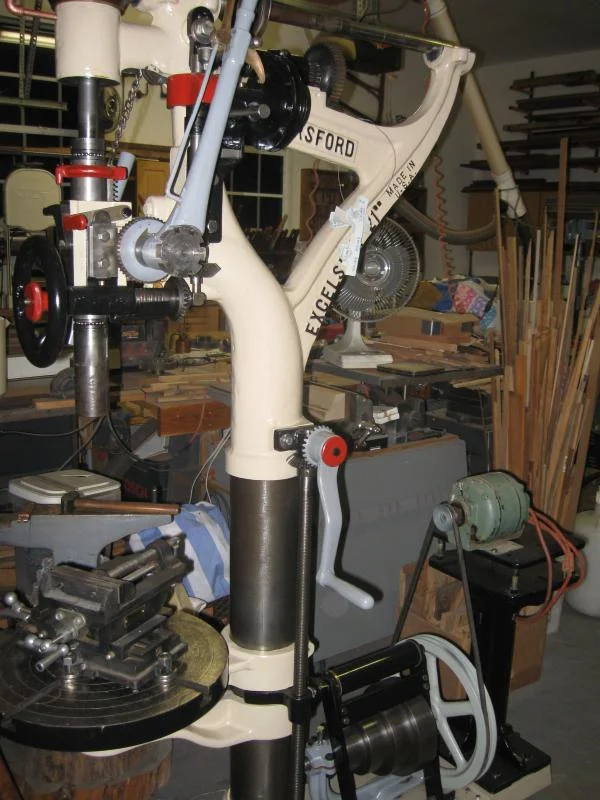

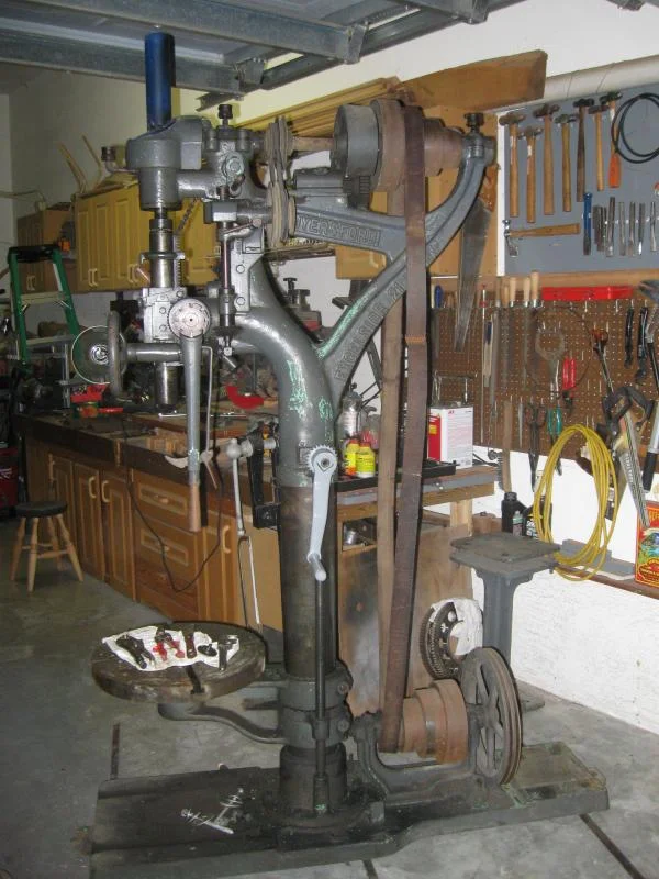

Here's a couple of pics of an old Royorsford Excelsior press-rescued from the scrap heap---

Sggoat,
That is a great looking drill press. I've never seen one like that.
How does it work, as far as drilling holes. I'd love to have something like that in my little collection.
Good Job!
The Royersford is currently underpowered. Originally powered by overhead belts, was adapted to electricity. The unit was used in a Generation utility machine shop in 1956. Had a 480V 3 phase motor on the rear stand. The drive needs to be at least 1.5 HP to run it. The one I have hooked up now is a small HP Singer industrial sewing machine motor with a clutch. Unfortunately, it's only 1/2 HP, and bogs down when driving the machine. With the original motor, you could drill pretty much anything--accepted #2 to #4 Morse Taper bits-all the way up to 2". There are 16 speeds to this beast(with the transfer gears at the top drill head)
The locking gears were missing teeth when I got it--surprisingly, Royersford Foundary is still in business(they make punches now, mainly) I was able to get the bad gears replaced from them--they actually had the gears in stock--the last ones they had. All they have left now is a couple of spring plates for the automatic quill stop and a ton of manuals.
This thing weighs a little under 1200#
I would like to find a decent motor to run this thing--it'll drill almost anything--I don't use it since I don't have the right power yet. I might entertain offers to buy, but I think the ship weight would pretty much turn off most folks. The real advantage of this thing is the slow speed and the power to drill through pretty much anything.(it's also kind of calming to hear the slap of the leather belts and the gnashing of gears while running). A 2 HP motor turning CW as you view it from the rear would help me a lot---got one?

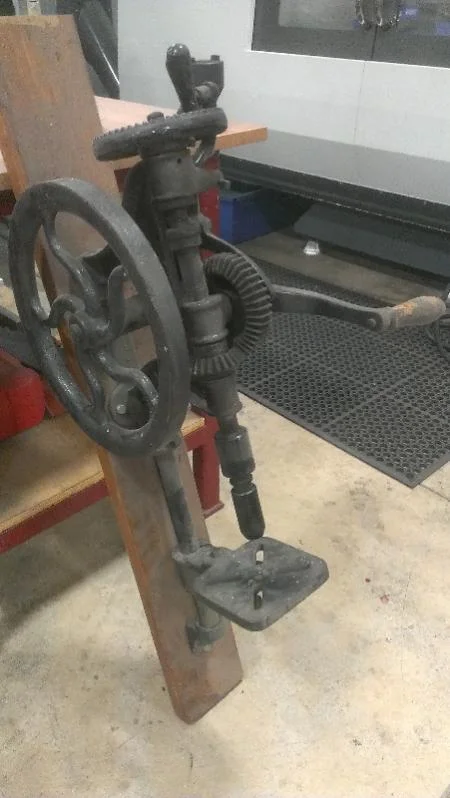

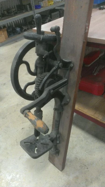

That is an old one. I've been looking at one like that, just for fun, but it's missing some parts. If you're going to get rid of it, let me know.
I brought it to the shop I work at for display, but we haven't figured out where to hang it. One jaw is broken in the chuck, I might make a new one.
