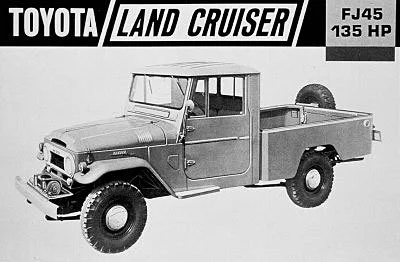

I saw this SWB fixed top . On this pic the Wheel base look more like the fj45 LWB is there 3 models of fj45 pick up ?
A LWB frame with a short bed on it ?
The tire is in the middle of the bed .....
61_toyota_fjcruiser_b-jpg.199698
There are 3 models. Swb fixed top and swb removable top which share a frame and lwb removable top an lv which share a frame
And two tire carriers on swb. One under In middle and one on back
The lv, fixed top, and the swb removable top all share the same 104 inch wheelbase. The lpb lwb is on 116 wb. The pic above looks like the rear wheel is centered but its not.
Ahh. My bad. No coffee yet.
They fixed top cab is shorter by about 2 inches and they made up for the difference in the bed length. A few years ago I was lucky to have both versions and did some quick measuring. The fixed beds also got more support pieces along the inside which created a rust nightmare, water would collect inside the square tubing and rot from the inside out.

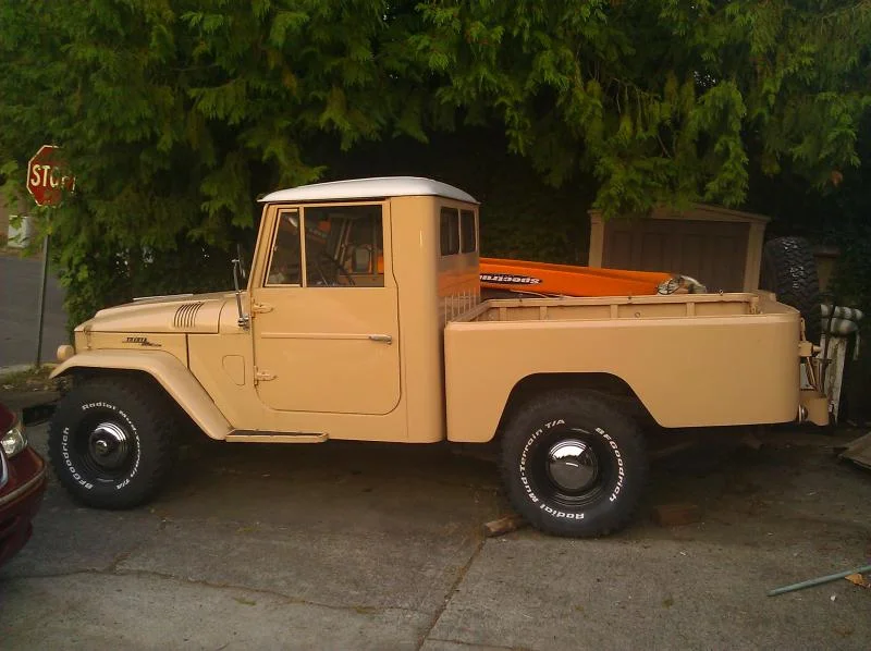

Yeah that picture is wrong. Try this:
So i think too that this pic is wrong !
