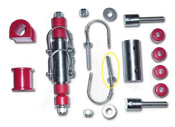

I'm concerned with the front quick disconnect linked in the post above. In a load situation, the cotter pin is sheared, but it's not a large diameter and therefore not very strong. It's my understanding that the sway bar prevents roll over in high-speed swerve situations. I wouldn't want to risk roll over because my quick disonnect isn't strong.
There are some threads out there about a stainless quick disconnect manufactured by Persson (http://www.4x4wire.com/toyota/reviews/persson/) that is a much stronger design, however, I don't think they make these anymore.
I've found somthing simlar to the Persson at front range off road (http://frontrangeoffroadfab.com/nfo...id=52&osCsid=cdc14e5d97bb911aba00717bd09802d0) . These are not for Land Cruisers, but I think they will work and they claim they will make custom lengths. I tried to order a set for my FJ60 a couple of years ago, but after a few call backs, with promises of "they'll ship next week", I gave up. Maybe we need to try again...
I don't see much difference in those front disconnects and the ones in the link above:
Yeah, I guess I don't know. The home built one looks like the hair pin is maybe 1/8" diameter, at best. That's not very thick. The FROR uses a clevis pin that looks to be larger in diameter (see circle below). I imagine that it is 1/4" diameter, but it might be smaller. I'm not a mechanical engineer, but double the diameter is four times the area, which is four times the strength?
