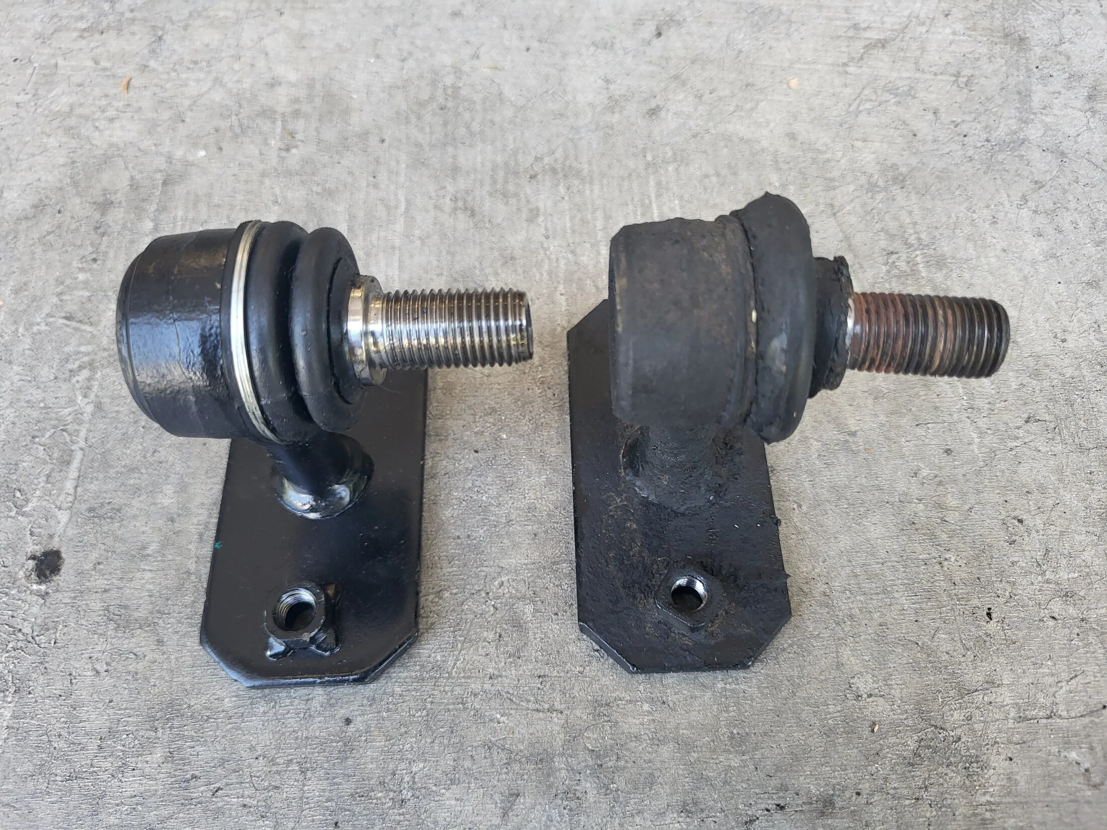

Here is a pic of the new vs old. I reused the washers.
On install, the stud will just spin in the fitting/mount on the frame and it will never get tight. That is the purpose of the allenhead approach. Once it is snug, then you can put the allen wrench away and tighten it down with a socket of box end or whatever you chose without further rotation.
