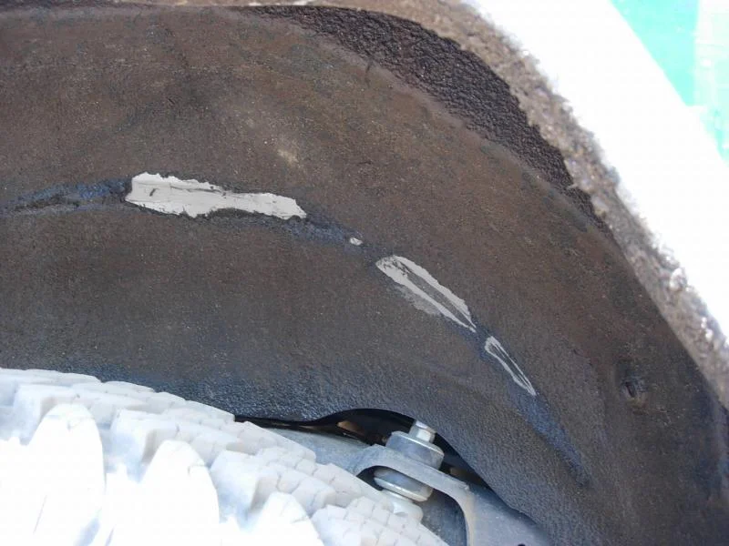

My Sway away is adjustable starts at 3" and can go past 6" it appears. With the 3" lift I've got my Toyo 33's still rub in both wheel wells.
