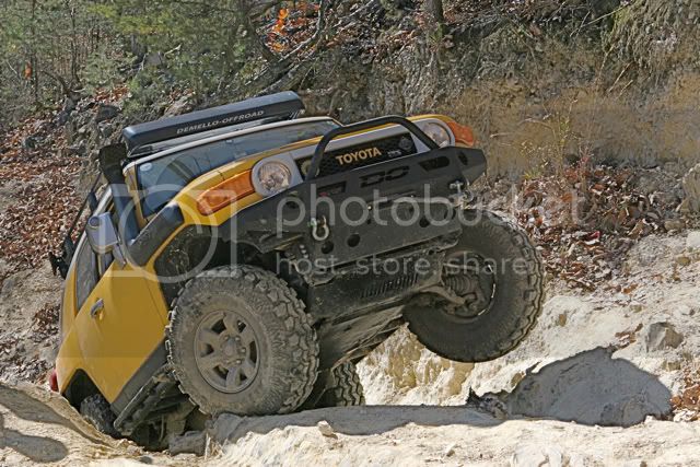

You don't need a 6" lift in order to fit 35" tires and it doesn't take more than doing a body mount chop to do it. At least for my size tire (35X10.50X16), I ran them with OME 886/895 and ICON's now in front instead of the OME 886's...
attachment.php
Stuffed in the rear, clearing the fender w/o problem...
