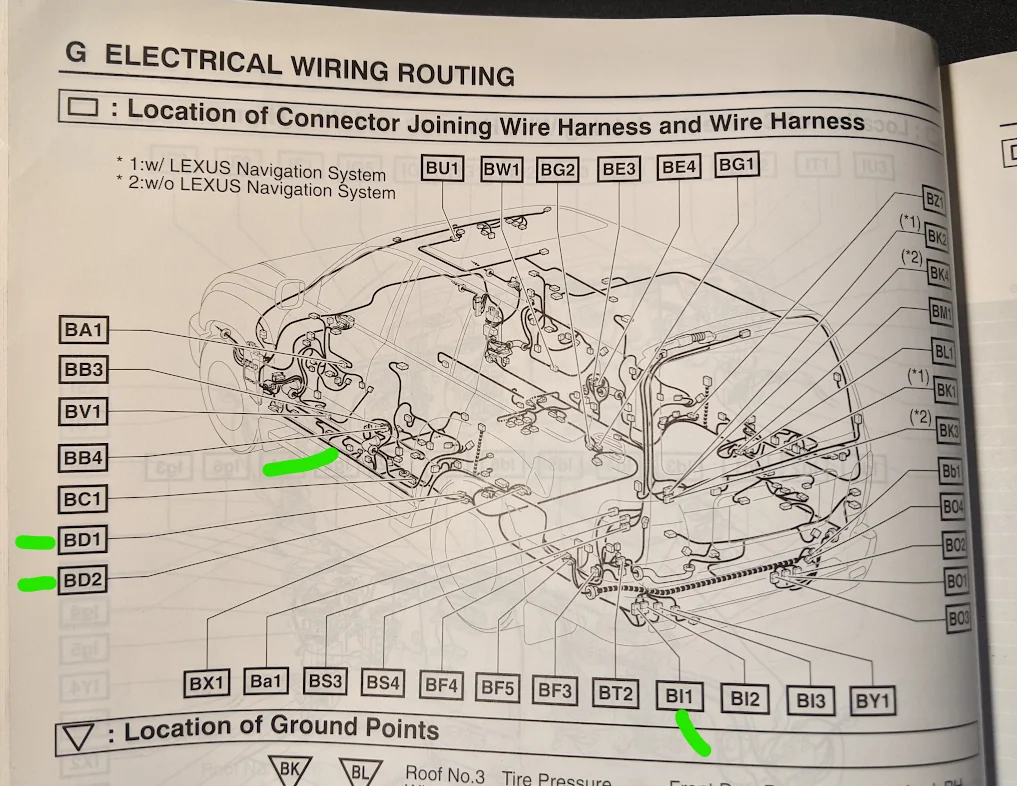

I was able to take a look at this vehicle today in the Air Down Gear Up shop. Here's the scoop as far as we know right now.
1. AHC off blinking constantly. Car physically sits in a roughly regular N height and N light is lit solid.
2. Two trouble codes for AHC: C1736 (Accum Solenoid Circuit) and C1764 (Oil Pressure Abnormality due to not Opening Accum Valve). B+ indication at AHC ECU via Techstream shows 1-10V. Upon removing AHC Main Relay entirely, Techstream still shows 1-10V even though it was verified to be 0.0X V. Silly Techstream. Word to the wise, any voltage shown for B+ in the AHC menu below ~11V may just mean there's no voltage at all.
3. Accumulator solenoid shows good resistance (<10 ohms) at the accumulator connector.
4. Accumulator wiring from AHC ECU shows very, very high resistance (5-25 MOhms). I interpret this as an open - likely a smashed/eroded/corroded wire with both ends poorly contacting ground (frame/body) on wires SLAC and/or SLB.
5. Chasing down the wire harness I narrowed the short to ground (and presumed open circuit) between BI1, BD2 and BD1. Unfortunately, most the wire between these connectors is right on top of the frame rail and essentially inaccessible without lifting the body off the frame.
Potential resolution: Depin the suspect wires from BI1 and run new wire to the Accumulator and Control Valve. This would avoid having to find the actual fault and just bypass the entire harness. Didn't bring my wiring tools/parts with me today so didn't try this today.
Other faults may exist, but an open in that one circuit definitely throws code 1736 (verified on my personal car) and I suspect throws 1764 under the right circumstances while driving. Owner confirmed that the light flickers differently upon hard cornering - evidence to me that a smashed/failed wire section somewhere is to blame for this trouble and occasionally makes enough contact to fire up the pump and keep the car in N.
Significant oil residue on front right shock, but no dripping oil. Might just be over-pressure. Can't check pressures until trouble codes are cleared.
I hope we get to see this car again and test out the wire replacement. I suspect we'll get it back up and running with that.
Side note: the top screw holding the AHC ECU in place is a PITA to get out. Hardest part of the whole day was that damn screw...
Wiring diagram screenshots for those that like the pictures. :)

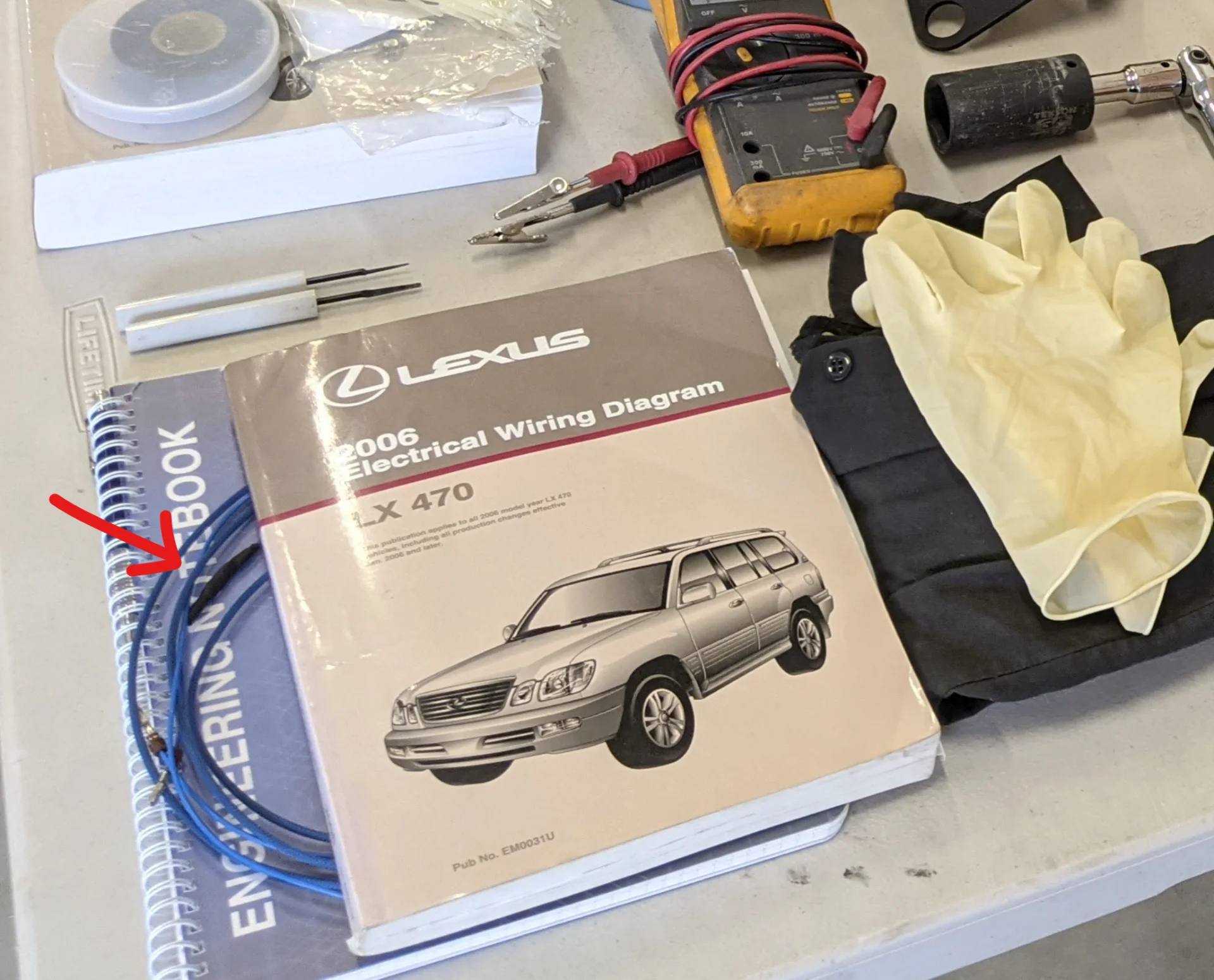

@02LXLC made it back into the shop today for the final fix. Short story: AHC IS BACK!
Detail:
We ran a new wire for the SLB signal for both the control valve and the height accumulator. The new wire is properly integrated into the OEM connectors using new sealed 090III terminals and tefzel insulated wire - naturally in the correct blue color. Zero cutting/splicing into OEM wire. I also had some expandable sheath in blue that I was able to use to cover most the wire as well. The wire was run along a similar path as the OEM harness for that section of wire and ziptied into place. The wire includes a butt splice where it branches off to the two devices and a waterproof splice with heat shrink was used.
Here's the only pic I ended up with of the wire. Too busy putting it to use to photograph it apparently.
All in all, the system just needed this one wire. That's it. Pump is good, shocks are good (though one is weeping a little too much), globes are good (albeit aged) and the system quickly changes heights as commanded. We adjusted one torsion bar three turns and that corrected a side to side lean and brought both front and back pressures into spec. Some future maintenance needed on the one shock and globe set, but nothing urgent for AHC right now.
Destail:
