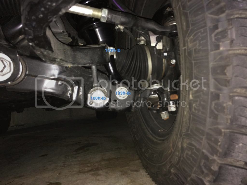

TIS tells me clearly that these bolts should be torqued with all four wheels on ground.

What is the torque value just for curiosity's sake?
This is a worthy thread as many quickly rush to install their new suspension and tighten everything up and then drop the truck and go for a ride.
I am disassembling and rebuilding my front Swaybar system this weekend with all new bushings and end links to try and eliminate a rattle that has been there since the truck was new. I will follow these torque specs.

The only thing I question is Bushings on the front Sway Bar End links are supposed to be Non Resuable. I don't know why but until we firure it out it would be best to remove the bold between the sway bar and the end link. Going to rebuild this weekend with all new parts.
