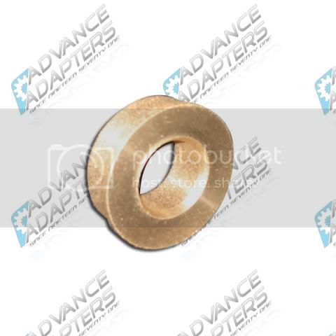

Thanks! I just called Kurt and got fixed up. Here's what I bought.
The firewall anchor and bronze bushing Downey Off Road used to offer are still available thru me as well.
