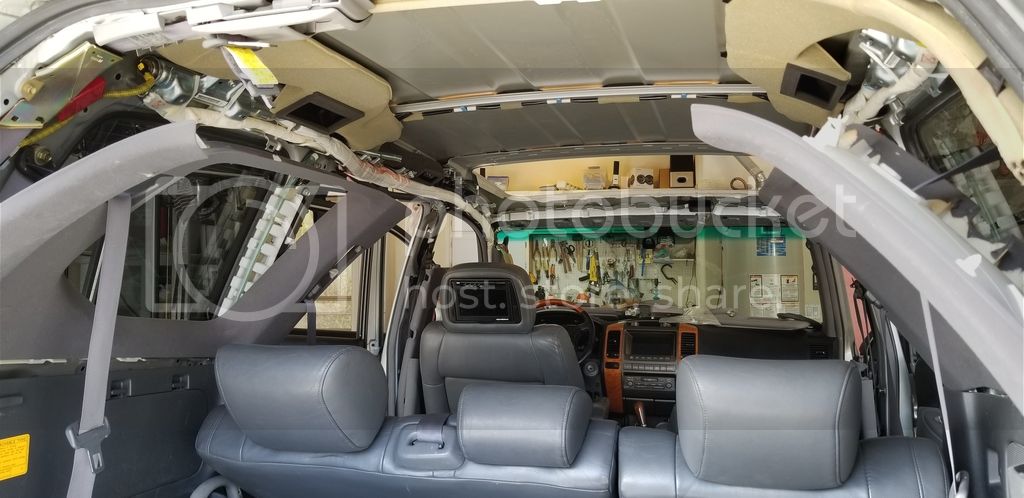

I took everything out. All sun visits, most "Oh S@#$ handles" overhead lights and sunglass holder, all mounts and clips from ceiling. Pried all A, B, and C pillar plastic open from the interior. That way the headliner (upside down tray) slides out the back. It does take some finagling, and patience and proper positioning of seats and interior trim peices to get it out without damage, be patient.

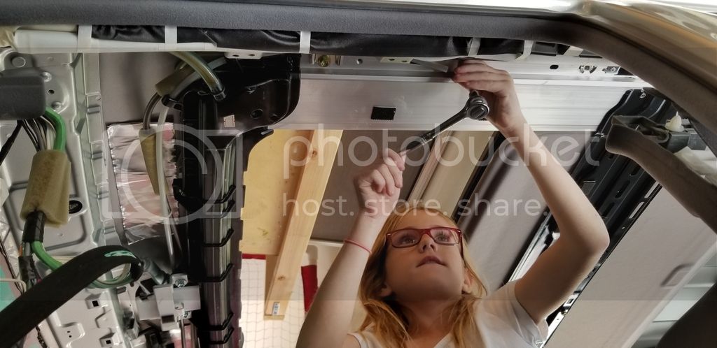

Once everything is cleaned out and lubed you then reverse assemble it I had my wife out helping balance the sunroof assembly as I bolted a lot of it together it would be pretty tricky to do it by yourself. And then you slide the headliner back in, being patient it's tricky, velcro everything back in place make sure all the wiring harness and cabling is installed properly and all the openings and then velcro everything back in place around the sunroof window opening there are other grommets that punch up through the ceiling to hold the back portion in place and then the sides of the headliner are held in place by the a b & c pillar trim. there are a lot of screws and bolts and brackets and little plastic things to keep track of I use Ziploc bags but if you were to start this project make sure you organize everything maybe a little better than I did, I was still able to find everything and put it back in but it's like reassembling a puzzle that's been thrown on the floor there's just a lot of parts and pieces to keep straight.

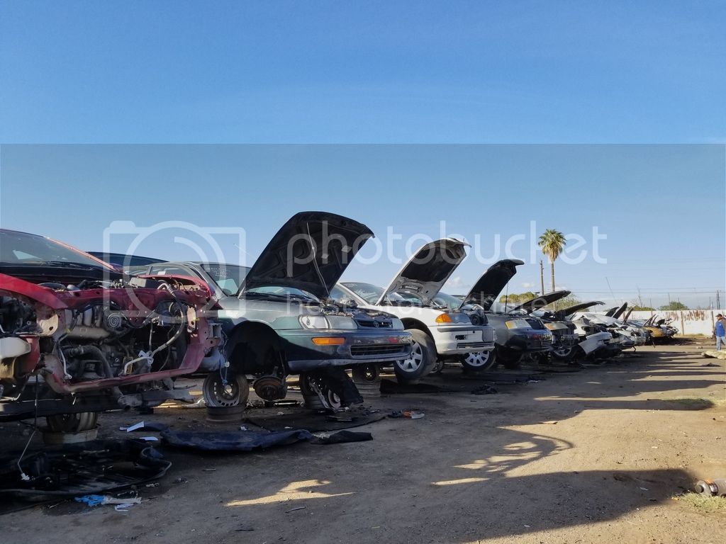

I wish that was the simple process that I had followed, but like a dingleberry I opened the sunroof motor to see if that's what the problem was before I found the twig. I would recommend not doing that because of the magnets and brushes inside are so strong that everything is thrown out of place when you open the motor and with the force of the magnets it's nearly impossible to get it reassemble properly again. This I found out later I had broken some of the motor contacts and the motor wouldn't work, I found this after I reassembled the sunroof track back in the car, and then I realized what I had done and realized what the pieces were that I had broken. That's when the feeling of desperation set in and I started searching for people parting out their cars on Craigslist I was looking for sequoias tacomas for runners and Lexus trucks. I ended up finding the part number and visited three different junk yards and was able to find the motor I needed in a Lexus ES330, but to make it work in the GX I had to swap the circuit boards. That all worked put everything back in place and now my wife can take kids to school again.

Here is the headliner out.
Had a good helper.

Part I found in junk yard
Beautiful day. "Hoods up America"
