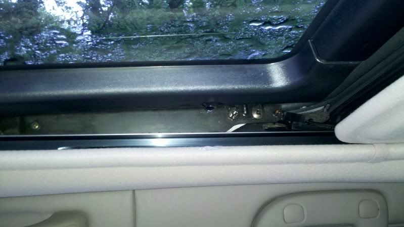

A few days ago I realized the sunroof was leaking on my newly aquired 2000 LX470. I cleaned the front sunroof drains with compressed air and checked to make sure all 4 were draining the way they should. I also made sure the sunroof operated correctly. Well, it didn't work. I got in this morning and noticed the passenger seat was wet. It's not soak, maybe 2 dozen drops. The weird thing is, this is where it is leaking from:
That is also the only place that it is leaking, not through a dome light or anything like that. Another issue that I'm having (that may or may not be related) is I have a wind whistle while driving. I also have an aftermarket windshield but it hasn't been dry enough for me to tape seams and see where the noise is coming from.
Any ideas you have would be great! My wife doesn't prefer to get dripped on...

I just don't get why it would leak from that black trim and not the tray.:confused:

I had a similar leak that originated at the rear of the sunroof and ran around the side like that before it dripped off into the passenger seat area. I was able to solve it (I think I found this solution on another sunroof leak thread) by removing the connectors from the ends of a flat phone cord and cutting a slit in one end of the rubber sunroof gasket and threading the the cord into the gasket. In my case this filled the gap at the gasket to frame interface enough to stop the leak.

Here’s what I’ve done to fix the leak. Peel the rubber gasket off and bend the plastic surrounding the glass back and forth. You’re listening for cracking sounds which is good. The plastic is very tough so you can use some force. It’s held with some brittle glue that cracks and leaks over time. The corners are the hardest part but I used a box cutter to slide between the glass and plastic. once it’s free just clean and use silicone then clamp until dry. You don’t need to add sealant to the rubber seal.
