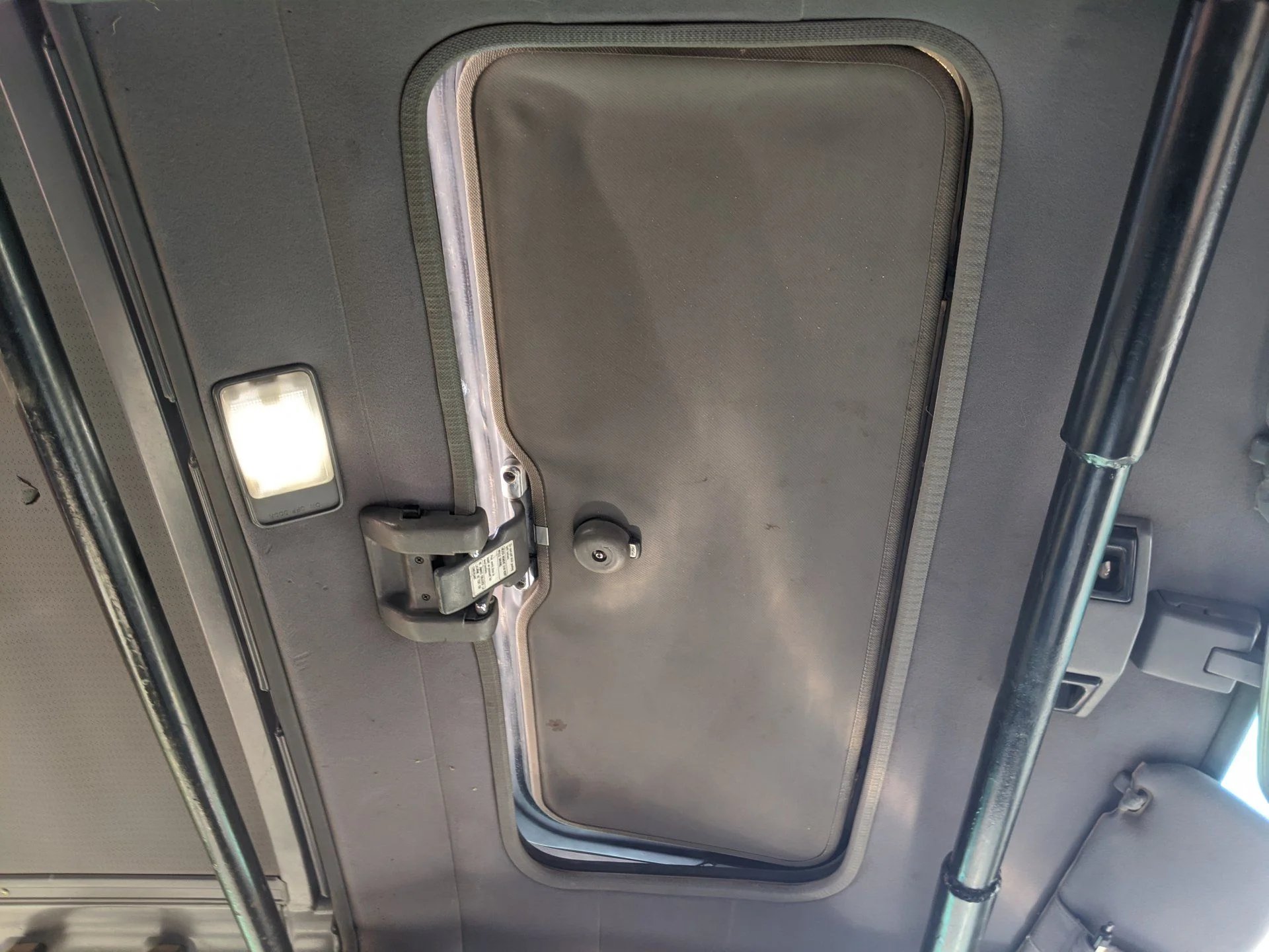

Ok turns out i had one of these on some parts i pilfered last outing. To my surprise this is a metal piece with a plastic bushing to capture the cover rod.
Also the fit is ridiculous and will not fly in this configuration.
But in the meantime. Vintage goodness.... In a rock truck. :flipoff2:

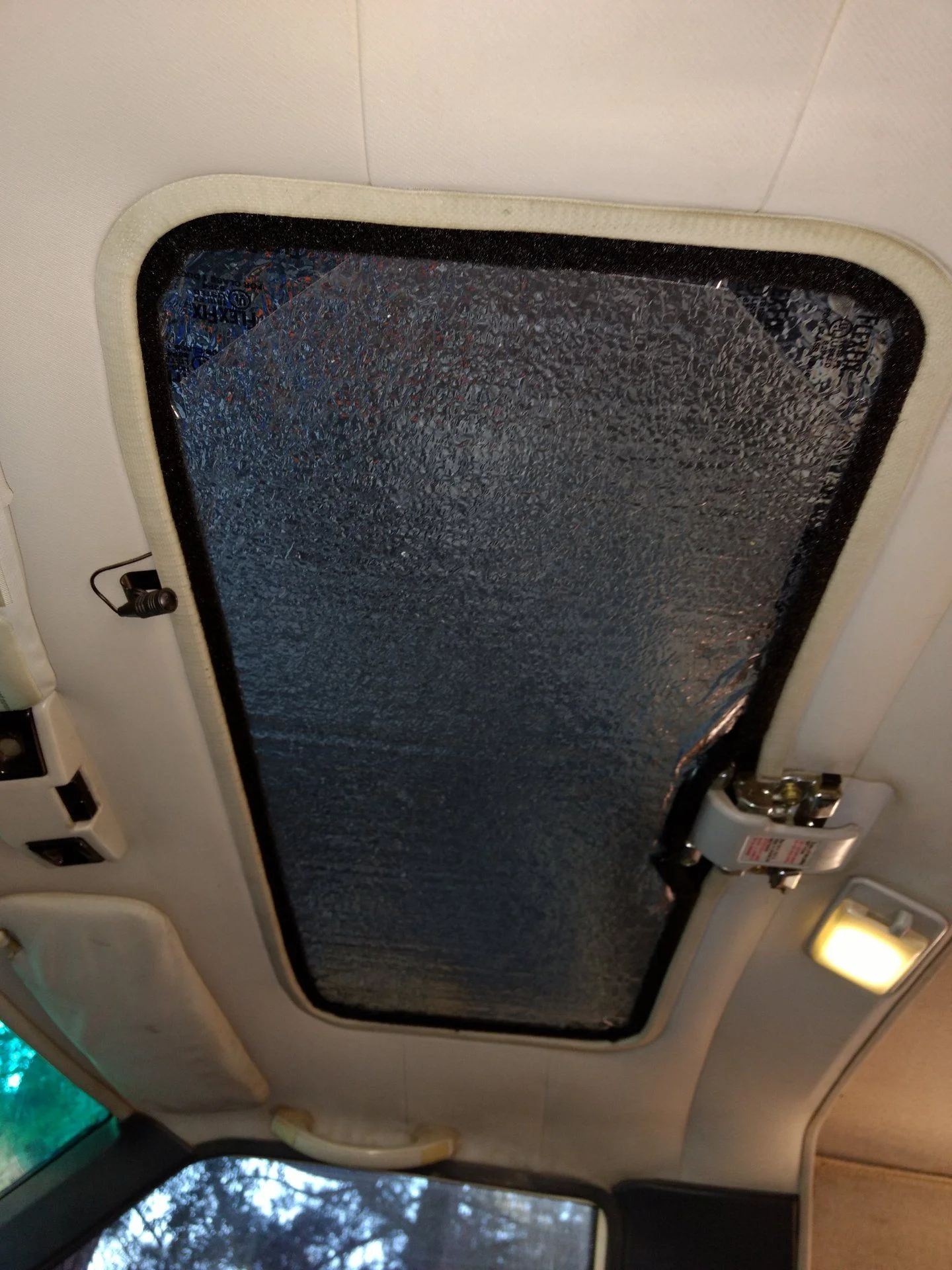

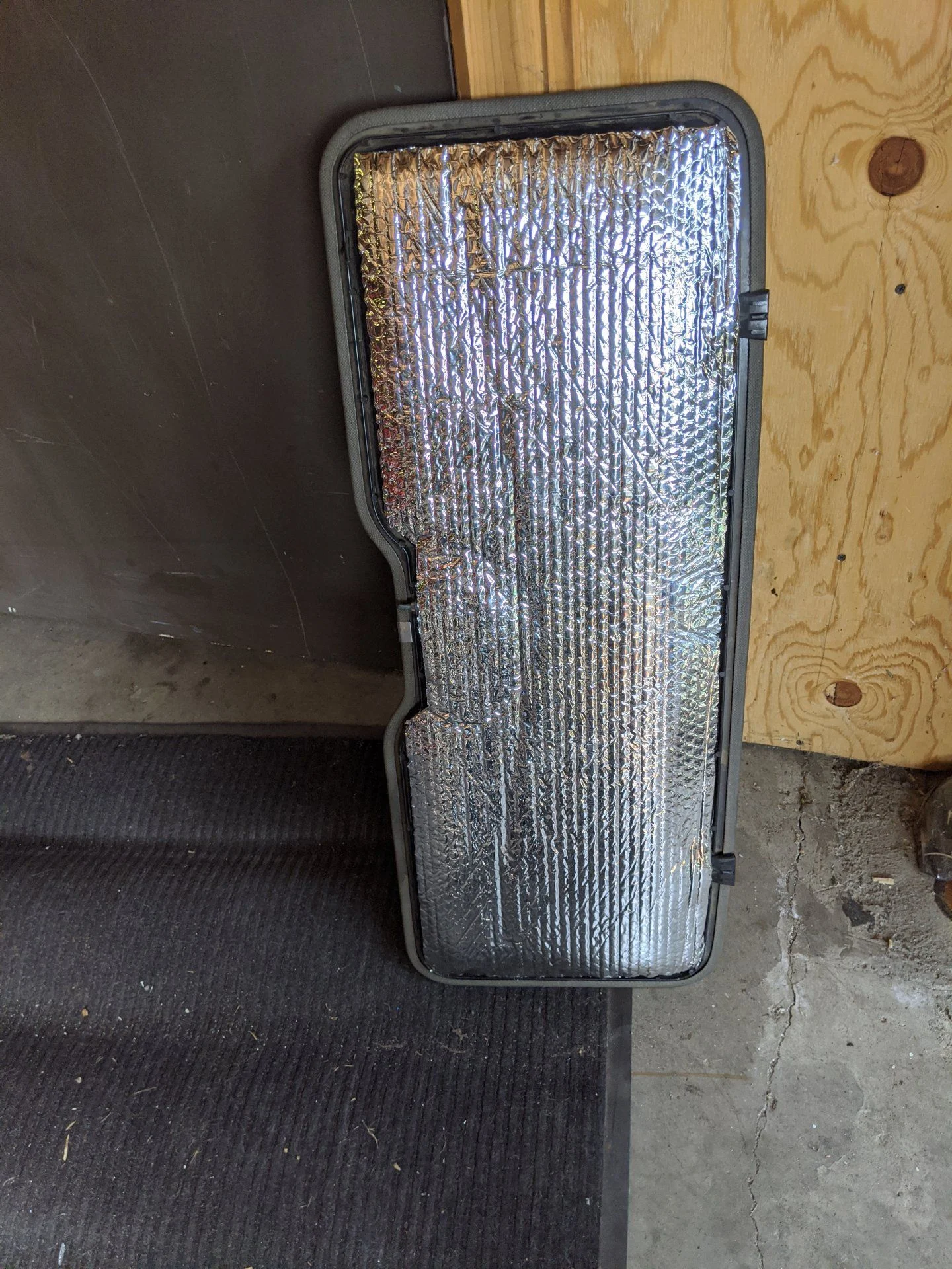

A little reflectex for heat and anti rattle.
we think alike. I recently removed the plastic piece and traced it on some decent quality 1 or 1 1/2(don't remember) inch foam to keep the heat out. I put the soft side of a velcro strip around the perimeter edges to keep the noise down. just did this about a month ago
