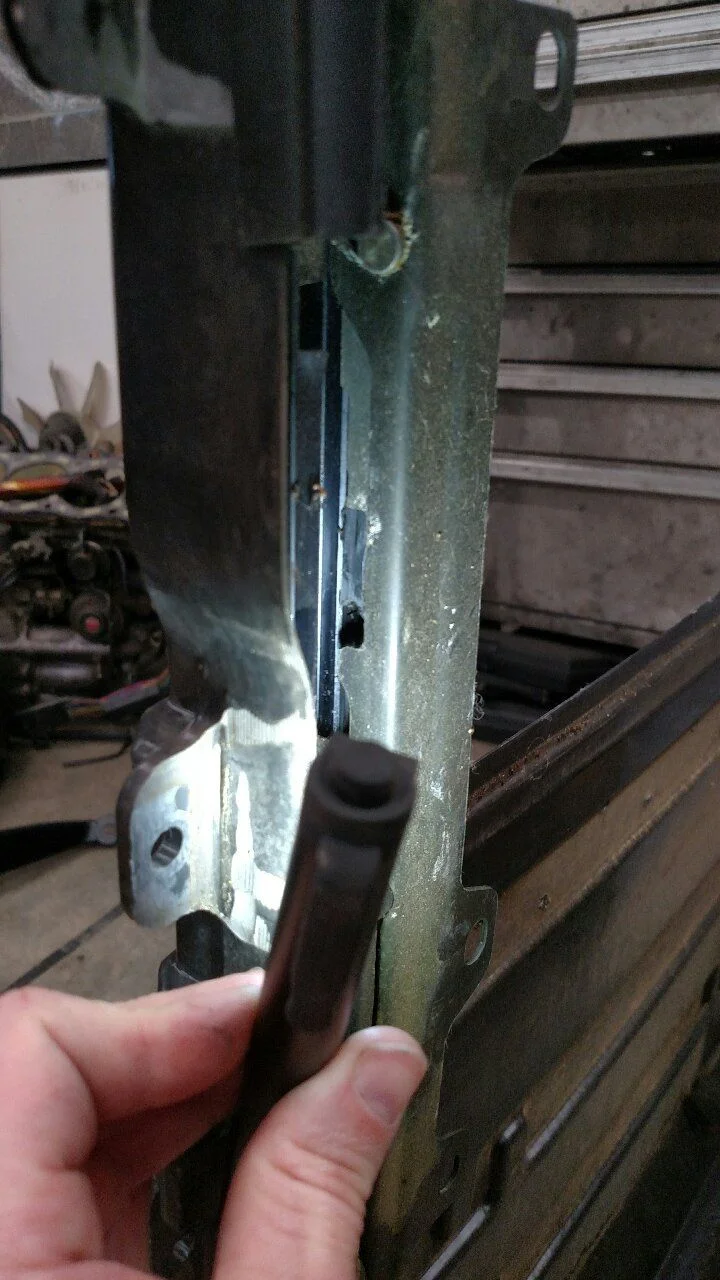

The cables are actually a coiled wire that gear teeth on the motor assembly engage with. They have a molded-on plastic end that looks like a block with a hole through it that attaches to a pin on the glass assembly. In my case, the block broke in half at the hole (on both sides/cables). This will let the broken side push the roof slightly in the rear direction, but wouldn't allow it to pull the roof closed. If you push the roof all the way against the broken part, and then follow the good/unbroken side by hand while pushing the button it should close. I had trouble getting mine to cam back into the up/sealed position, but my tracks had all kinds of crap in them... If you decide to tear into it, you have to pull the glass to get at the working parts of the track, and the plastic parts that hide the bolts for the glass are notoriously brittle. Try your best not to break them when you pull them off. In my case this was impossible, and once I had the pieces out I could literally crumble them in my hands.
anybody has any pics of the inside of that thing by any chance? TIA
thanks for the pics! This is not making me look forward to fixing that thing... The notion of using a BFH and then welding in some sheet metal seems more appealing by the day.... m.u.s.t.r.e.s.i.s.t........
