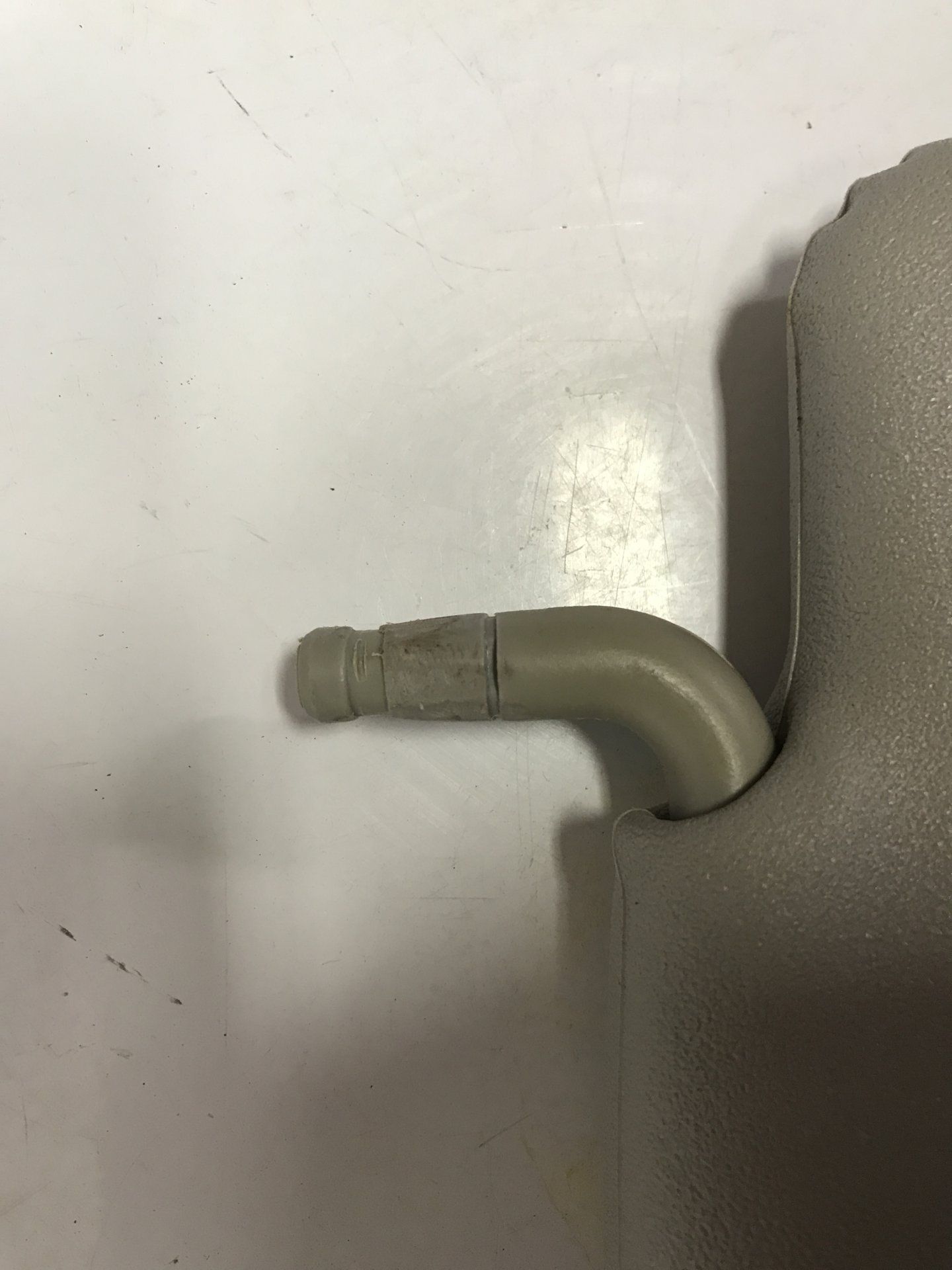

Hey I couldn't find the dual New Yorker visors in tan, so I ordered the single ones... Unfortunately the singles are made just a bit different and don't fit the 80. The issue has to do with how the visor rod attaches to the roof. The duals hang down just enough but the singles are so snug the scrape on the roof liner.

The singles are different as the rod that connects to the roof isn't a 90 but is more of an partial S shape. It looks like the duals are at a 90 which makes them a better match. I did see a set of duals on ebay but they were grey and I'm looking for TAN.

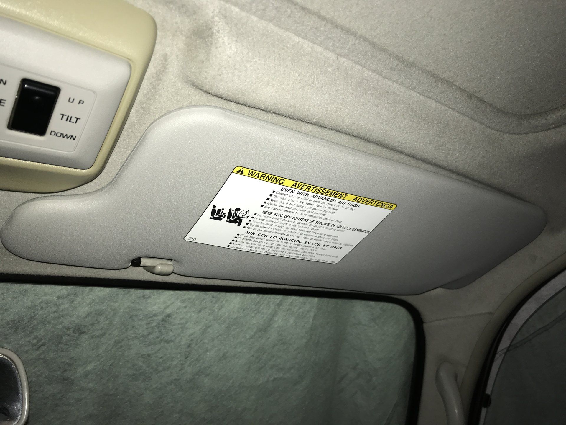

I picked up 2 Pair of dual visors from 2 1994 New Yorkers. I bought one to install and an extra just in case or to sell.
They were gray and I have tan interior, however I really don't notice they are gray. I must say it is very nice to not have droopy broken visors in my face and I love that they are dual visors too!
The install went very easy with two exceptions...
1. I got in a bit of a hurry should have thought it out a bit. When using the factory screw to tap the newly drilled hole, I used a power drill and when the screw caught it went in too fast and smashed one of the mounts... :bang: Good thing I had a back up.
2. For some reason the drivers side visor, very slightly, scrapes the top of the liner and the passenger side does not. What I noticed was the visor was unhooked the PS side drops just a bit, but the DS side actually raised up a bit. Simple fix is -- This is very minor and I just have to remember to hold it down just a bit.

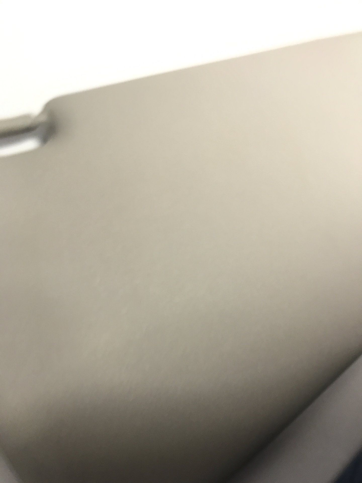

One last item... Chrysler appears to use two types of material to make these visors. One material is very flat and the other appears to be a bit more fuzzy. When looking at junk yards I noticed the flat material was more prone to tears and holes and the fuzzy material appeared to hold up better. I actually got one of each and I noticed the flat material doesn't seem to clean up as well. If you have the choice I'd choose the fuzzy material as it appears to be more durable.
I just scored a set of 94 New Yorker duals in Grey with the velour (flat) fabric. How did you clean the velour? It's delicate and I don't want to booger it up. Did you have to mess with the electrical connector or does it plug up to the Toyota connector? I'm really excited to get these in as my drivers side finally went limp on me last week.

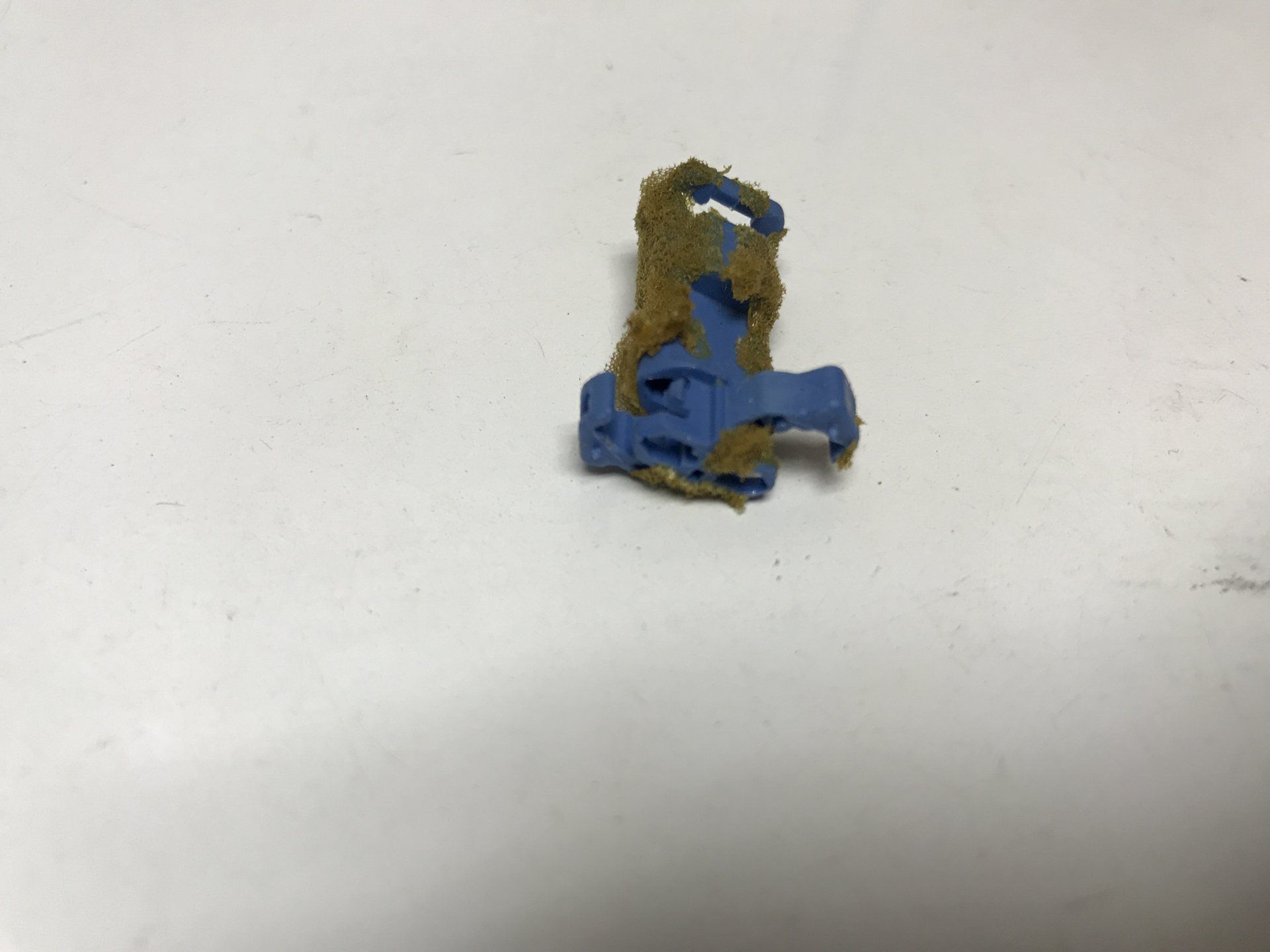

1) remove stock visors
2) remove foam around electrical plug and disconnect plug. Tape up vehicle side as FJ ha no power.
3) the plug has quick removable tabs for the wires. Remove the plug from the visor side.
4) heat up the mount side plastic tabs and pry open. Pull the old visor out of mount.
5) on the FJC visor, remove the c clip from the shaft and pull from mount.
6) below the slot for the c clip, sand/grind the shaft in a tapper to an inch or so.
7) push the new visor into the LC mount far enough you can put the c clip back on.
8) sand/grind the retainer dowl down a few mm to fit into smaller LC diam clip.
9) move the dowl as far toward the mount/shaft size as you can, and use a zip tie to keep it there... (the LC retainer dowl is further outboard than the FJC by just a tad. You can also have the LC retainer clip down to make it fit better.
