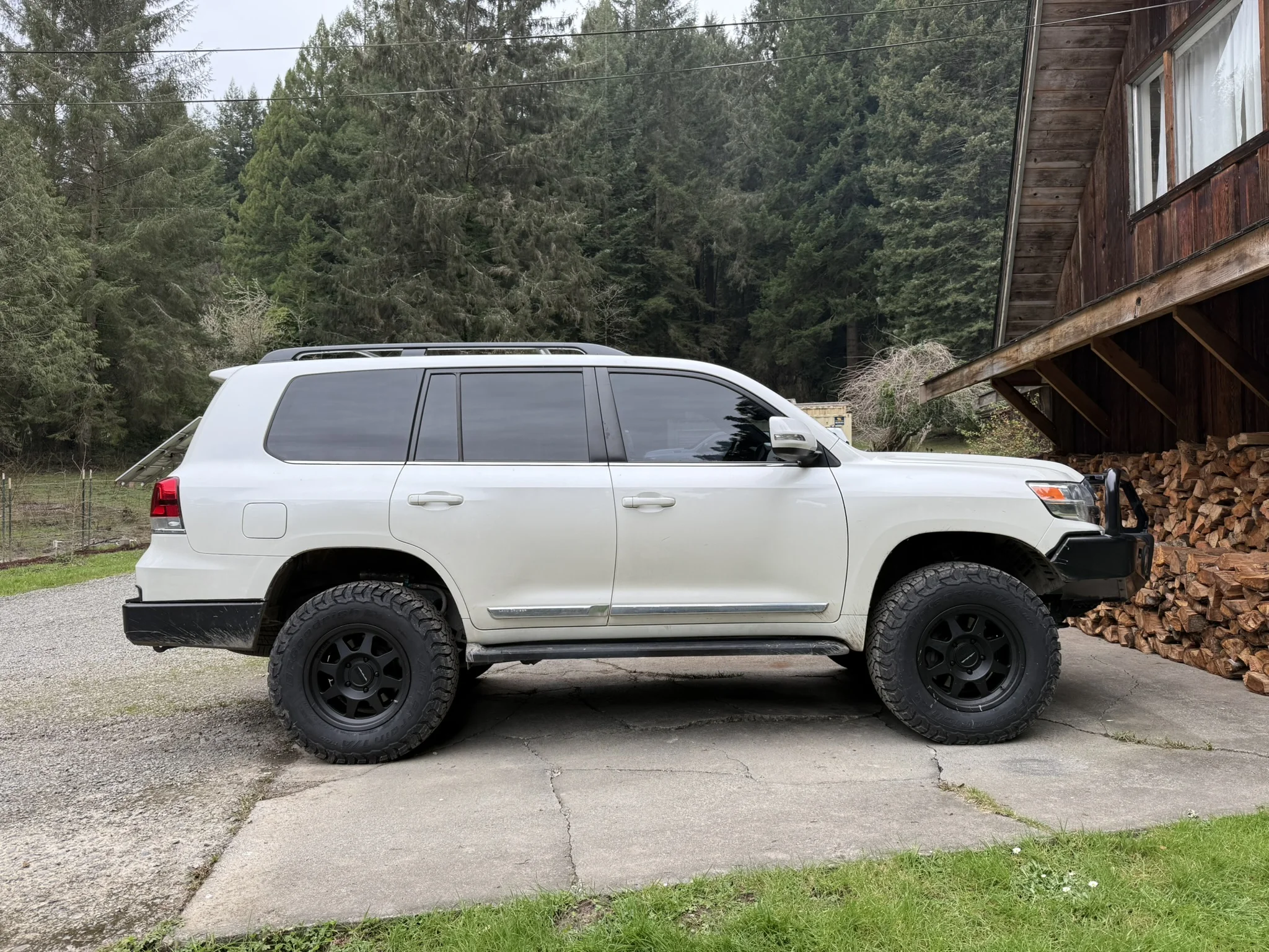

Thank you kindly for the response and the side pics. Very helpfulPeople say lots of things.
Best I've got for ya, sadly the truck belongs to someone else now.

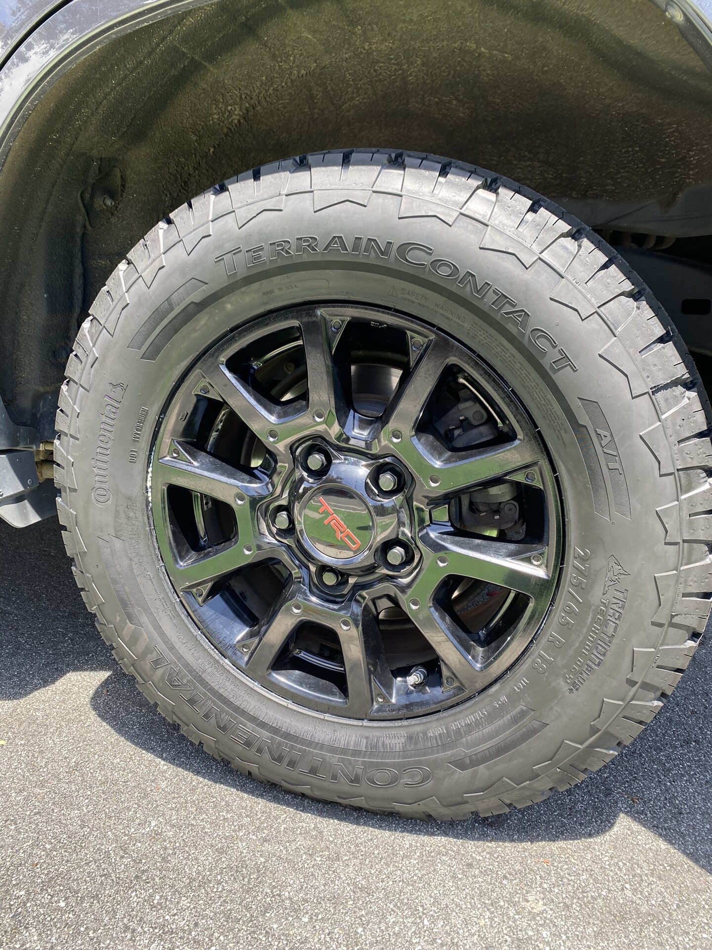

looks grreatI painted the OEM to black glossy, matching my body paint, and have loved it for the past years.

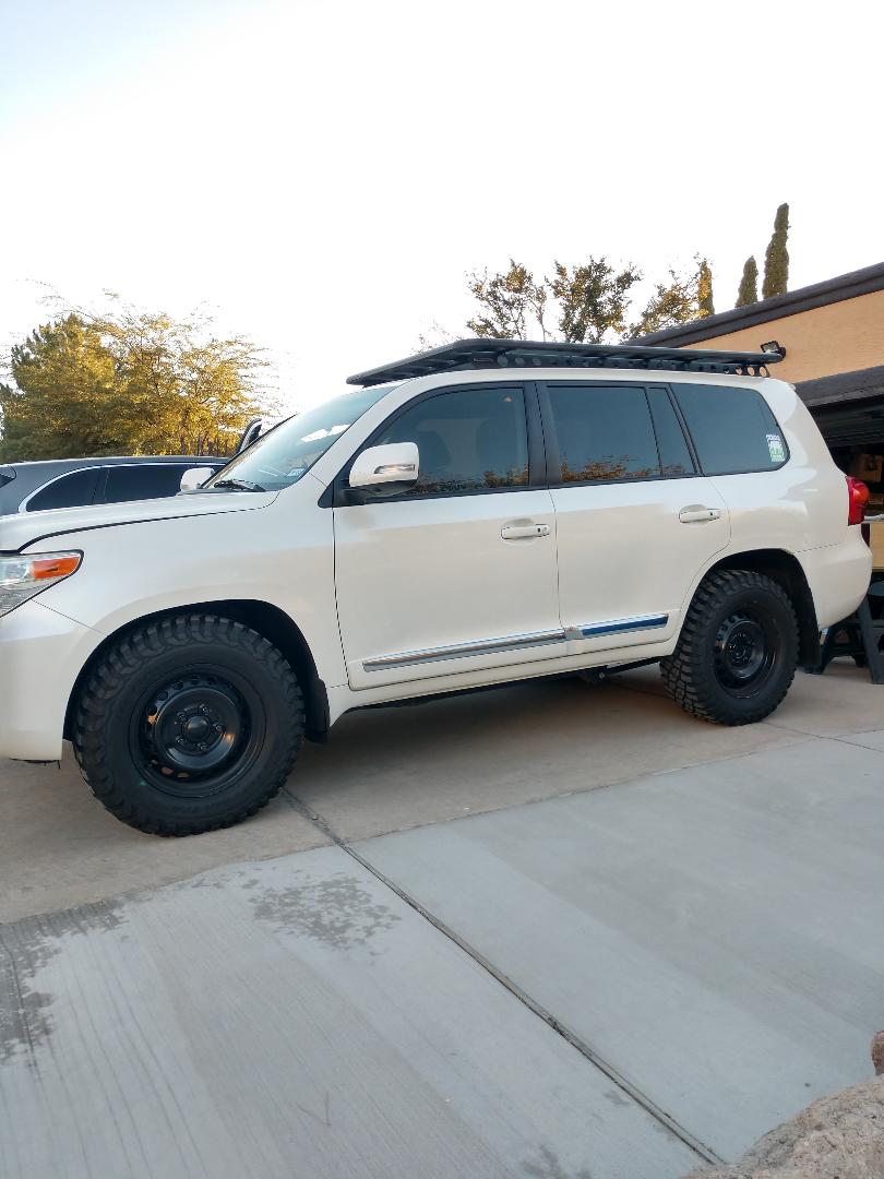

arent steelies heavier?I really like my Steelies. Much cheaper than alloys and a couple of pounds lighter each than the stock wheels.
Not when I checked the weights. Steelies are field reparable if the bead gets bent.arent steelies heavier?
thank youNot when I checked the weights. Steelies are field reparable if the bead gets bent.

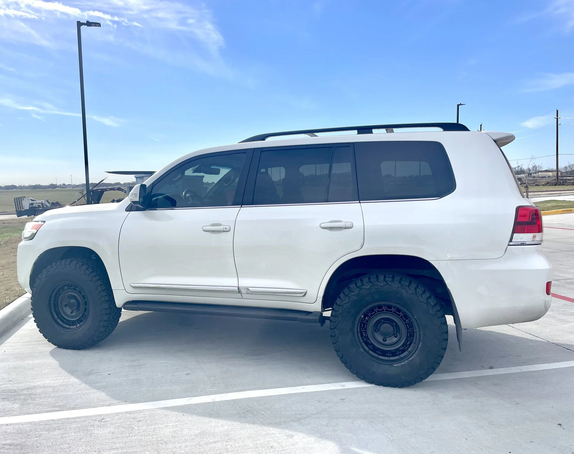

Nice. What size tires ?Method 701 18x9 +25 offset. I've tried a number of different wheels and these are my favorite so far.
285/70R18. I think i could fit 295/70R18 but bigger than that I would need to relocated the KDSS.Nice. What size tires ?
I know the truck is long gone but I'm very interested in exactly the same wheels. Did you have any particular issues that you can remember? Doesn't seem to be common for people to run 0 offset wheels285/75/17 KO2’s on Nomad Arvo 502’s 17x8.5 0mm offset. She's long gone, continuing to get built by her new owner up in the DFW area.
