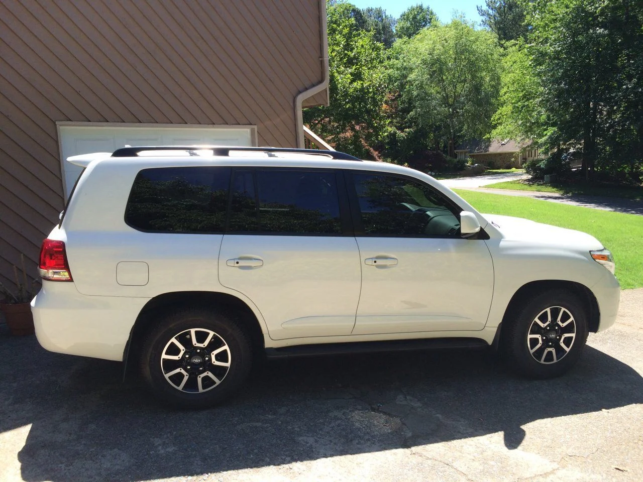

Look at my build thread in my signature. I purchased aluminum Tundra wheels and powder coated them black and then bought TRD Pro caps and they look exactly like the expensive TRD Pro Black Rims

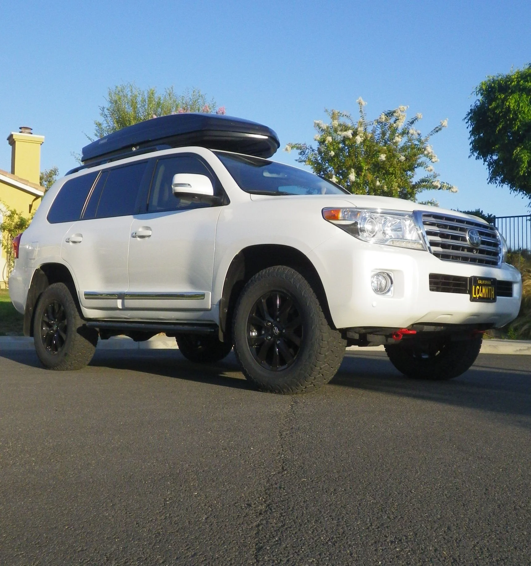

Here are my black TRD wheels... They are from a 2016 Tundra TRD...

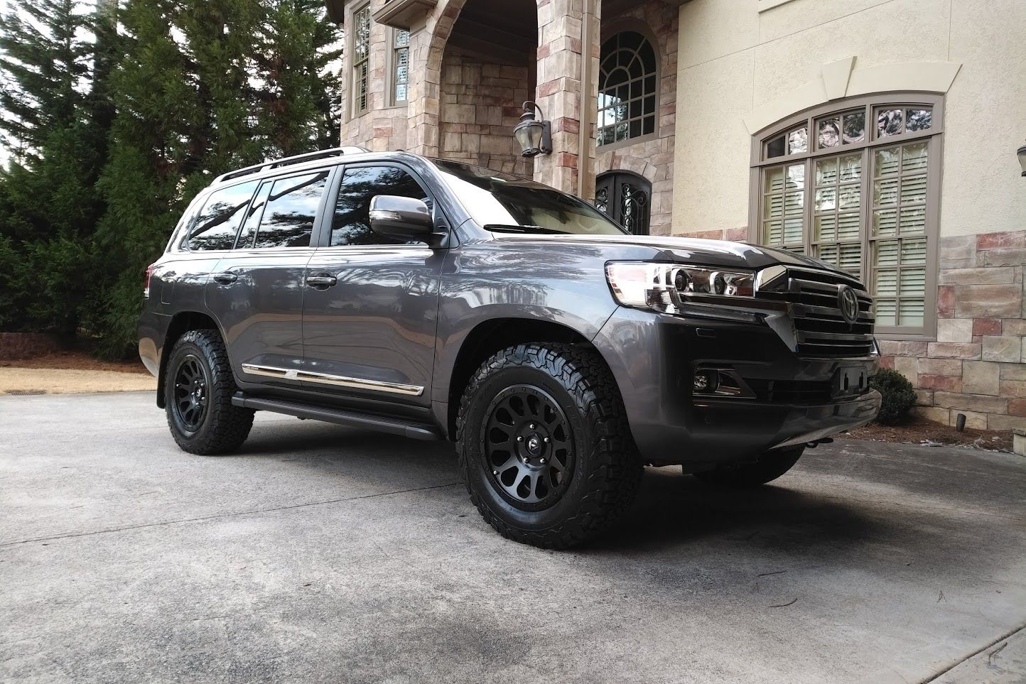

Here is mine with black rims.

I am running a +20 offset black Fuel trophy wheel stock size 285/60/18 tires on my 11 Cruiser, I order them again for 18 Cruiser and had them on my 17 Tundra that I traded for my 18 Cruiser.
I really love the look of that 18x9 +20 Trophy rim, but they do require a wheel flair if you don't want any poke.
They also typically will create a slight rub in full lock revers maneuvers with stock size tires.
Fuel Trophy wheels DD551 ? 20MM OFFSET 18X9
I think an 18x9 with a +30 or +35 would be the ideal offset for stance and likely no rub issues, but I have never found a rim I liked with that offset. Most aftermarket 18x9s have that same +20 offset that the wheels I have been buying have.

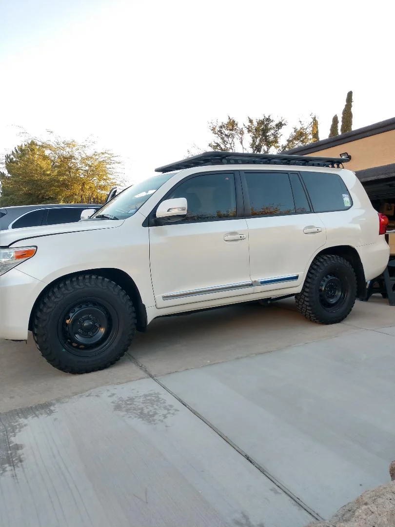

I really like my Steelies. Much cheaper than alloys and a couple of pounds lighter each than the stock wheels.

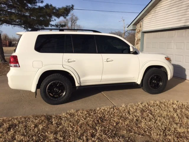

Are you riding on stock suspension? Do you happen to know the model of wheel amd offset? Thanks in advance!
No lift, completely stock in this picture.
wheels Fuel Vectors 18X9 5x150 20 mm offset
tires 285/65/18 BFG KO2's
minimal rub cured with a heat gun to one small spot on the plastic fender liners to push them out a bit. Its a great simple set up that changes the whole look of the truck.

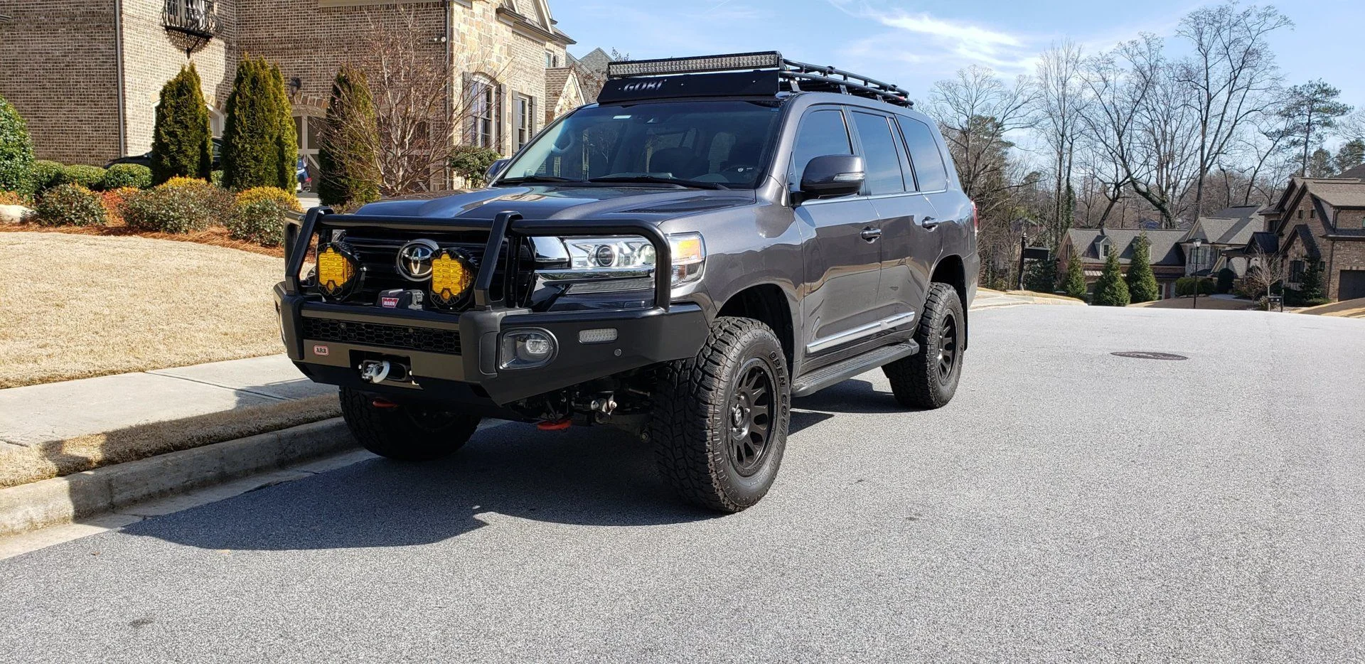

That picture was from 2 years ago, now looks like this. Same wheels :)

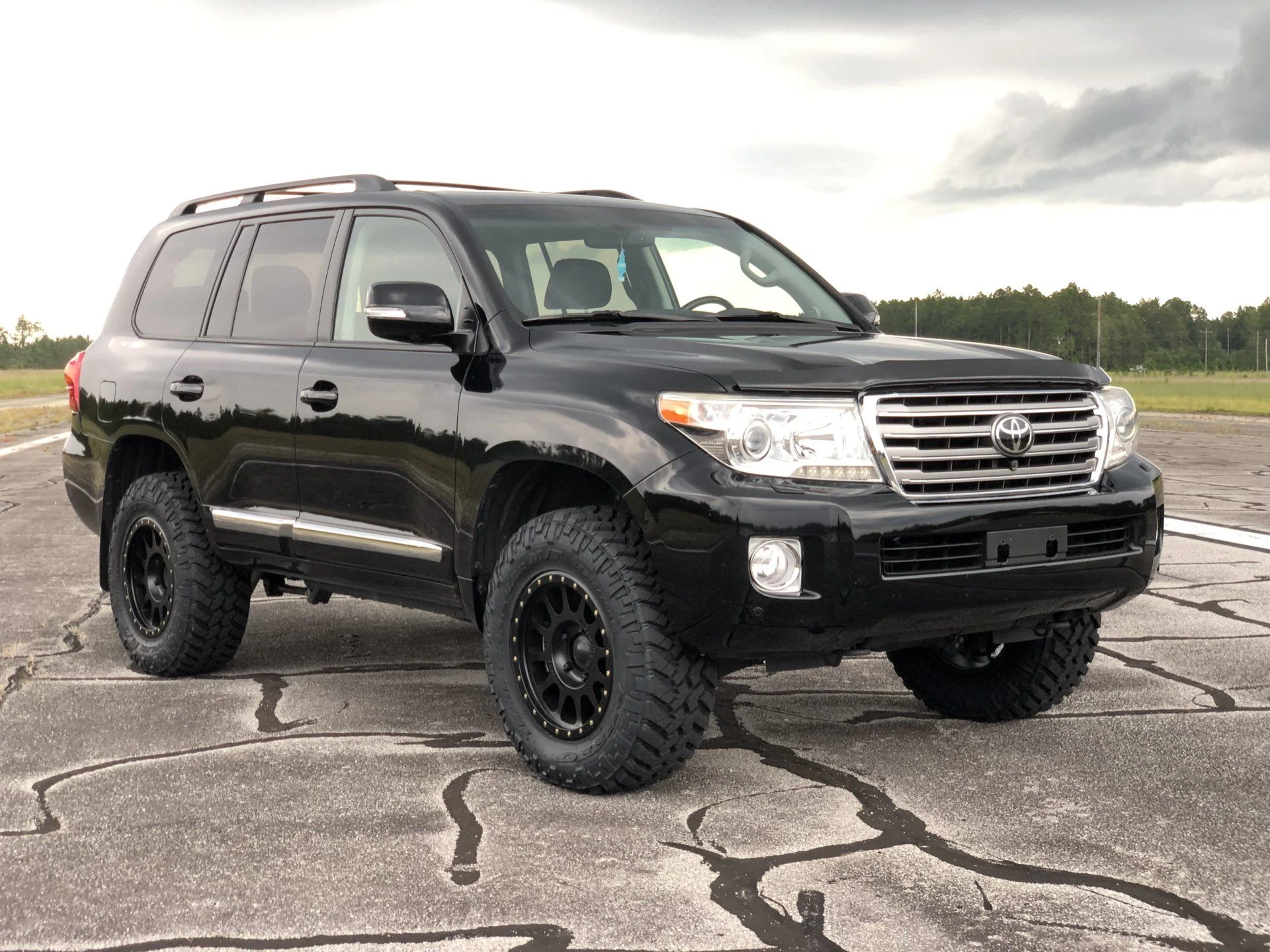

18” Method NV +25
