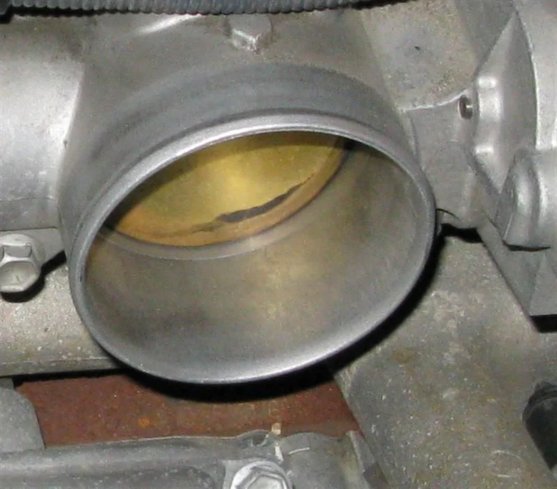

Cleaned throttle body two years ago when I replaced starter contacts. Will clean TB today again, but doubt it can be gummed up already.

Thanks, will order a TPS from CDan. Sounds like the most obvious route, considering the Throttle body was almost "squeeky clean" (see picture).
