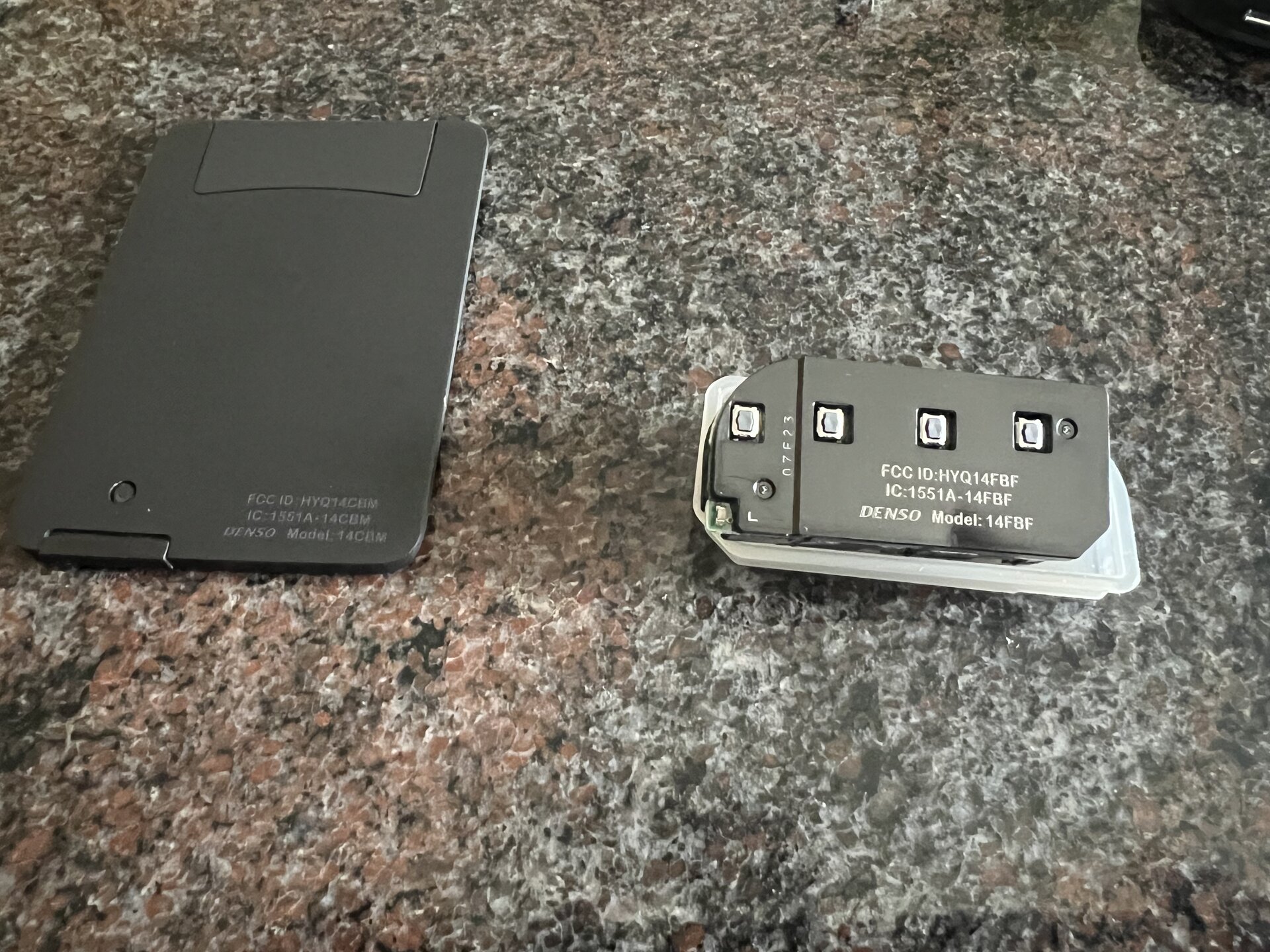

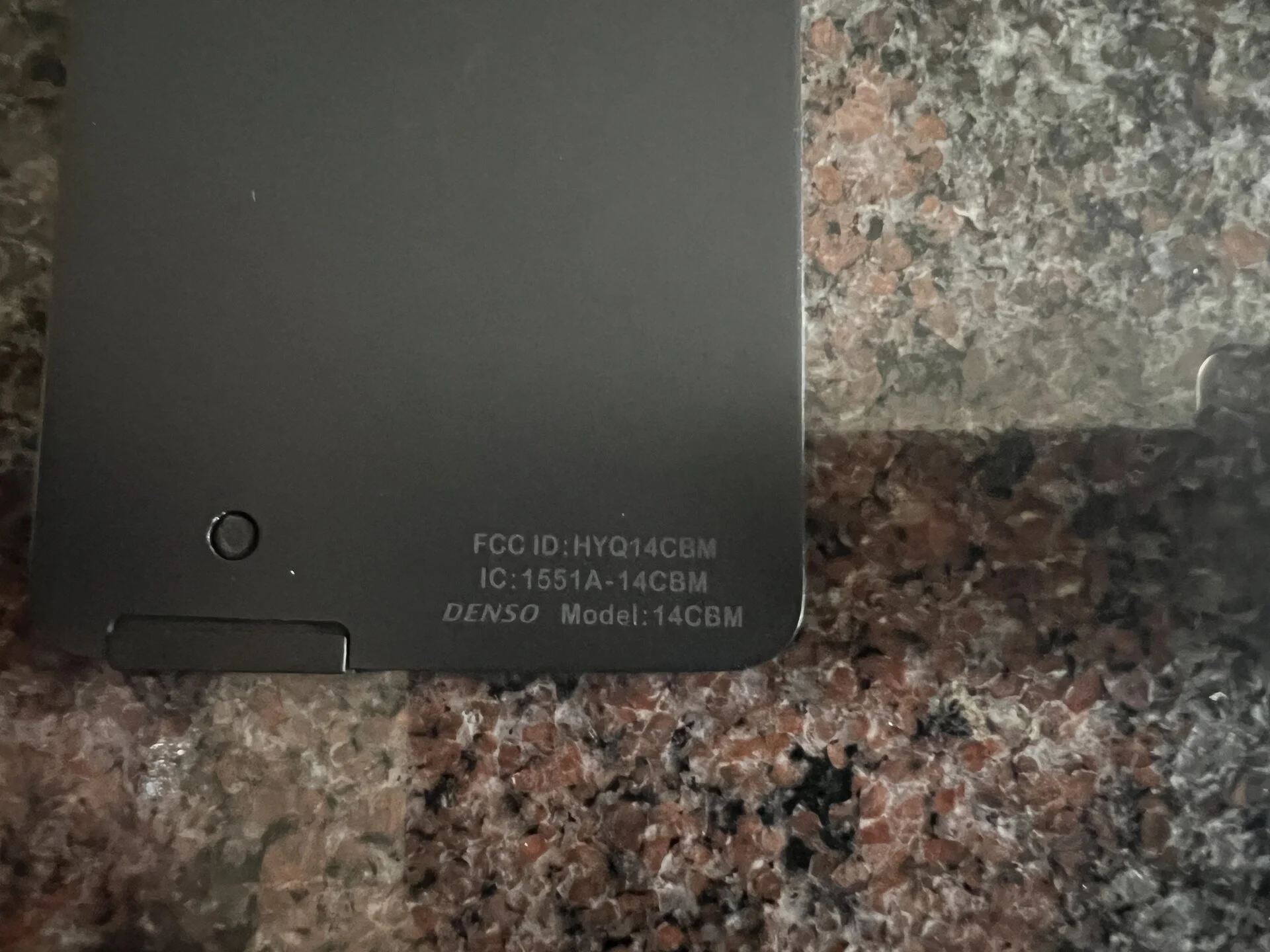

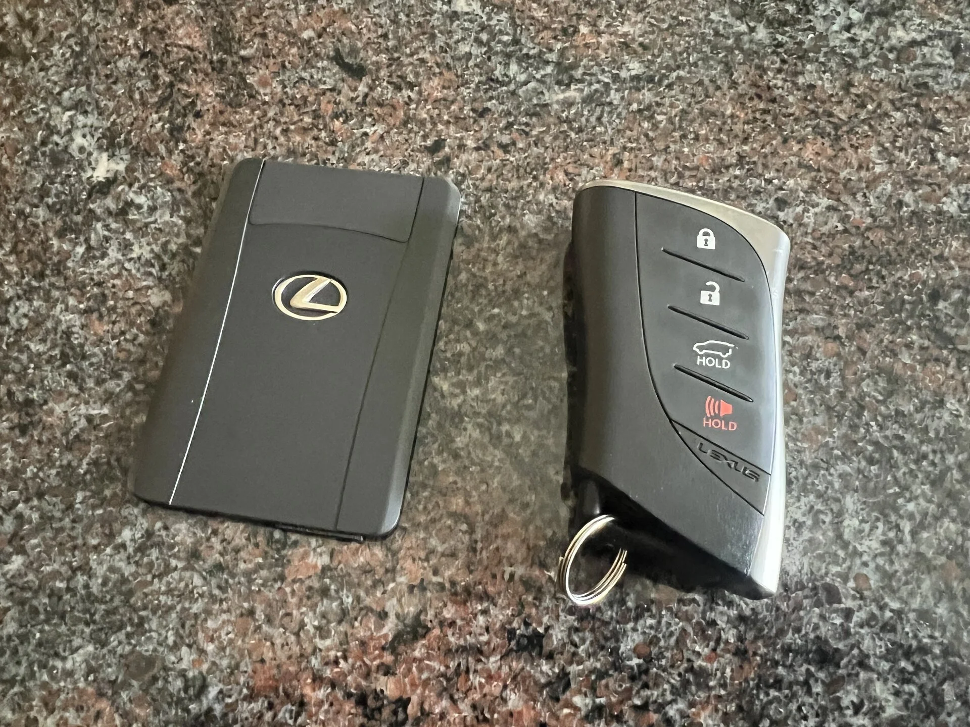

I hope this will help somebody out. I just figured out programming a card key to my 2021 GX. I wasn't able to find any info on the card keys for the 2020+ GXs anywhere online, so I did some research and got it working.
My original 2021 key fob has an FCC ID of HYQ14FBF and the card key that I was able to program is HYQ14CBM. According to what I could find, it’s part number 89904-48X70 and the card key for the LS and LC. I got it off eBay for $200 with an uncut key blade. The seller is virginkeys and the ad states it’s an OEM key blade, but I think it’s aftermarket. Sometimes the dealers aren’t able to cut the aftermarket blades because their machines reject them. You might need to buy an original key blade (p/n 69515-30350) from the dealer for ~$40-$45 if that’s the case with the blade you receive.
Not sure which years of the GX have the HYQ14FBF key, but hope this will save someone the headache of figuring it out on their own.
Here’s some photos of my key fob and card key.

On my 2021 Luxury I have lock/unlock sensors on both the front driver and passenger doors, as well as the buttons on the rear door. All of those recognize the card key. It also lets me start the car as well. Just got the blade cut and I can lock/unlock the glove box now as well. Basically I can use it the same as the key fob, just without the physical buttons.
